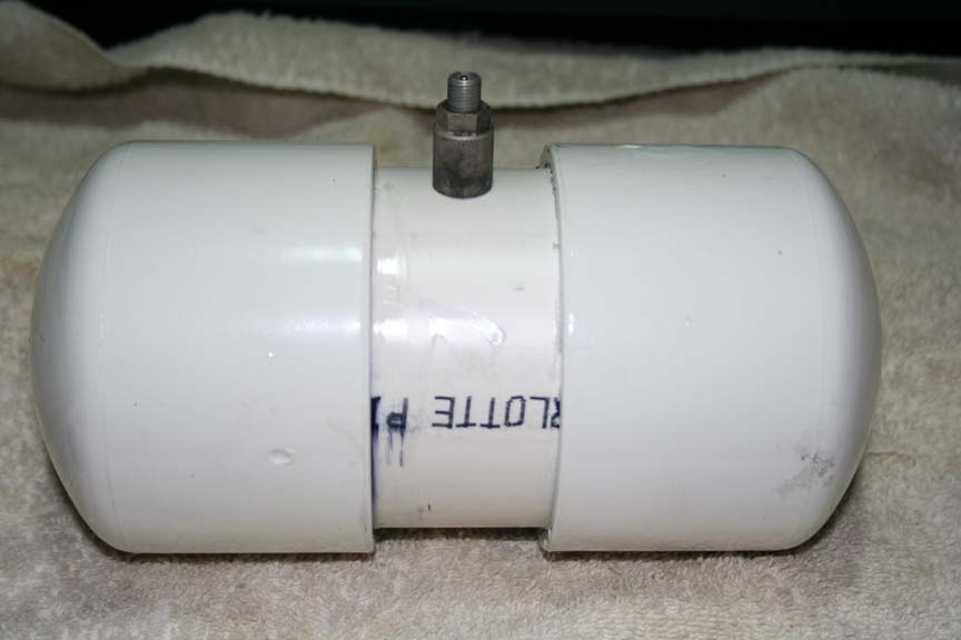

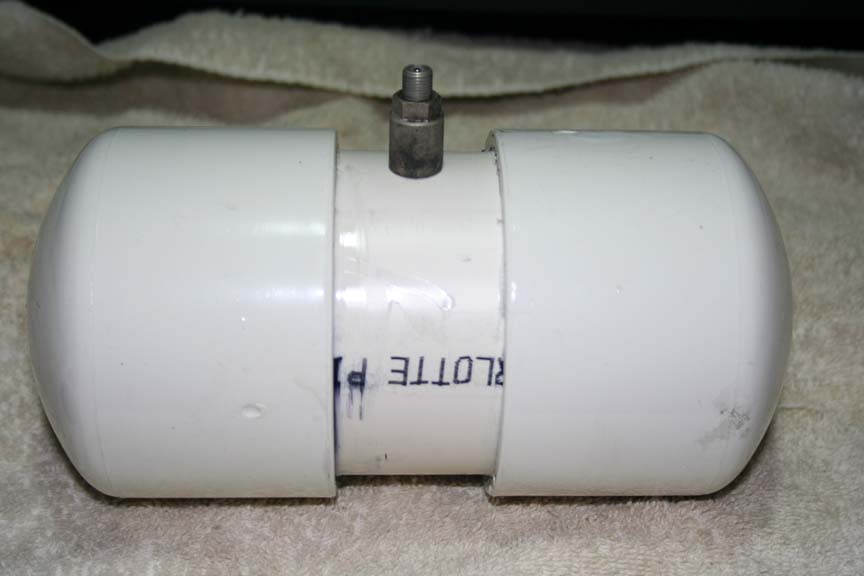

one of the "cheaper" methods was to make a chamber of PVC pipe and install the sensors in that and keep it inflated to 28psi or what ever the low threshold of the sensors is.
