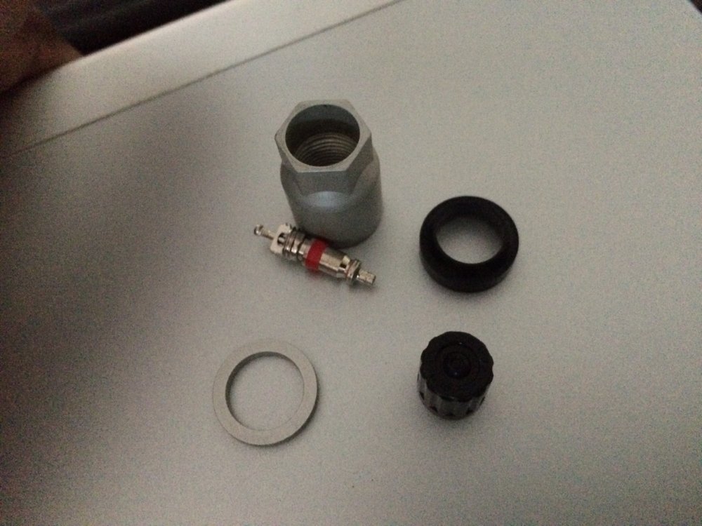

And the cause of the light is in fact the TPMS sensor seal.
Soaped the stems and sure enough the seal(s) are apparently aged enough they need attention.

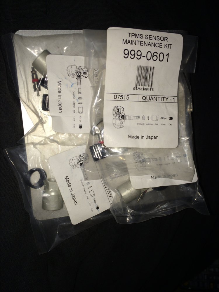

Priced at a tire store ( discount tire as they show the pricing ) $8 per wheel
$2.13 each. Not the cheapest, nor the most expensive. Rock Auto
Keep it in mind when you're doing tires on equipped vehicles. ( look up for your vehicle, some are different )
We are actually selling TPMS service kits for sensors like those with tires now as an option. Seen several sensors leaking at the seals lately, I guess they are just getting brittle.
