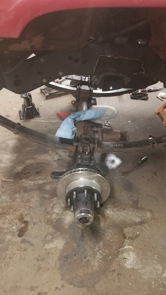

Ahh i see gotta use my imagination :). And thank you! It was a challenge.. obviously by my questions, but really fun none the less! Just a few odds and ends to wrap up..Well besides this stuff
Just for laugh, that is how much they compressed and they are rated for a diesel weight...

What are the springs meant for? You could always call up somebody like Alcan and have a set of springs made.
If you ever noticed the front of a SD, the springs are pretty much flat with weight on them. If I were you, I'd see if I could pull some spring mount measurements off of an SD truck and try to mimic that.
Ford also had several different front springs they used and identified with different codes. I'm not sure which ones you have, but they look to be a pretty soft spring rate. You'd like need something in the mid to upper 400 lb/in range. Scroll down to post #8 in this link and it shows them all. The good thing is you can buy new springs pretty damn cheap, like 200 bucks a pair.

They are pro comp 4 inch lift springs for a super duty. So that is how i was basing my total lift from the truck 4 inch plus crossmember bracket mounting put me in the 6ish lift catagory

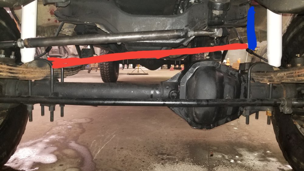

So i went and kinda half mocked a track bar point of travel..and it looks like if i welded a tab to the top of the shock mount, and a frame mount near the engine crossmember...im gonna have to cut the bottom half off the crossmember and basically make it flat and weld some plate to square it off to get the clearance i need...
Think the reasonable thing to do is, dial in my alignment, install the steering stabilizer i ordered...and take a drive and see where am at and see if one or anything is needed..
No sense in creating work if i MAY not need it right? Logical thinking yes no?
