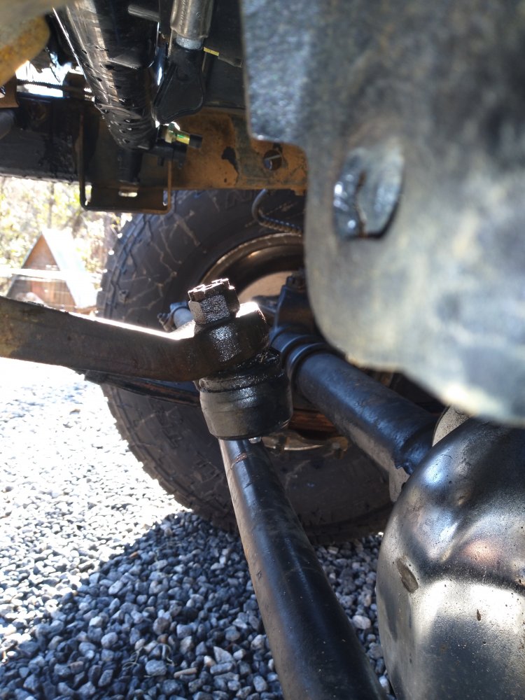

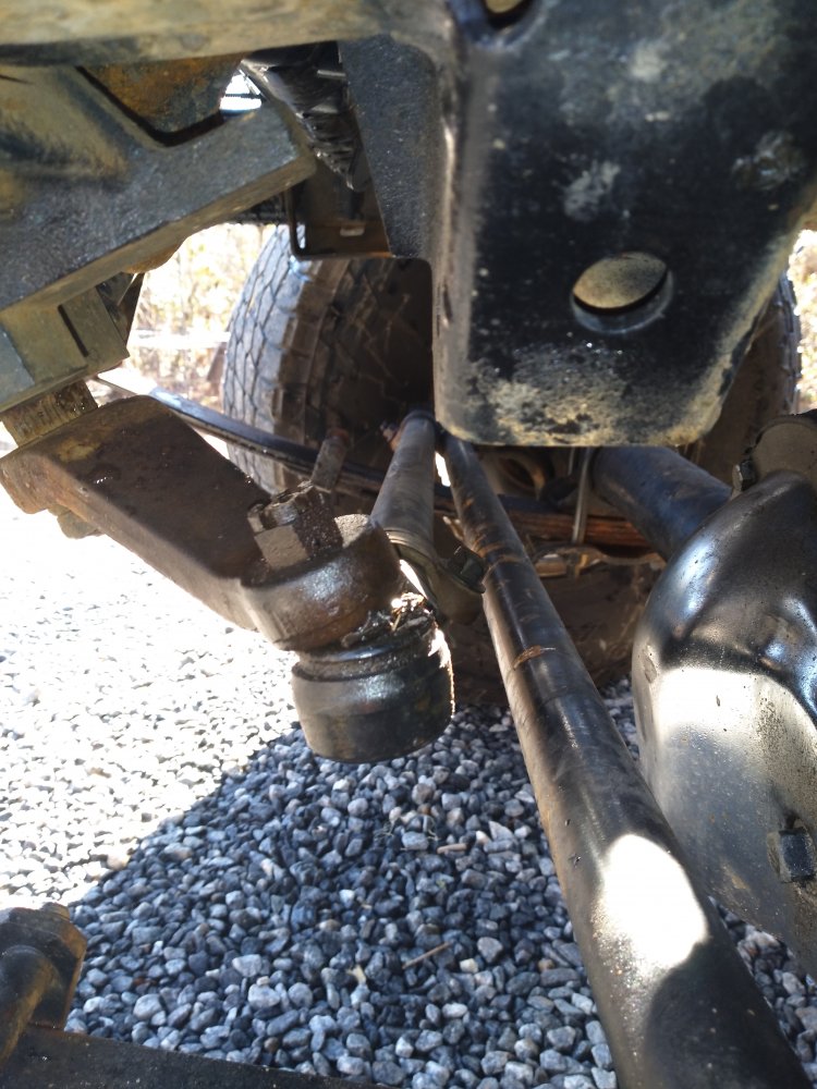

Ok, I installed the tre and I'm back to my investigation. Thanks for all the help getting me to this point. So far I've greased and checked torque on all shackles, frame mounts. None are binding and bushings have all been replaced. I've checked torque on all u-bolts. I've tightened steering box 1/4 turn. Any more than that and steering starts to bind in spots. Tightening steering box made the most noticeable improvement. I can drive around curves now and mostly control it....mostly. now I'm looking at geometry of steering components. Problem is I know nothing about geometry

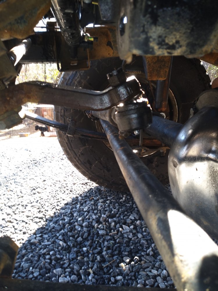

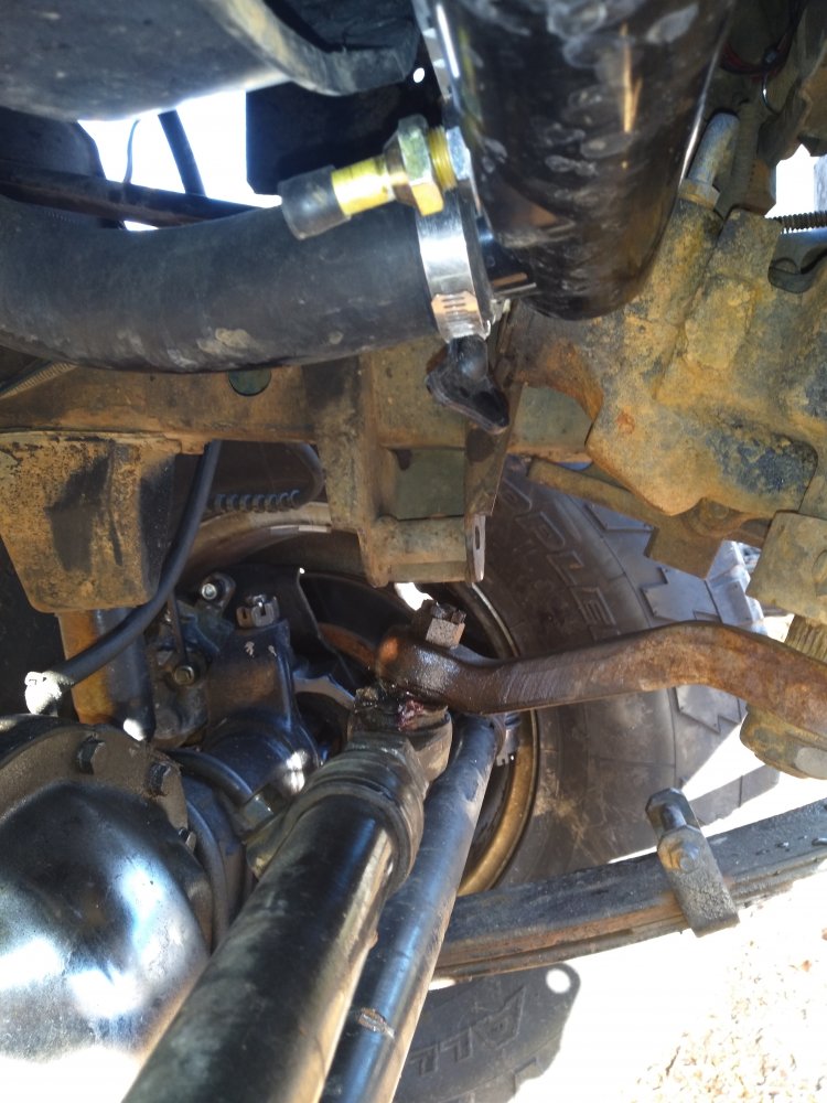

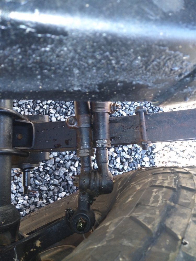

FIRST thing I've noticed is pitman and drag link connection looks like it's a little stressed at any steering direction. Can I just back off jamb nuts and rotate link a little more so it's more in sync with angle of pitman end?

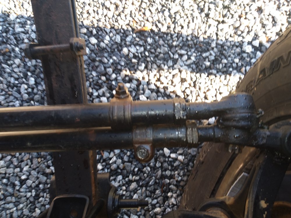

SECOND

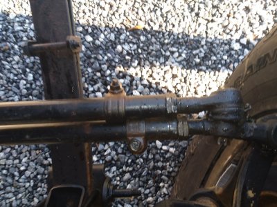

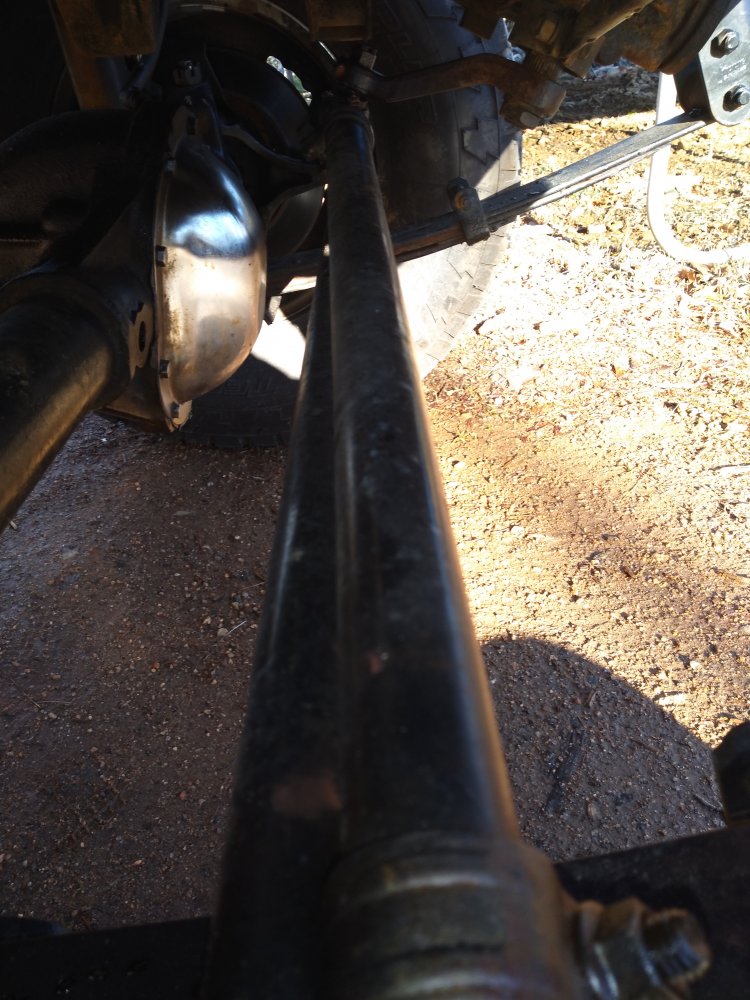

Tie rod is touching drag link slightly where they connect. Pinch collars? are just shy of touching when wheel is completely turned left. Is offset Tre causing this and would a straight one help situation?

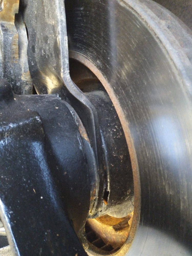

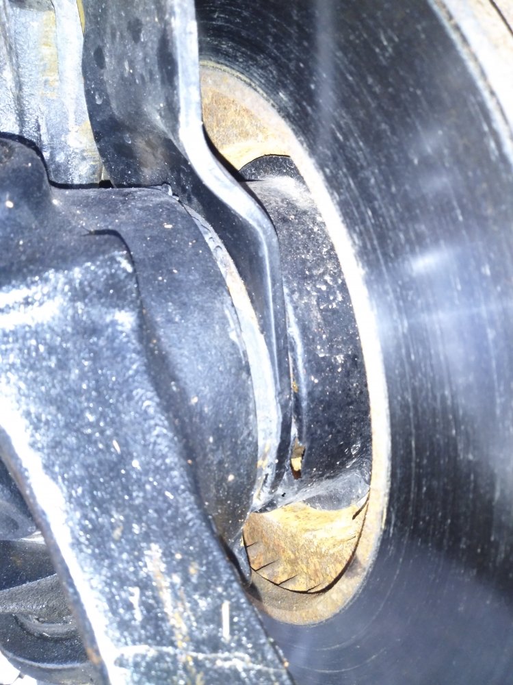

Wworking around front drivers wheel I noticed that some JB weld has been smeared into a crack in hub area. Next to that I see a hole in something. Sorry I'm still learning. Any idea what's going on with that?
