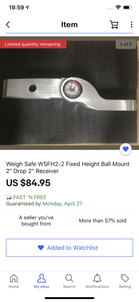

$85 and be done with it...

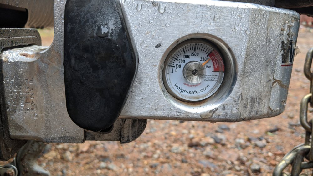

Dang, I wish the had that version when I bought mine. Here's an example of too much:
Lots of people keep mentioning “mark the trailer”. This isn’t feasible when you haul different things. If he isn’t comfortable loading with a calibrated eye or seat of the pants, he’s gonna have to spend a few dollars. That Weigh Safe hitch with the scale removes all guesswork. 10-15% of the load should be carried on the tongue until you’ve reached your tongue weight max. Then it’s time for a bigger tow pig.
You're right. However, judging by the choice of OSB for the deck, one might assume spending extra coin for the Weigh Safe hitch may be a long shot.

When shit hits the fan and you have one of these indicating an overloaded hitch, you then have successfully eliminated any chance of a plausible deniability defense.
After shit hits said fan, there isn't likely to be the same load on the tongue. Lol

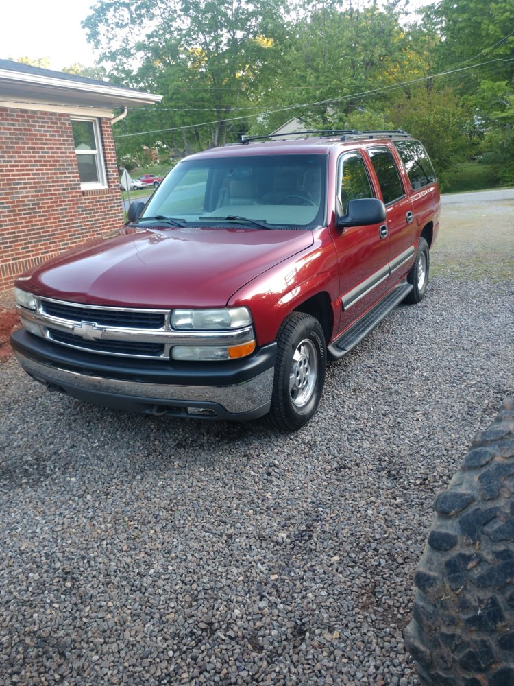

Got me a new tow rig/family ride. Wow what a difference with the 5.3 compared to the 95 TBI I sold. This is a 02 suburban 1owner almost prestine condition, religiously maintained by a dentist in Raleigh. Runs and drives like a brand new car...all for $2500.
Anyone have any upgrades or worthy mods for the 5.3. can't wait to tow with it this weekend.
Tune it and let it eat. It'll wake it up and get the transmission shifting better.
are you referring to just plugs and wires or are you talking about actually tuning it
Found out just now it has the G80 3:73 rear axle so I'm pretty happy with that.
