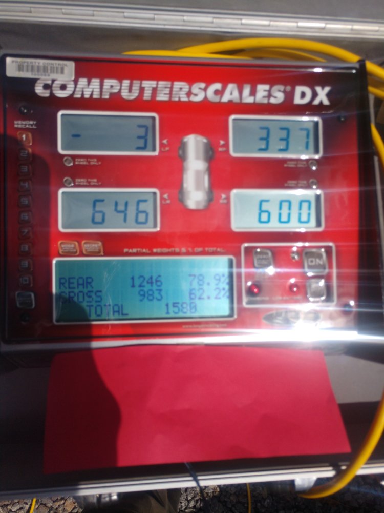

So since the tongue weight is 331lb, I need to load Jeep to where it's only adding just few more hundred pounds right? Since Tahoe says 500lb tongue weight..

You realize how tongue weight works, you cant have zero tongue weight. Jeep on trailer you had 300lbs?

I think he's trying to follow the 10-15% rule for tongue weight? Hard to believe his jeep and trailer only weighs 5k though.
Soooo 1580 for the trailer, and 4980 for the rig, so that's 656 lbs tongue weight at 10%, and 984lbs at 15%. That's the target, not the actual based on placement obviously.

So let's explore this, just to check assumptions. I'm assuming left both tires on one scale for the left side, both right tires on one scale for the right side, and the tongue jack on the 3rd scale?
Yep.
no that 331 is just trailer empty weight.
I was just stating that the way I had it loaded, I "thought" my jeep weighed a heck of a lot more than 5000, and I thought the front also weighed a lot more than the rear so I was loading it like I usually do by 60/40 ish but now that I see actual weight, it makes me realize I had the jeep too far forward on trailer now knowing the actual weight and how much just the empty trailer tongue weight is.

this is how I've been doing it but since I'm working with a Tahoe that's not mine, borrowed, and I'm working with current setup which is these funky axles that I'm not used to, makes this trailer tow little funky (the tiny shake I had at 58-62). Having that said, I'm about 99% sure I had the jeep about 7" too far forward so I think placement will/should get it to pull as good as it did at 65mph at other speeds as well.

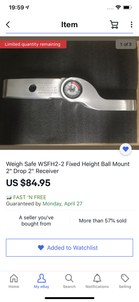

$85 and be done with it...
