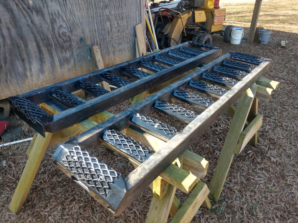

I added 1/2" angle welded across the ramps in order to mimic the mega ramps surface.
Works wonders:
