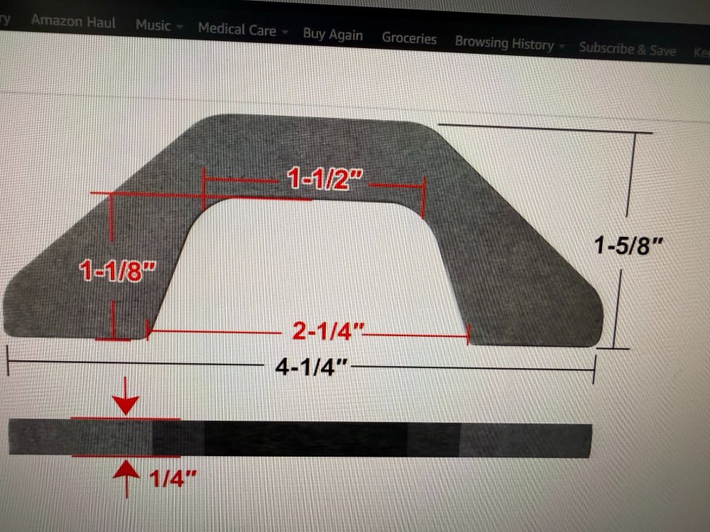

Been thinking about welding/cutting the shape onto my trailer deck also, to reduce the side pull on the straps or d-rings. Ive seen some of the trailer manufacturers are putting them on also.I will never have an offroad rig without these. I've use the fancy ones and I've just cut down some old U bolts and welded them on. Both work great. Then I just use the 2" double hook yellow straps you can always find on sale for 9.99 somewhere. That way I don't feel bad about replacing them whenever I need.
