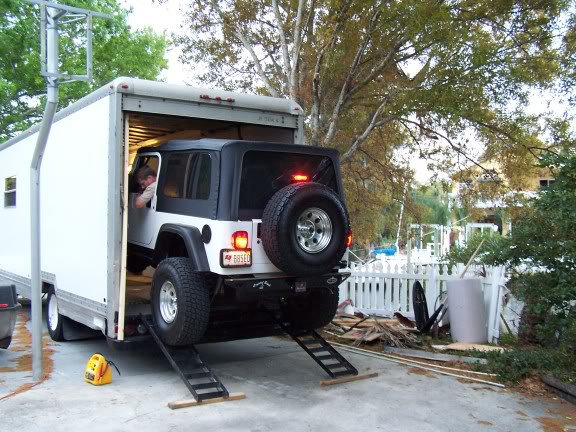

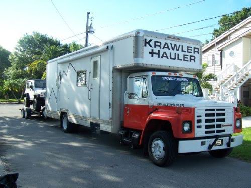

The wife and I were just talking about a similar truck and how to fit 2 rigs inside and then pull a camper. The box truck build that is.

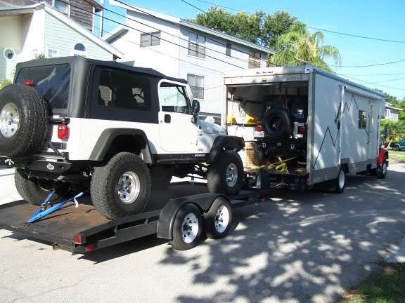

What about a old uhaul truck that the box doubles as a camper/crawler hauler. Then pull a trailer for 2nd jeep.

There really isn’t a cheap option. About the cheapest would be to buy a used U haul truck and convert it to a camper with a garage, then tow your existing trailer with one of the rigs on it and one inside the U haul.
