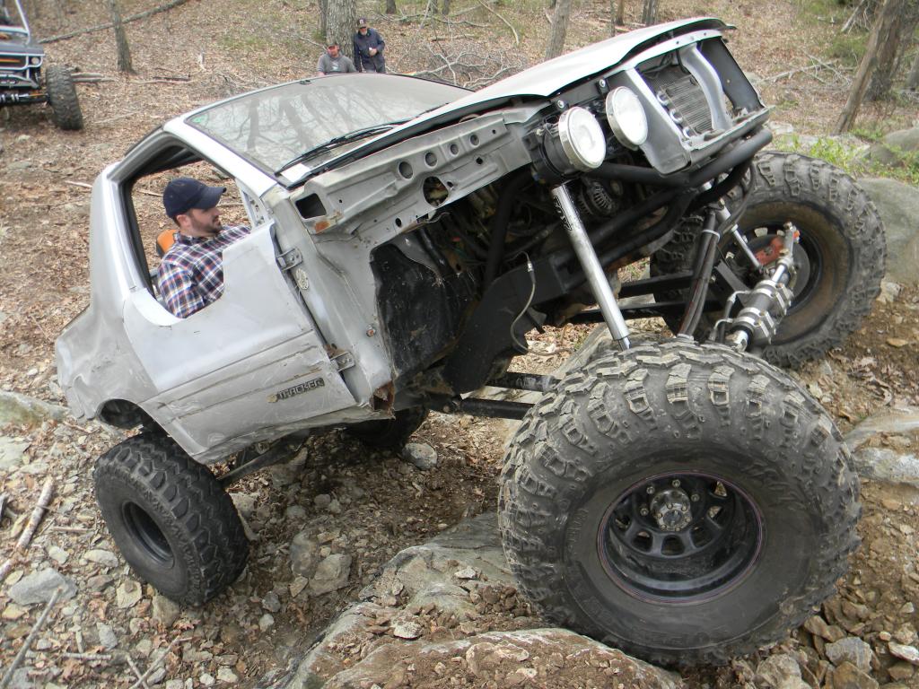

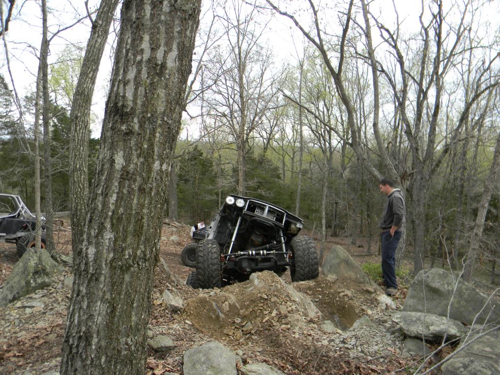

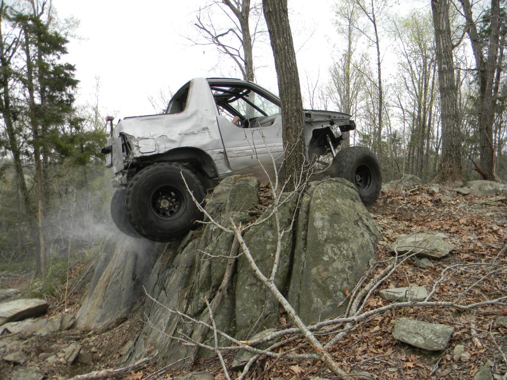

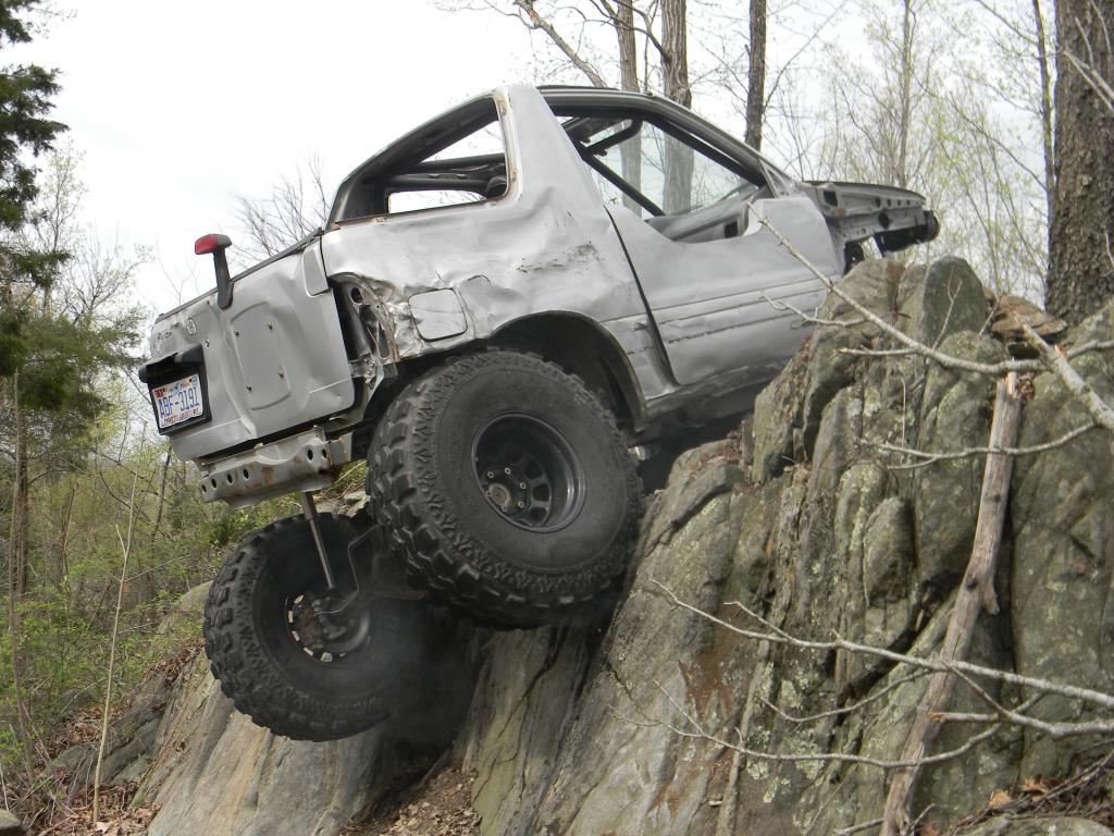

A couple shots when we were testing her out.

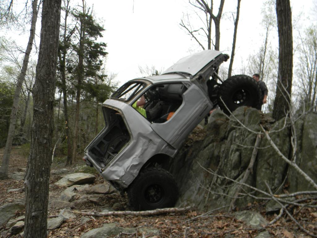

Well we made it to about 10:30 and the only bad thing to happen would be the passenger side brake line snapping off.... No biggie

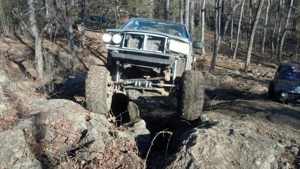

A couple pics from her first trip out to the trails
and just finished fixing the broken track bar mount a few moments ago

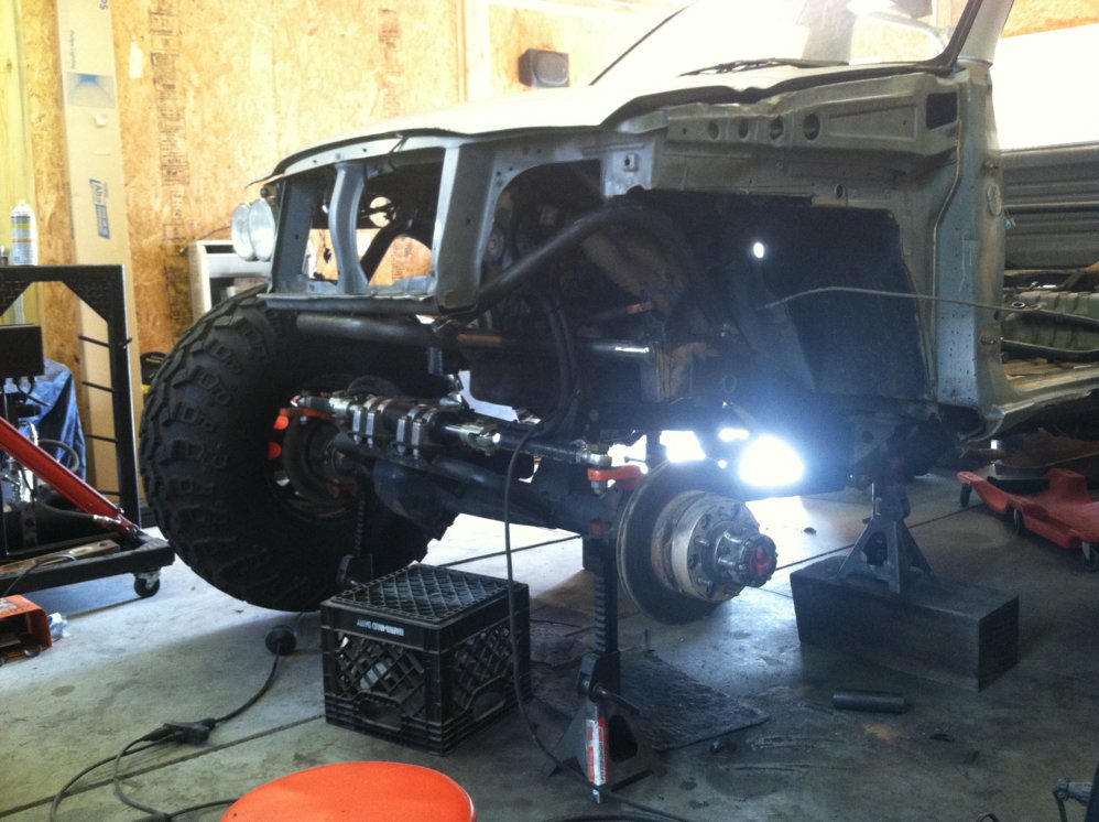

Been looking for a fix for the whole "not having headlights" problem so after alot of junkyarding i found the answer..... BMW headlights
Fitted them in the desired location securely with masking tape
Brainstormed how to mount them into the location and noticed some old seat brackets laying in the junk pile
Cut and trimmed one of the aluminum pieces
Finally Installed and wired up
Only bad news is that i could only find one set during my exploits at the junkyard so as soon as i find a driver side set I'll be ready to finish up but good news is i can finally see at night. How big of an upgrade is this over the stock headlights you ask? Tremendous upgrade, from what i can tell against the bmw headlights compared to the one broken stock headlight it seems to almost be double the lumens.

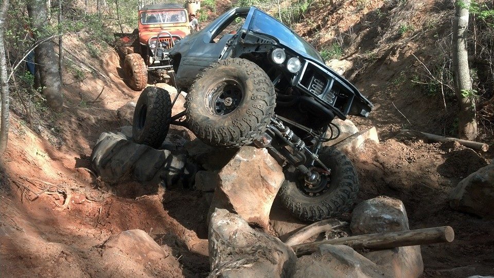

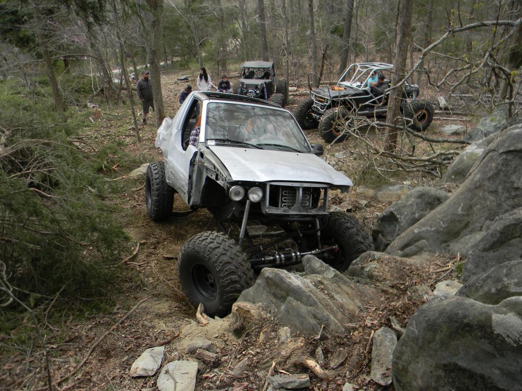

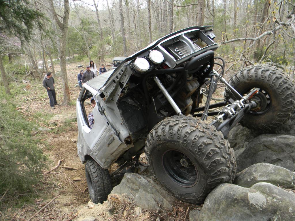

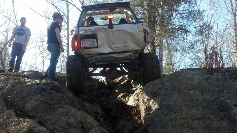

Finally took her out for another shakedown to a local place, heres a few pics of how it did
Everything worked just fine, just need gears....lol

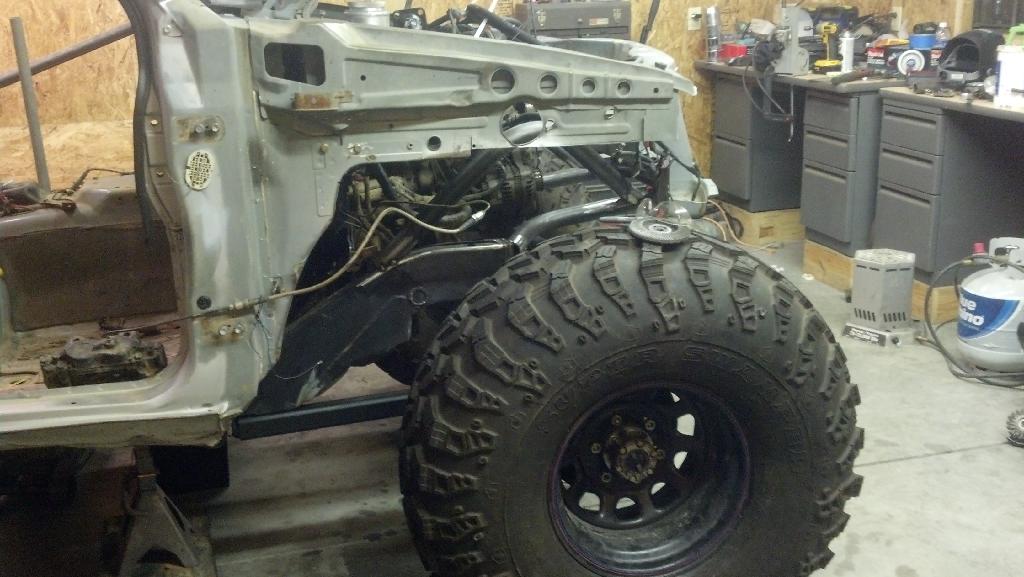

Dirka and I got alot of work done on his tracker today. Heres a before shot.
ai878.photobucket.com_albums_ab350_StuntmanAutoworks_Custom_20282473013135a3018bb3a6c51b631228.jpg

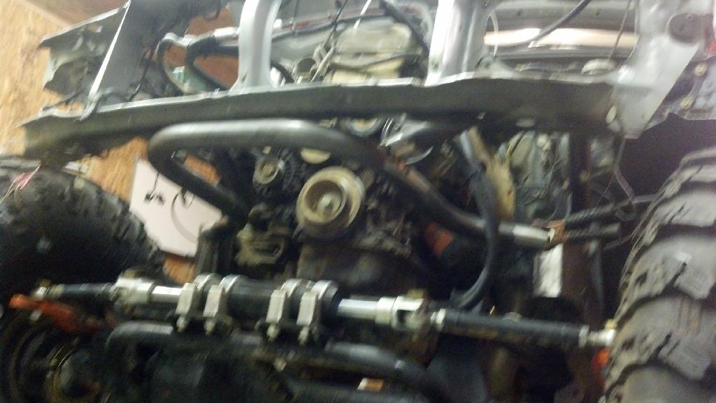

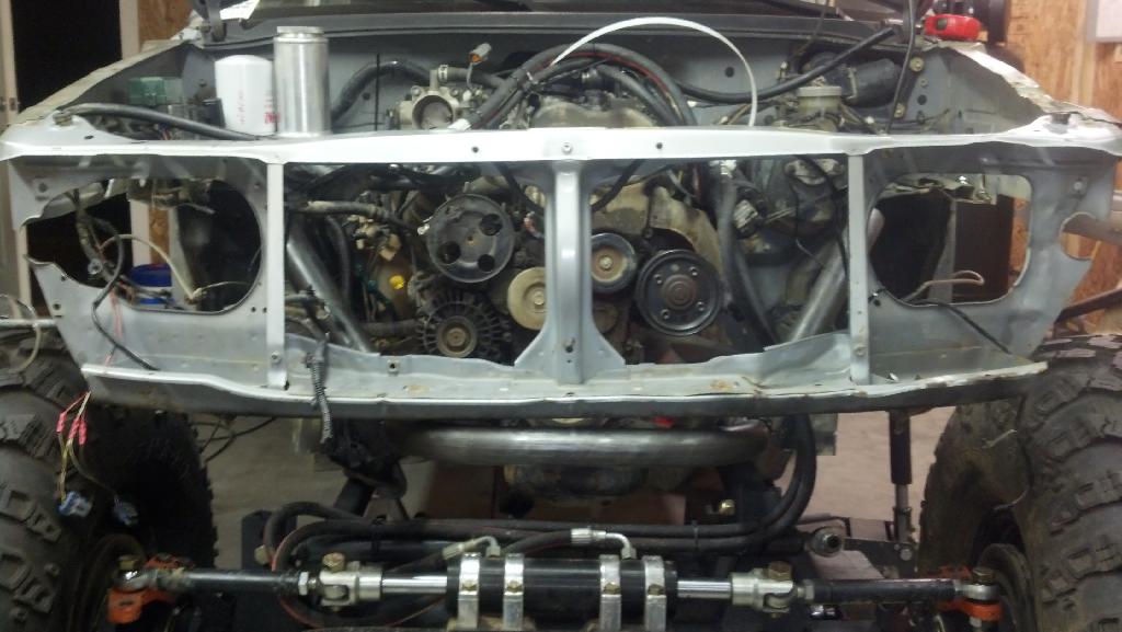

Then we cut the frame off in front of the motor mounts.
ai878.photobucket.com_albums_ab350_StuntmanAutoworks_Custom_207e0bab177570ec6ce63511a400f8216c.jpg

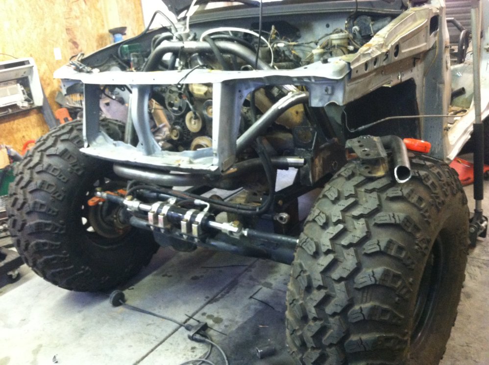

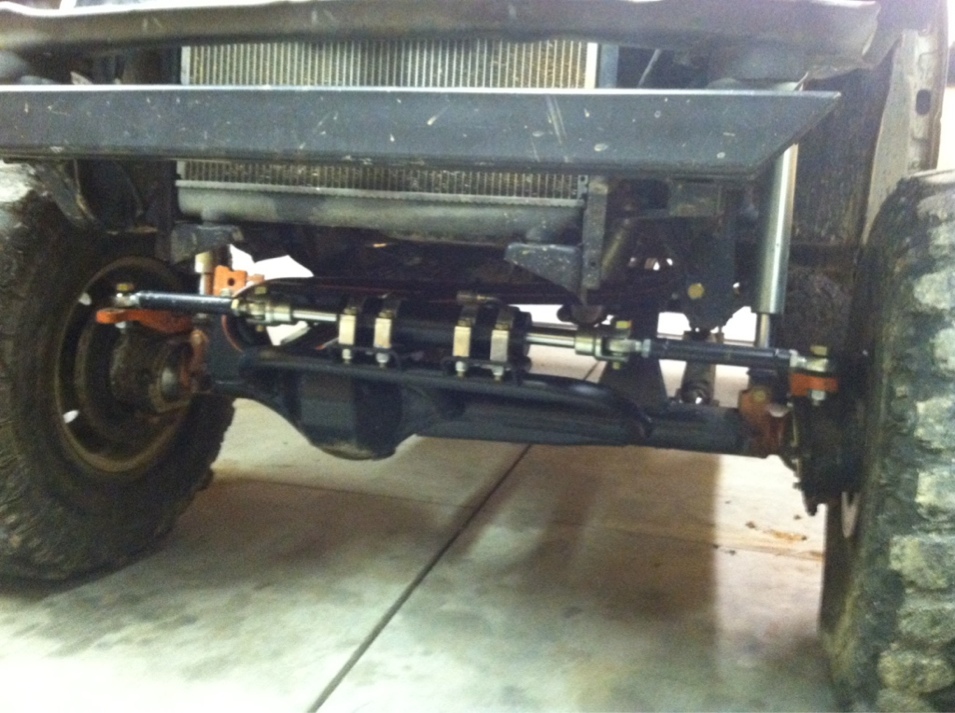

Then we put his new to him 37's on and stretched the front out 9 inches.
ai878.photobucket.com_albums_ab350_StuntmanAutoworks_Custom_20ba703c6a24235ac57cae2834f84705e5.jpg

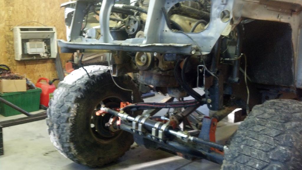

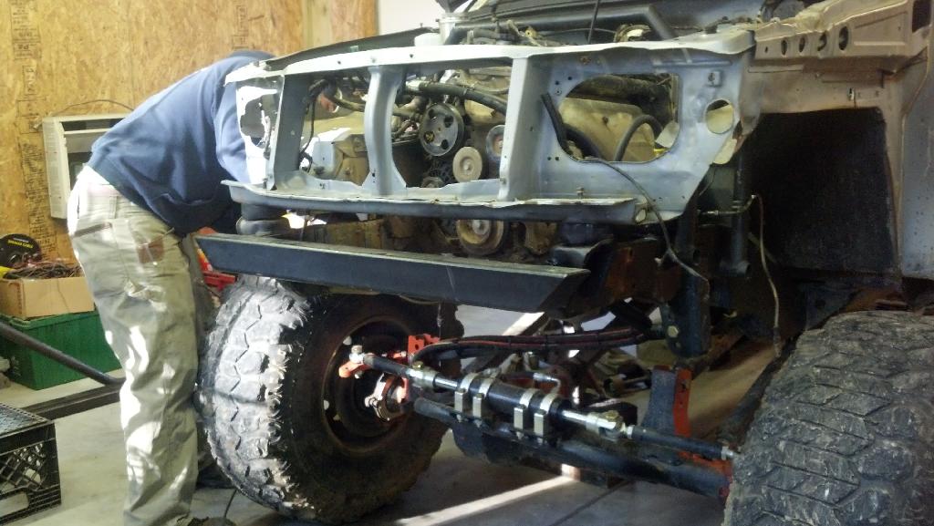

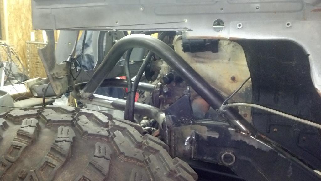

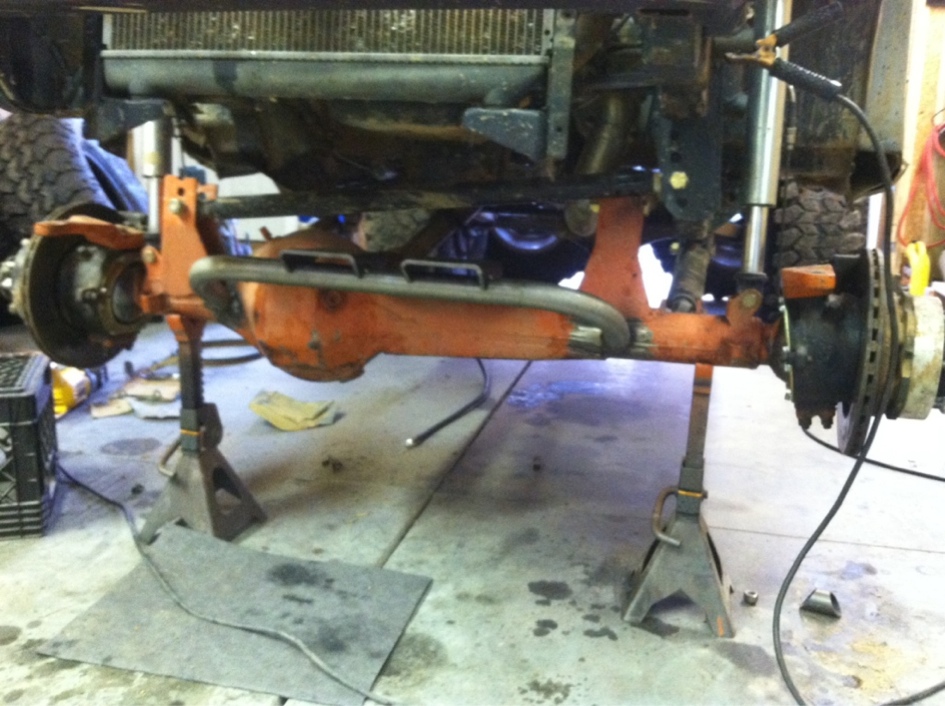

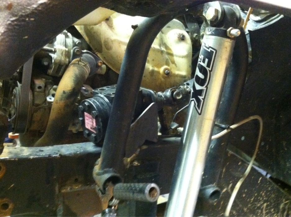

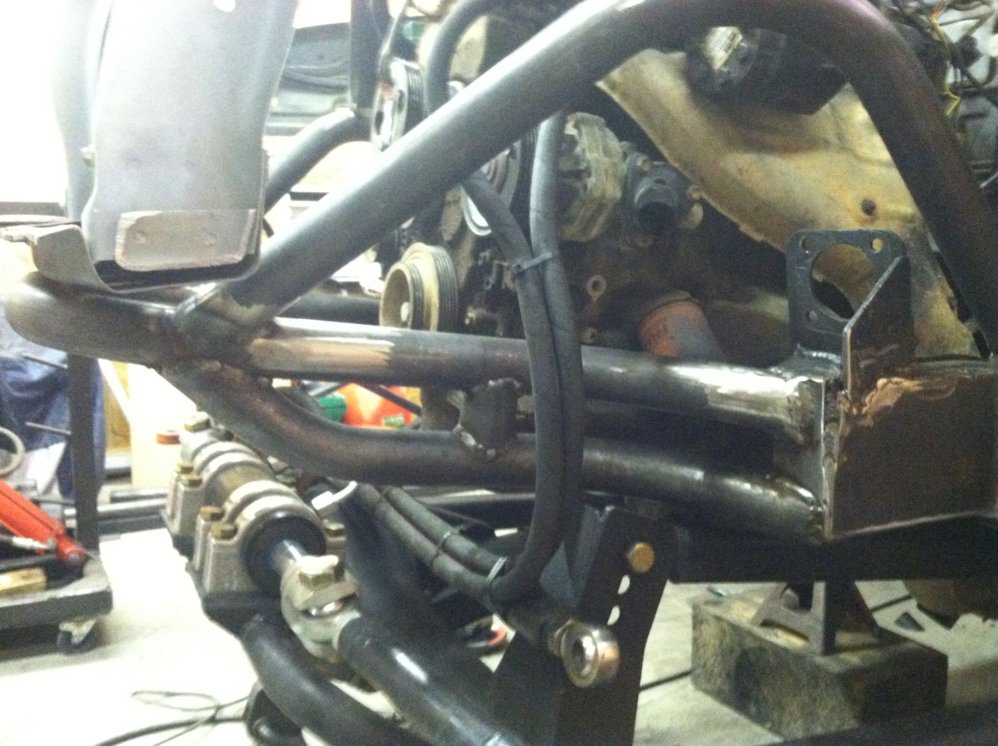

Then it was time to do some tubework, narrowed the front so we could bring the shocks inboard some and have room for the bigger tires to turn. You can see the shock hoops also. We will be tying these in more later.
ai878.photobucket.com_albums_ab350_StuntmanAutoworks_Custom_20dd5e2b730b5af9c7e6212ead354c9f3e.jpg
ai878.photobucket.com_albums_ab350_StuntmanAutoworks_Custom_20a0b02d89428a132293a127083847e23a.jpg
ai878.photobucket.com_albums_ab350_StuntmanAutoworks_Custom_2023f5278fc7681e186202af83018d7cd0.jpg
Look's good man

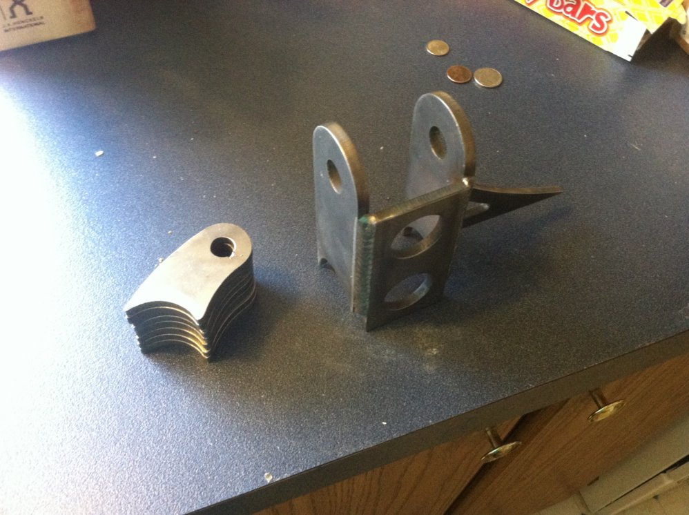

Got all of my tabs for the shocks and the custom trackbar mount from Chris at MarsFab the other day

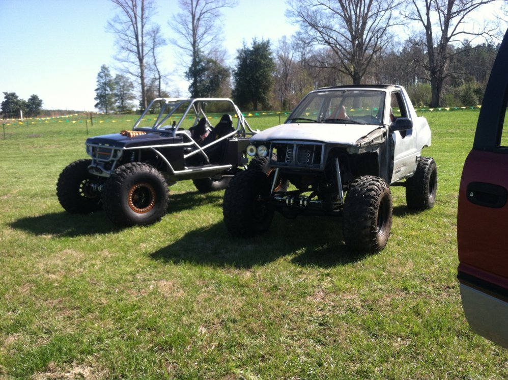

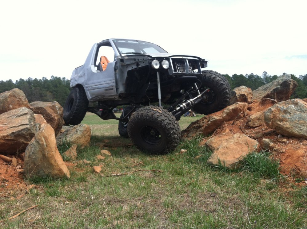

Finished up everything and Stuntman Autoworks and I took both of our rigs up to the Uwharrie jamboree to show of our hard work

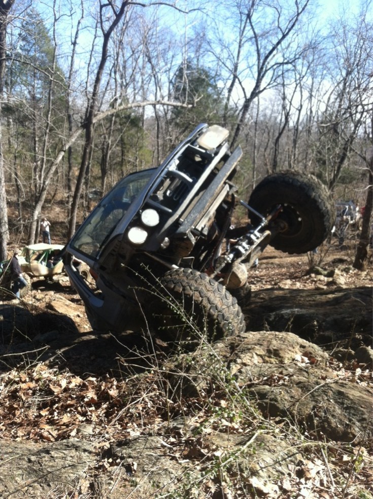

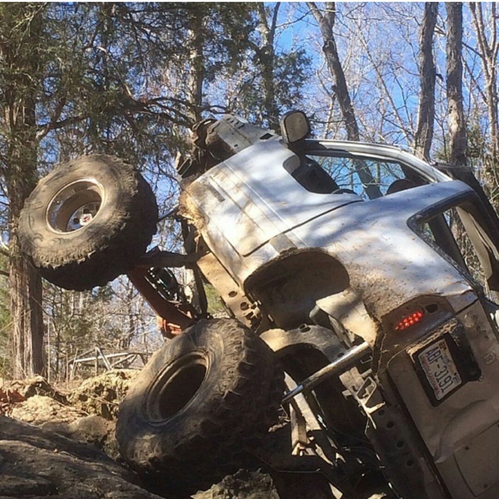

I found this picture on Instagram. Hangin tire!

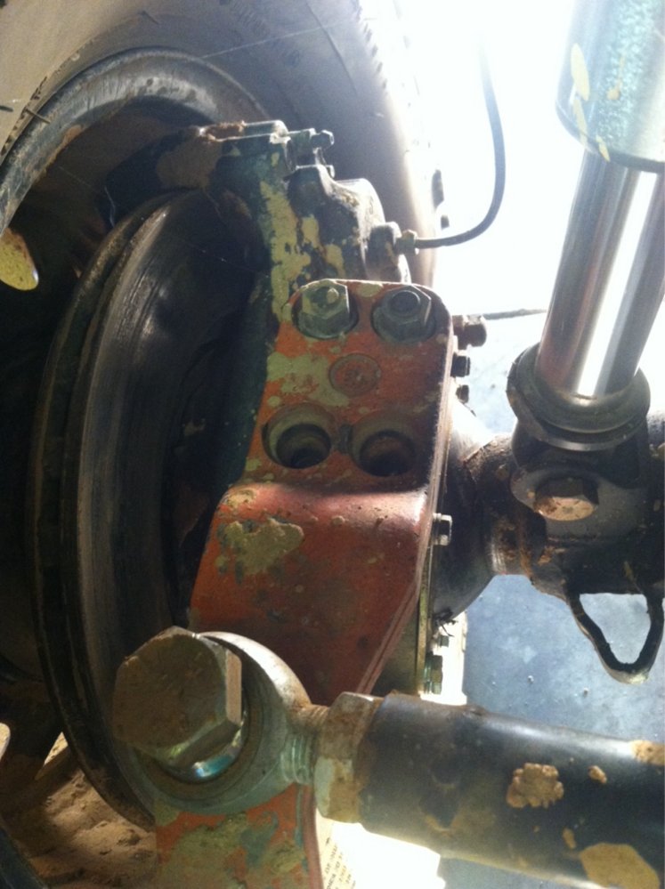

Oh yea man I'm sure well try to make it down to the gulches for that but I gotta do some repairs first though. Front driveshafts shot and I sheared two studs off of my passenger side knuckle
