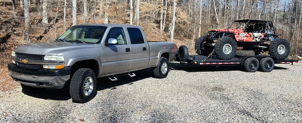

And I had to tuck my balls up as a 12v owner. I love my truck but I know for a damn fact there’s no 7.3 or 12v doing what newer diesels do. (Or even a solid 8.1 gasser in a GM platform for that matter). He needs to find a solid GMT800 and be done with it. Spend the money saved on the gas he will spend.

I haven't had this thing a year yet, so I'm still very much so in love. Keep your eyes peeled though, and join the 8.1 truck groups on FB. Seems they post a link for ones for sale about once a month. I was truly fortunate that I was watching FB marketplace like a hawk and this one popped up just a few miles from me. It was a small used car lot and the owner didn't realize what he had. Just listed it as a 4 door 4x4 and assumed since it wasn't diesel it wasn't a big deal.
