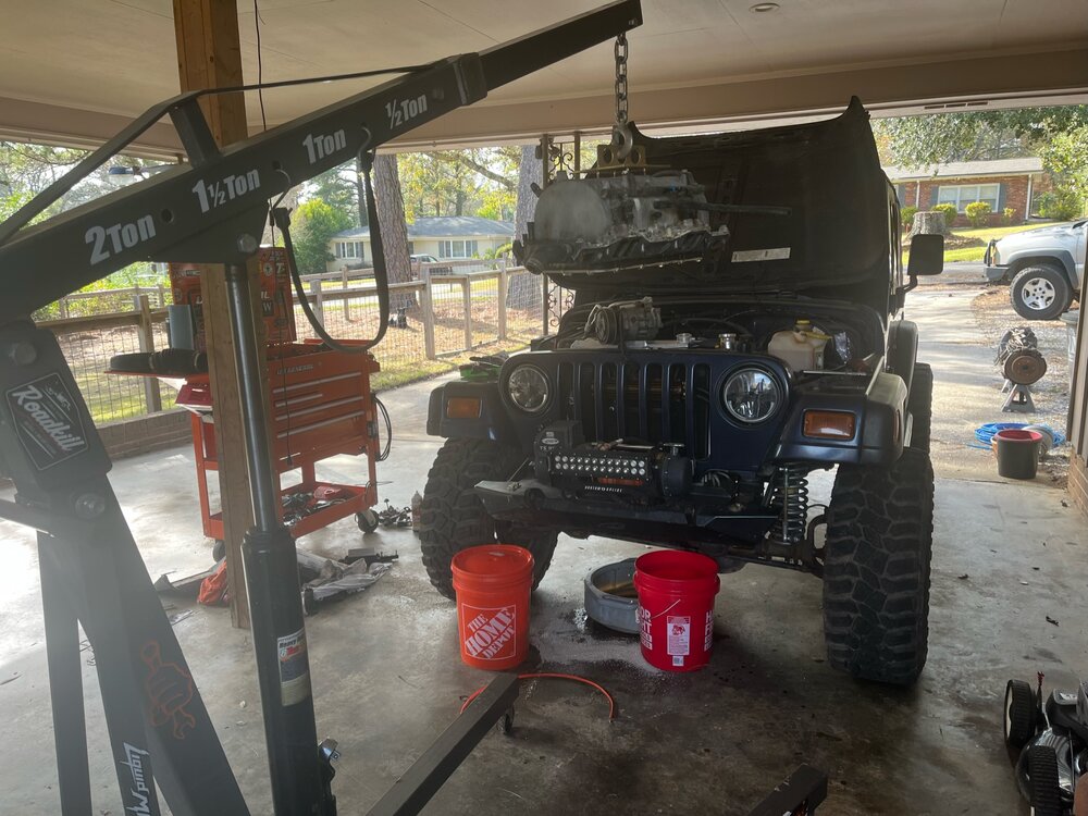

Picking up from where we left off, I decided to take a weekend to get the Jeep back up and running. The short answer is that it's fixed, though I'm not entirely sure what the problem was. I pulled the intake off and re-sealed it (in hindsight that was mostly a waste of time), cleaned and reinstalled the original IAC and cleaned the throttle body and that fixed the issue.
The test drive for the Jeep was a few trips to work and then a 300 mile round trip to Auburn (where ECORS held races in 2011 and 2012) and though the stalling issue was resolved, it developed a bad misfire that I suspected was due to poor plug wire routing on my end. A few poser pictures from our Auburn trip:
The misfire got so bad that the Jeep was practically undrivable so this was the next issue to dive into. These engines are known to have an issue with spark knock caused from improper spark plug routing (there's actually a TSB for it), so wire routing was the first thing I confirmed correct. Next I started pulling plug wires one a time and checking for resistance. Sure enough one of my brand new plug wires had gone bad (or I'd broken it) so I threw on an old wire and it's been running like a top since.

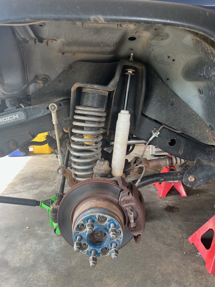

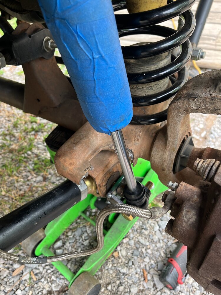

I swapped out the front Rough Country springs (intended for a 4cyl) and 2” spacers for 3.5” JKS dual rate springs without any issues. The JKS springs provided the same lift as the RC springs did with the spacer but made a substantial difference in ride quality. Crazy what the correct parts will do.
Before:

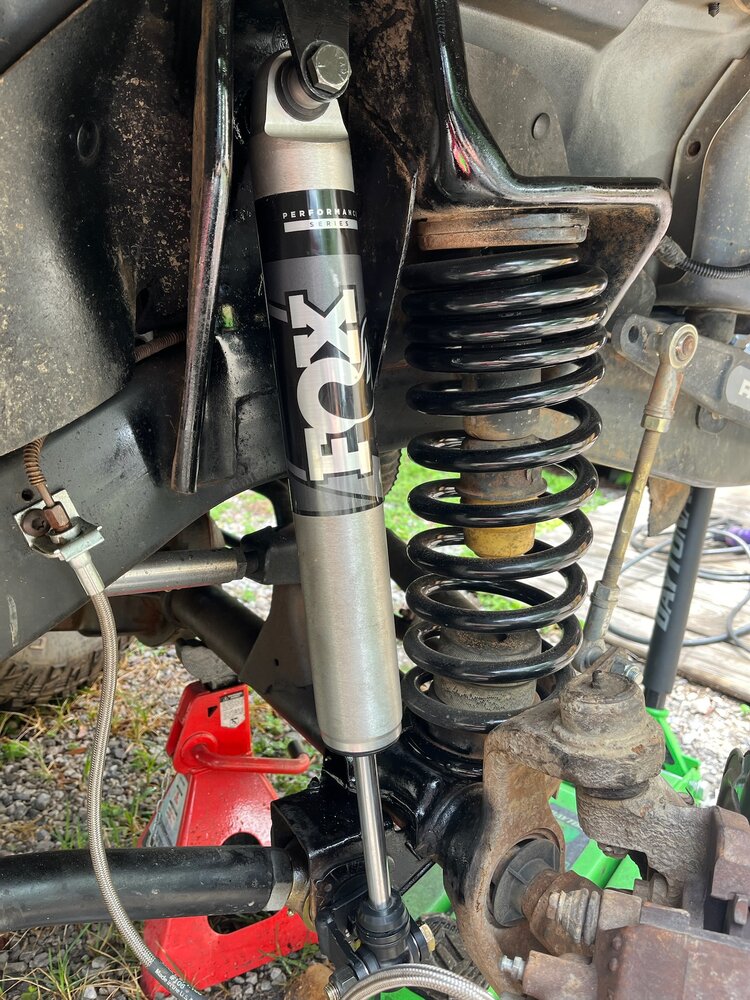

While I was working on the front of the Jeep I just couldn’t ignore the shiny JL Fox shocks that I picked up on Marketplace for $135 any longer and decided to swap those on as well. The inspiration for this swap came from this thread: JL shocks on a TJ
This is the front shocks in question: Fox Shox 985-24-171 Fox Racing Shox 2.0 Performance Series IFP Smooth Body Shocks | Summit Racing I intend to swap rear springs and shocks when the D35 is pulled for the 8.8 swap. This was a pretty simple swap that took a few hours and some basic fabrication skills. The upper mount landed right at a factory hole in the shock tower, so I pulled a weld washer and shock tab out of my stock and ended up with this:

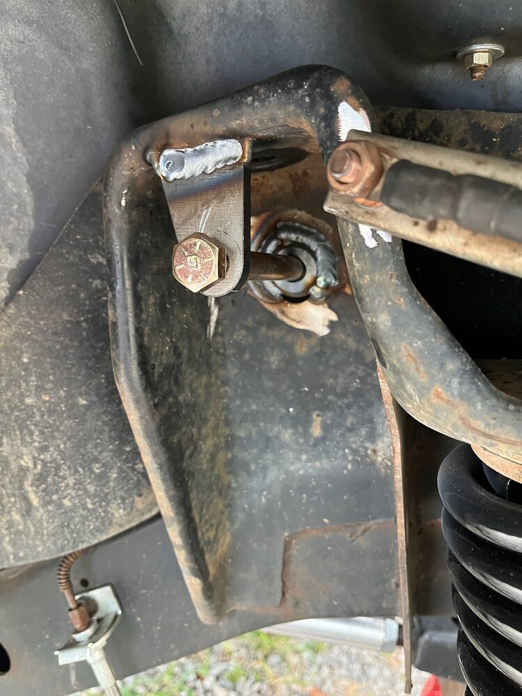

Onto the lower mount. The original shock mount was removed to make room for the tabs needed to catch the lower eyelet. The lower mount ended up being a simple clevis that was attached with the LCA bolt.
The tabs are meant for ½" hardware and the shock bushings are drilled for the foreign equivalent (aka 13mm), so I drilled the bushing out to ½" to work with the tabs and hardware I already had.
I only had time to get the passenger side done this weekend but can already tell a positive difference in the on road ride quality. The difference will really become apparent once the rear axle is swapped and the track bar isn’t trying to coexist with the fuel tank.

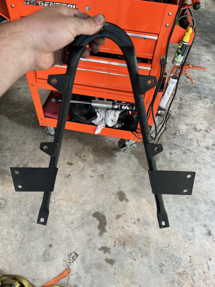

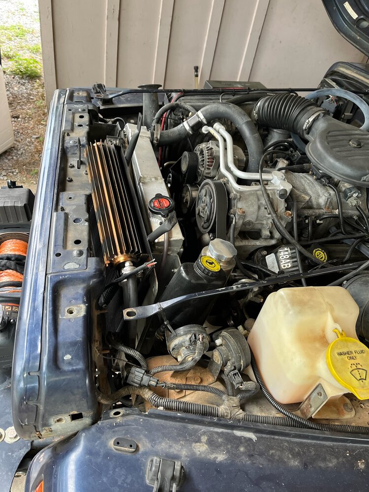

Next on the list was to spend some time on the cooling system to make it better than marginal. I’ve learned time and time again to start with the basics when troubleshooting and made something resembling a plan which was:
  1. Remove / relocate the power steering cooler.
  1. Relocate the transmission cooler.
  1. Revise the steering cooler mounting bracket.
  1. Install the driver side grill shroud between the grill and condenser.
  1. Revise the upper radiator hose to remove the chance of an air pocket.
I know that my cooling fan needs an upgrade (and that’s coming) but I wanted to start the above list and see what happened. I unbolted the front grill shell and tipped it forward enough to get to the transmission and steering coolers. The transmission cooler was zip tied under the front bumper and the steering cooler was deleted for now.

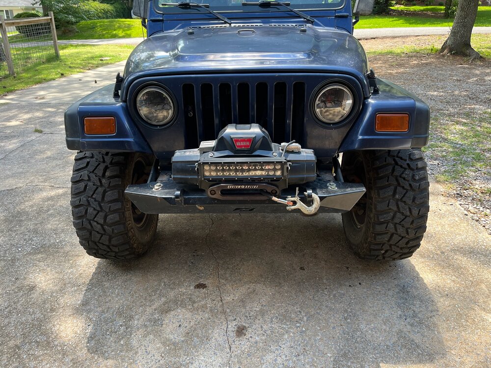

Another update that is completely unrelated to the cooling system was installing this Warn Zeon 8k winch that I picked up with a brush guard from, you guessed it, Marketplace. The brush guard is for a truck that I’m buying in the future and I managed to get the unit for less than the brush guard is worth – I'll take that all day! The Superwinch that it is replacing has been flawless for 10+ years now (and frankly, really didn’t need replacing) but I’ve always wanted that Warn ‘W’ on the front of my Jeep.
