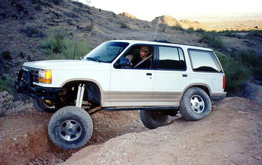

here is a nice TTB setup i found.
The Zimmerman Explorer didn't last a year before the TTB went all to shit. They put a solid axle under it instead.
1. Its still a 44 which in a foolsize and ME isnt a great combo
2. Its not locked/geared so that isnt an advantage
3. The "forced articulation" of a solid axle on the newly cut and turned beams would be subject to long term quality issues
4. I like using the sawzall
