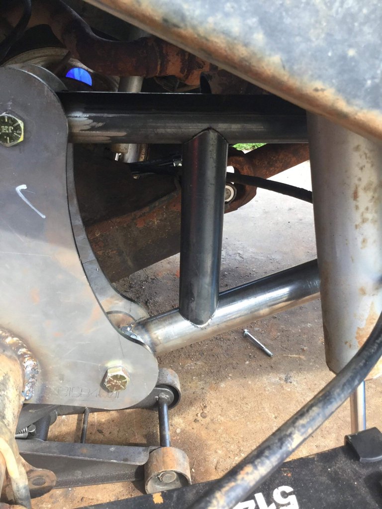

Example of some basic ass notching I did for a traction bar
I’m not an expert but that almost looks like I know what I’m doing. Really, I’ve only notched maybe 50 times. Don’t do much tube work because it’s flat here and I just got a bender and found a place to get a decent price on tubing from. So if you’re going for that clean look, get ready to math, plan out your builds, and where your nodes will be.
