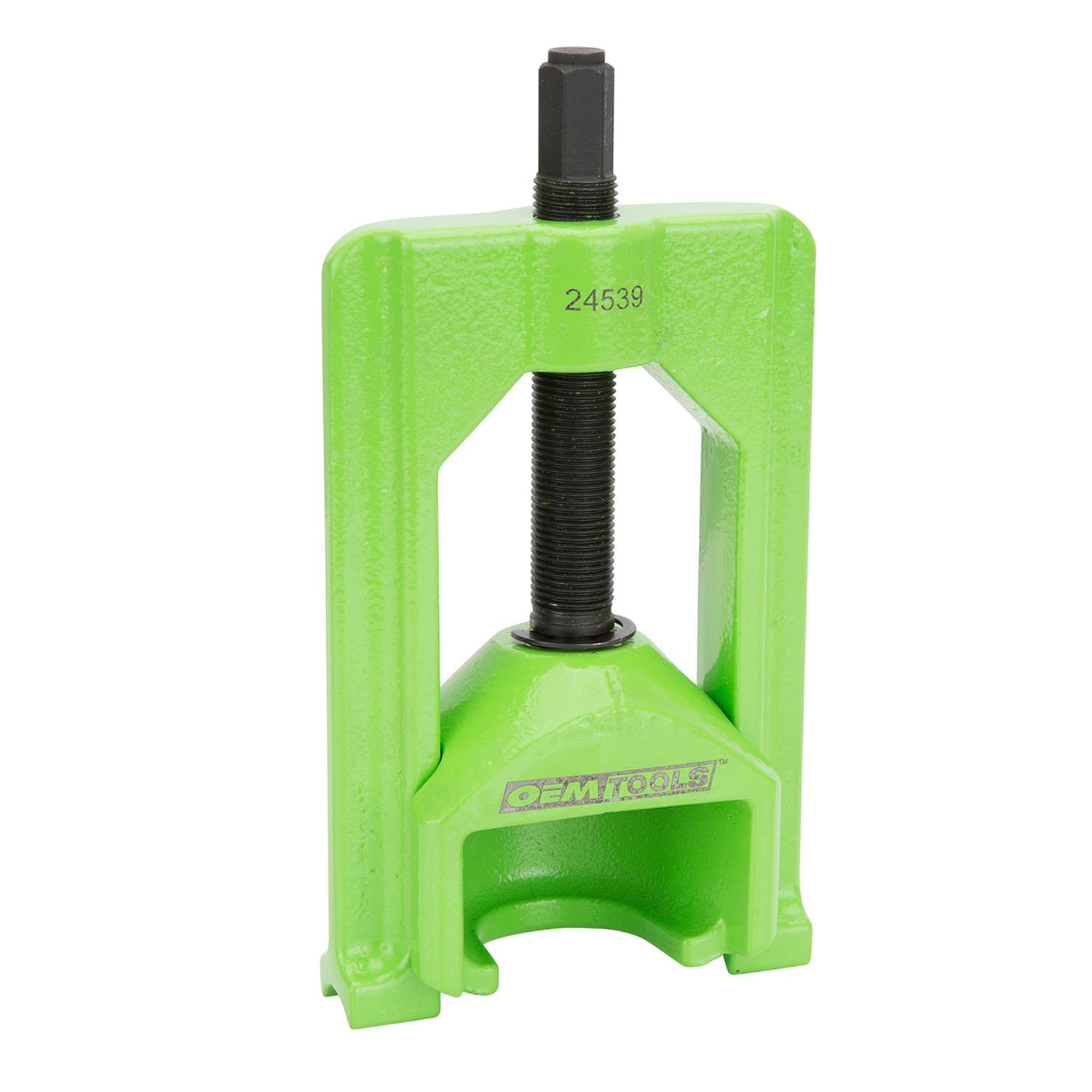

Has anyone used a u-joint press like this before? I am wondering if this is some insider secret OR if it is just a great way to bend the yokes on your axle?
Like many, I have used a ball joint press for the super stuck joints, only to bend a yoke......which can be problematic.

@Kickdeez may have used one of those.

The secret info is a big ass hammer and a good vice. I've changed more than I care to count and I've never had some I couldn't get apart. Actually embarrassed a guy one time who had spent a couple hours and a few different methods trying to get a set of dodge shafts apart, I had the first joint out in less than a minute.

I used a cheap pitman arm puller from HF to remove some joints a couple weeks ago. Same concept as the tool you posted, but a fraction of the price. I had to grind a little off the ears of the puller to fit around my 1480 caps. But it was a breeze.
