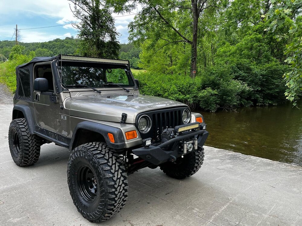

A few months back I stumbled across an 05 TJ that the owner was tired of working on. We had talked about selling the CJ5 when it’s done for something with better road manners and to wheel until I finish the CYJ. And as much as my wife loves that old Jeep and I do too, she isn’t a huge fan of driving a 3spd and no power steering.
The PO had chased the 42RLE issues of it sticking in 2nd gear and going into limp mode and honestly I think he got hosed by whomever worked on it for him. They swapped in a new transmission instead of addressing the known ECU issues. When it came back it had a slight tick too. Add to that the steering was wore slap out. It had a drop pitman arm on it that made things mildly terrifying above 60.
We showed up, agreed on a price that I think gave him sellers remorse and took them to dinner to ease the pain.
Overall the bones were there
05 4.0/42RLE
135k

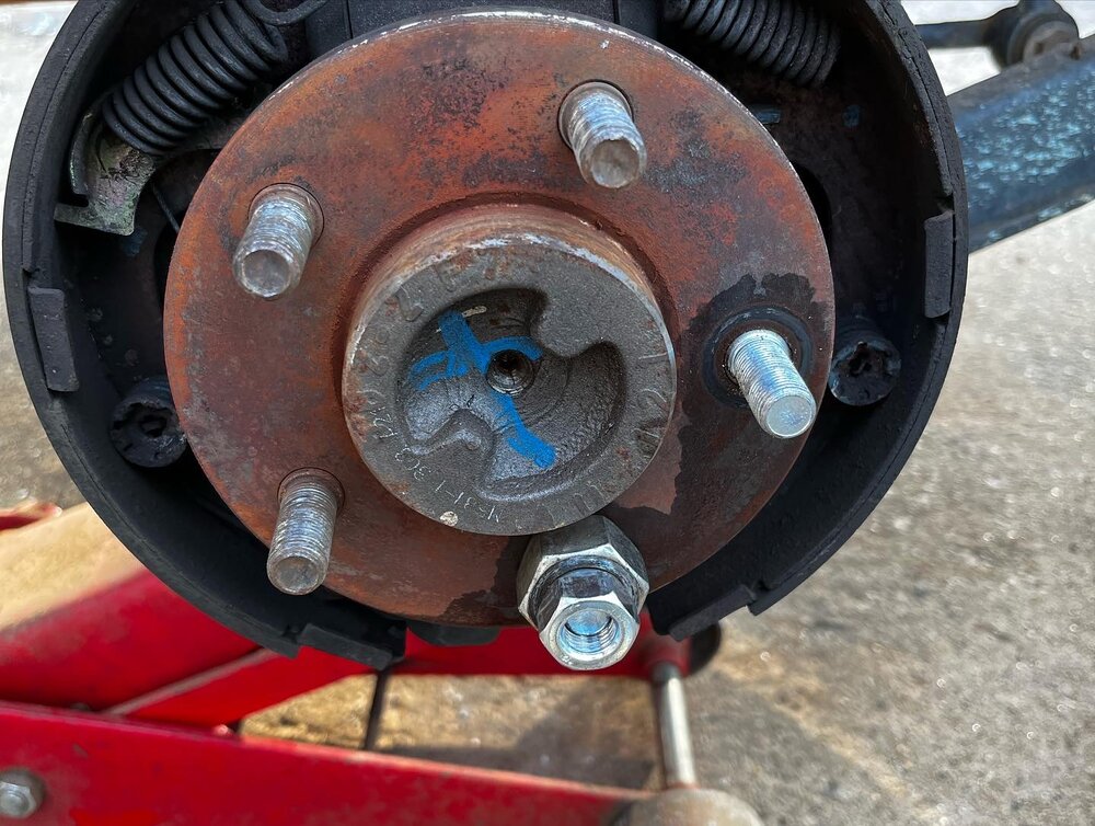

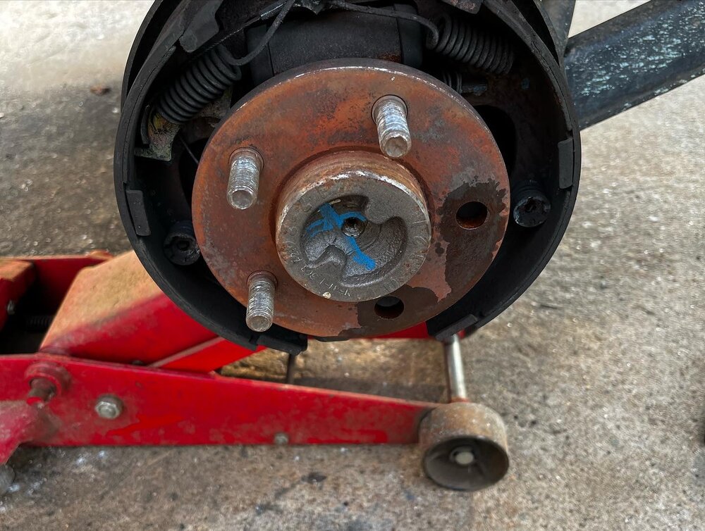

During the wheel/tire swap some of the studs were wrecked from the deep offset aluminum wheels and too many uggaduggas. About 5 in total between the 4 wheels.

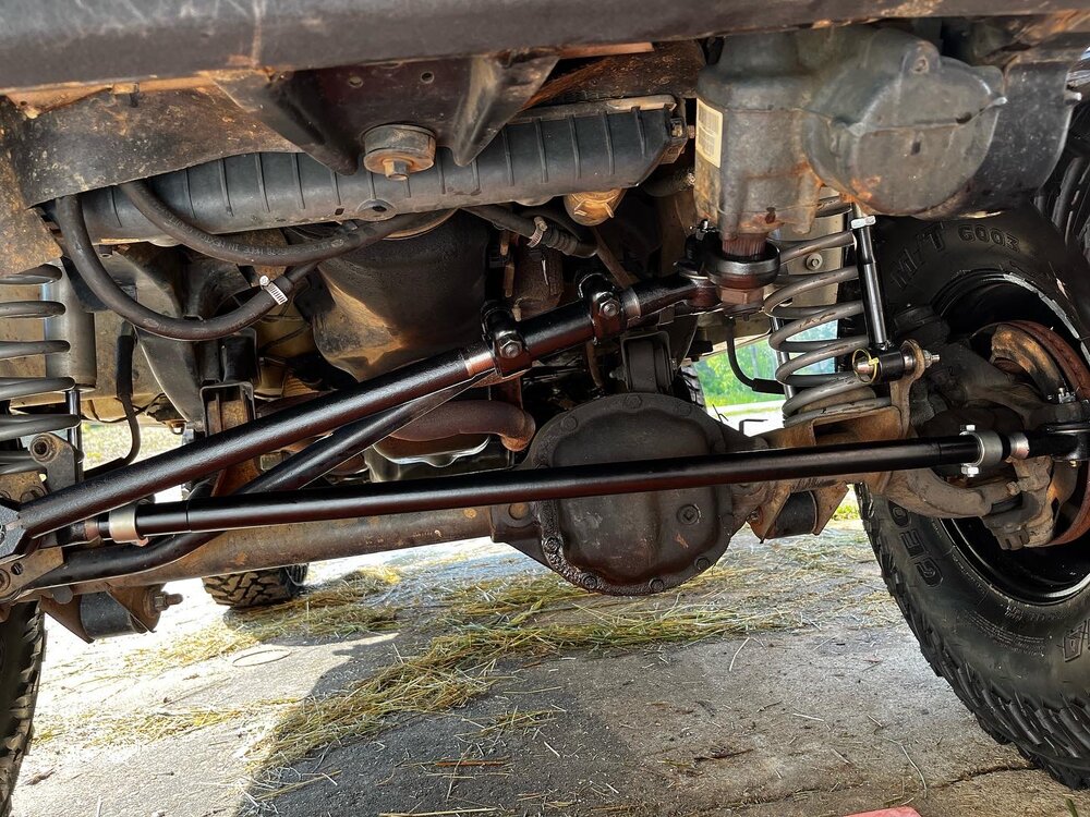

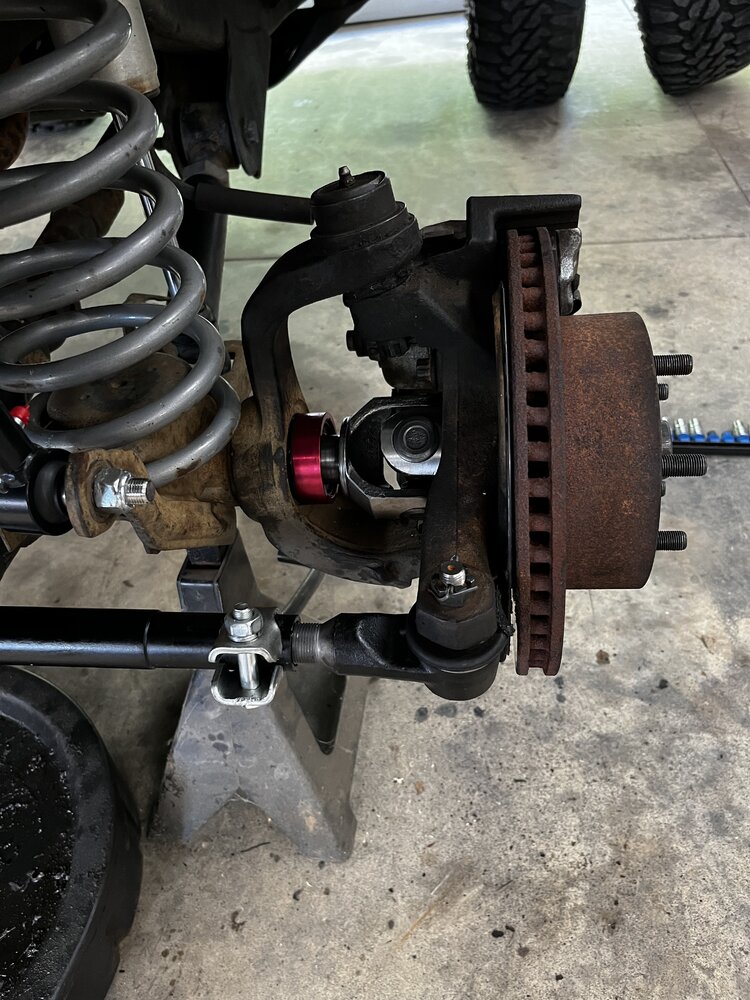

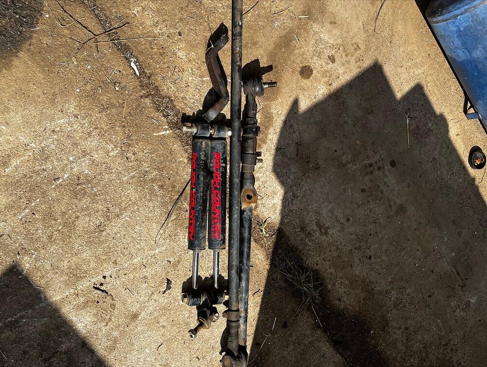

It drove a little better after that but there was still a lot of play so thanks to @tobaccoroad4wd for ordering me up a Currie Currectlync kit to go with the OEM pitman arm I had already grabbed from the parts store.
Old and busted
Fresh

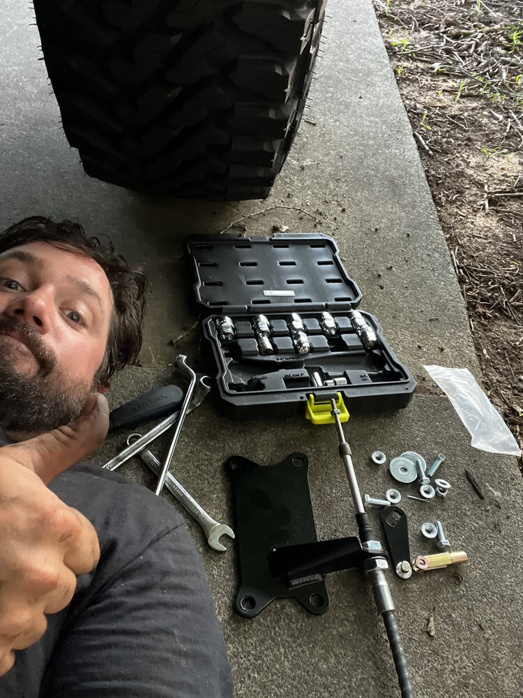

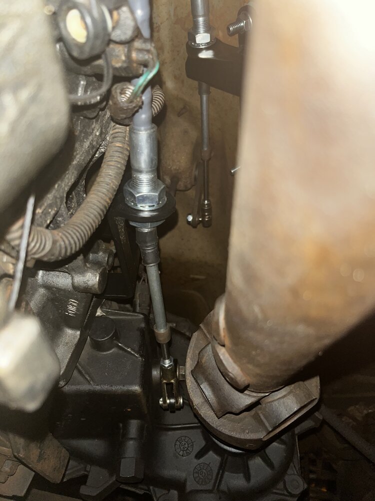

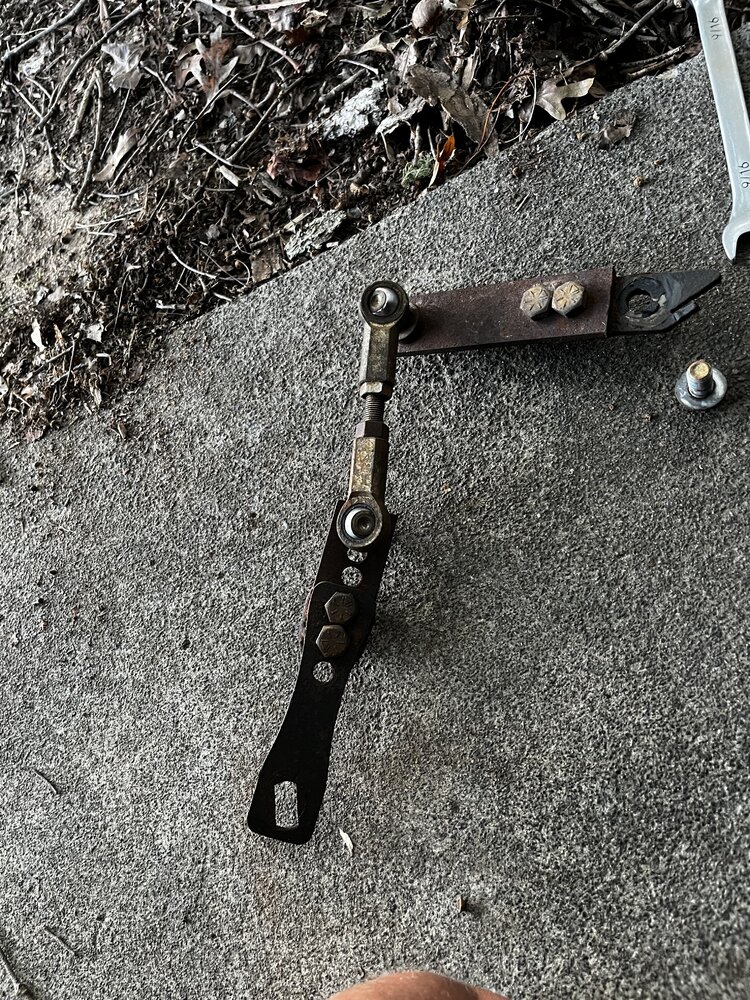

Leaving FloydFest in the inevitable downpour of a music festival, 4wd was used and low range wouldn’t engage. Not shocking given the tcase drop and the wonderful homemade linkage it was sporting.
That crap got thrown in the trash and a Savvy cable shifter went in.

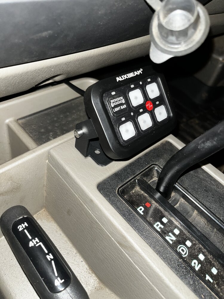

Next was addressing the miles of wire and switches that didn’t work for the Amazon LED’s. I ripped the pods and small bar off the bumper and left the big windshield bar simply because it’s there and the brackets had kind rubbed the windshield frame a good bit underneath. That got wired back into a relay pod and mounted on the console with room for more stuff should I add it later on.

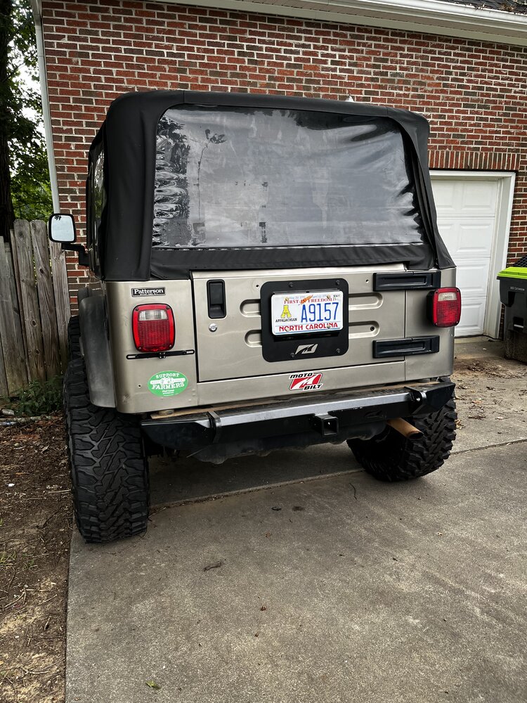

Removed the Chinese rear bumper in favor of the Motobilt unit that was originally on the CJ5 and cleaned up where the tire carrier was.

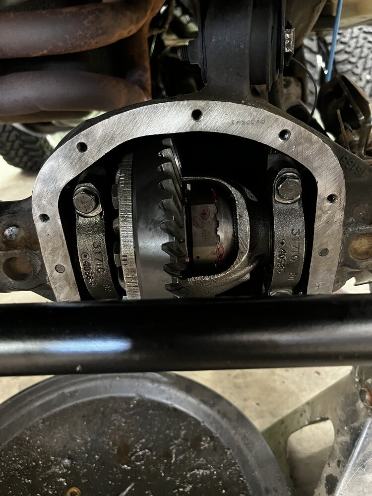

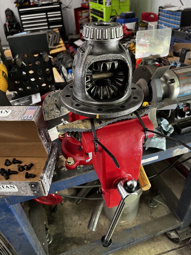

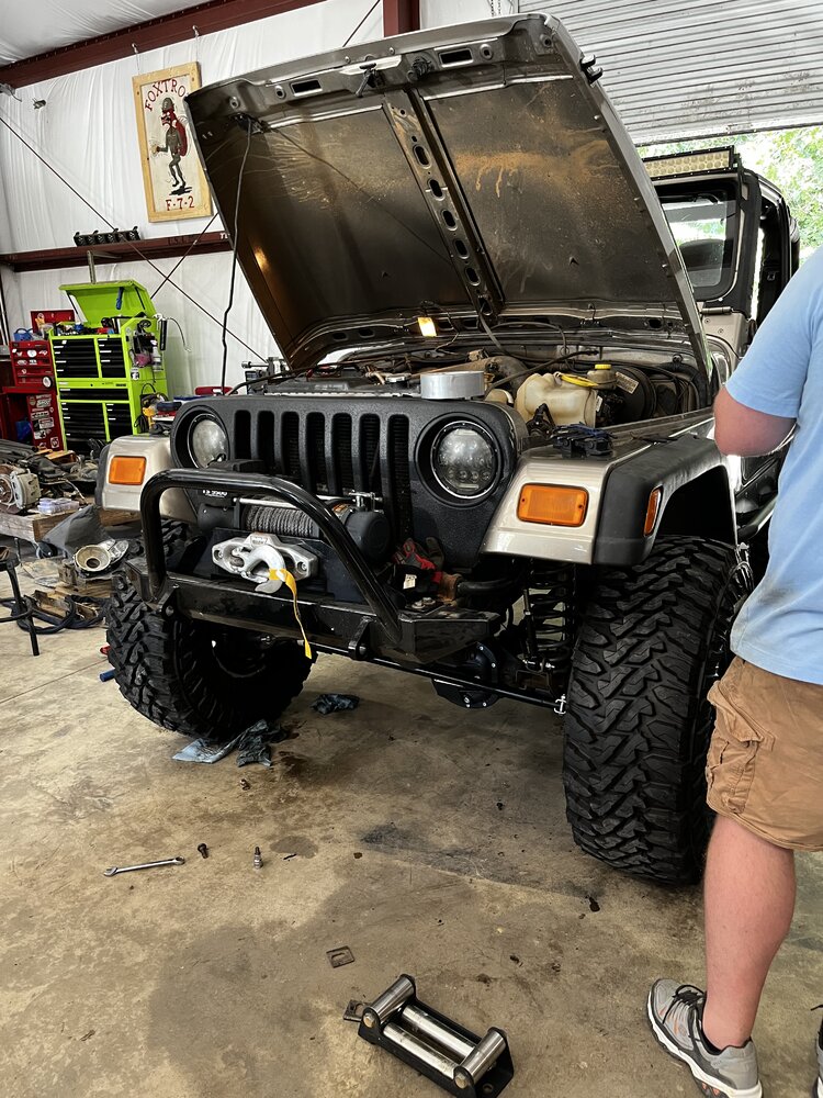

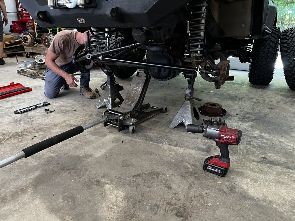

Spartan locker and chromos for the Dana 30 and some Core control arms since the bushings in the stock arms are pretty worked.
