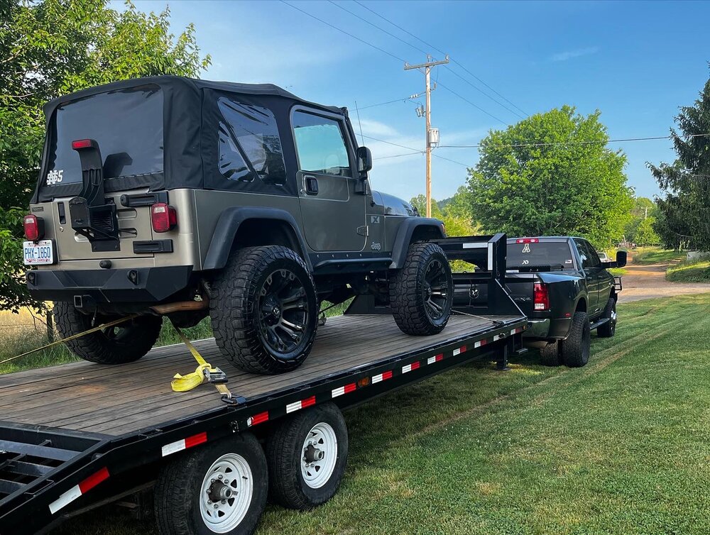

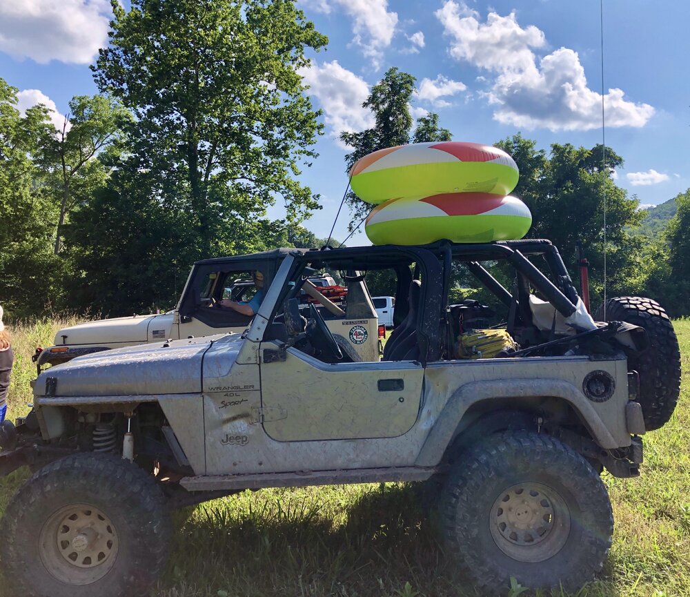

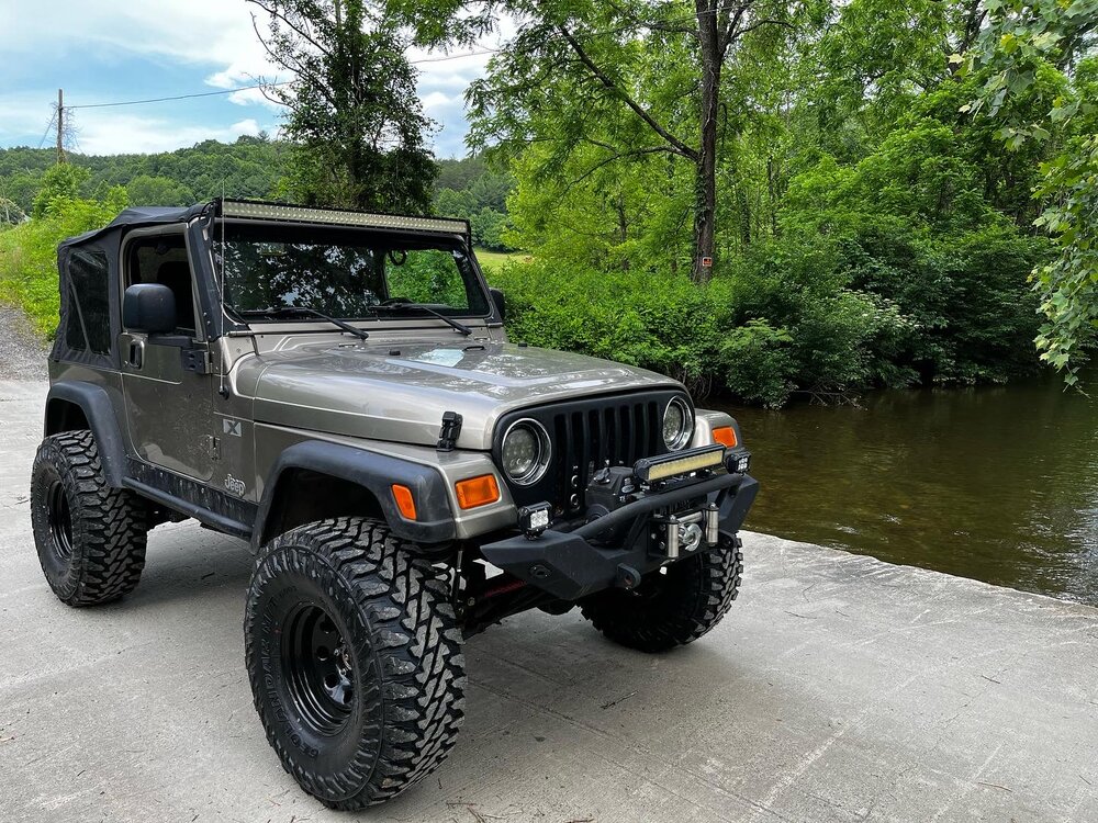

A few months back I stumbled across an 05 TJ that the owner was tired of working on. We had talked about selling the CJ5 when it’s done for something with better road manners and to wheel until I finish the CYJ. And as much as my wife loves that old Jeep and I do too, she isn’t a huge fan of driving a 3spd and no power steering.
The PO had chased the 42RLE issues of it sticking in 2nd gear and going into limp mode and honestly I think he got hosed by whomever worked on it for him. They swapped in a new transmission instead of addressing the known ECU issues. When it came back it had a slight tick too. Add to that the steering was wore slap out. It had a drop pitman arm on it that made things mildly terrifying above 60.
We showed up, agreed on a price that I think gave him sellers remorse and took them to dinner to ease the pain.
Overall the bones were there
05 4.0/42RLE
135k
3.5” rough country springs
Adjustable front lower control arms
Fox Shocks
Tcase drop
4.56 gears
35’s on 20’s
Amazon bumpers and LED’s
Superwinch 9500

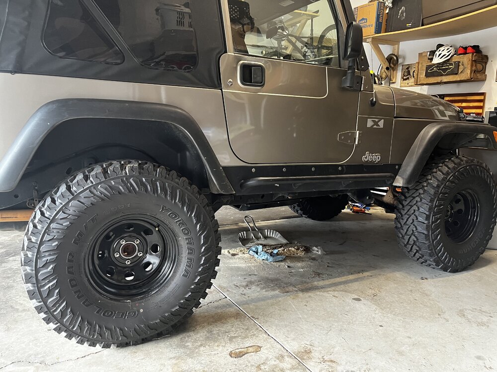

First thing to go were the heavy 20’s in favor of some 35x12.50 Yokohama MT’s on 15x8 soft 8’s.

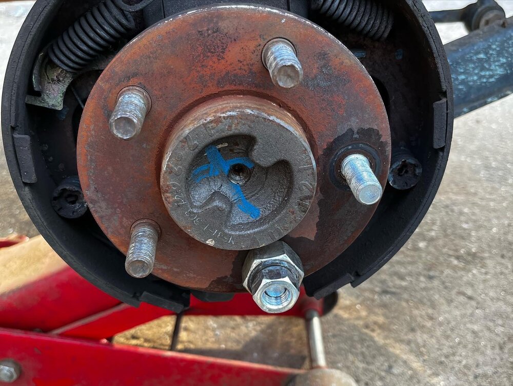

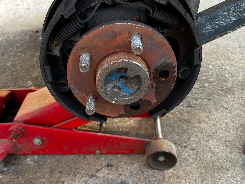

During the wheel/tire swap some of the studs were wrecked from the deep offset aluminum wheels and too many uggaduggas. About 5 in total between the 4 wheels.

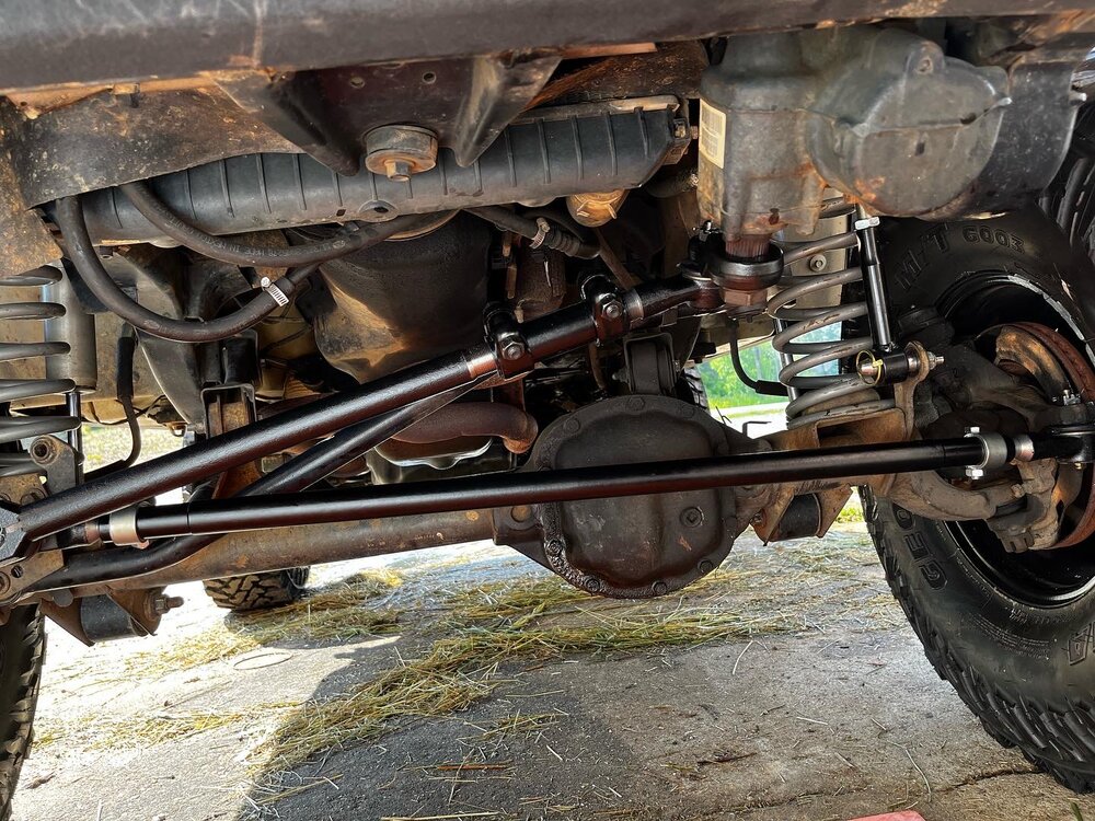

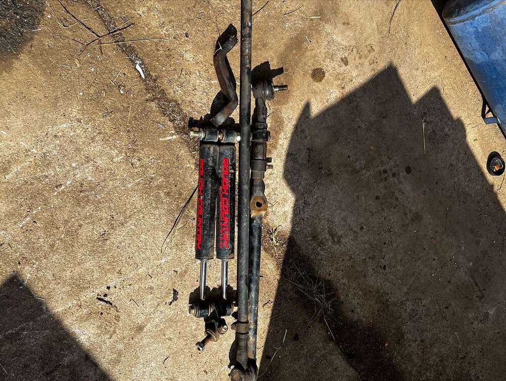

It drove a little better after that but there was still a lot of play so thanks to @tobaccoroad4wd for ordering me up a Currie Currectlync kit to go with the OEM pitman arm I had already grabbed from the parts store.
Old and busted
Fresh

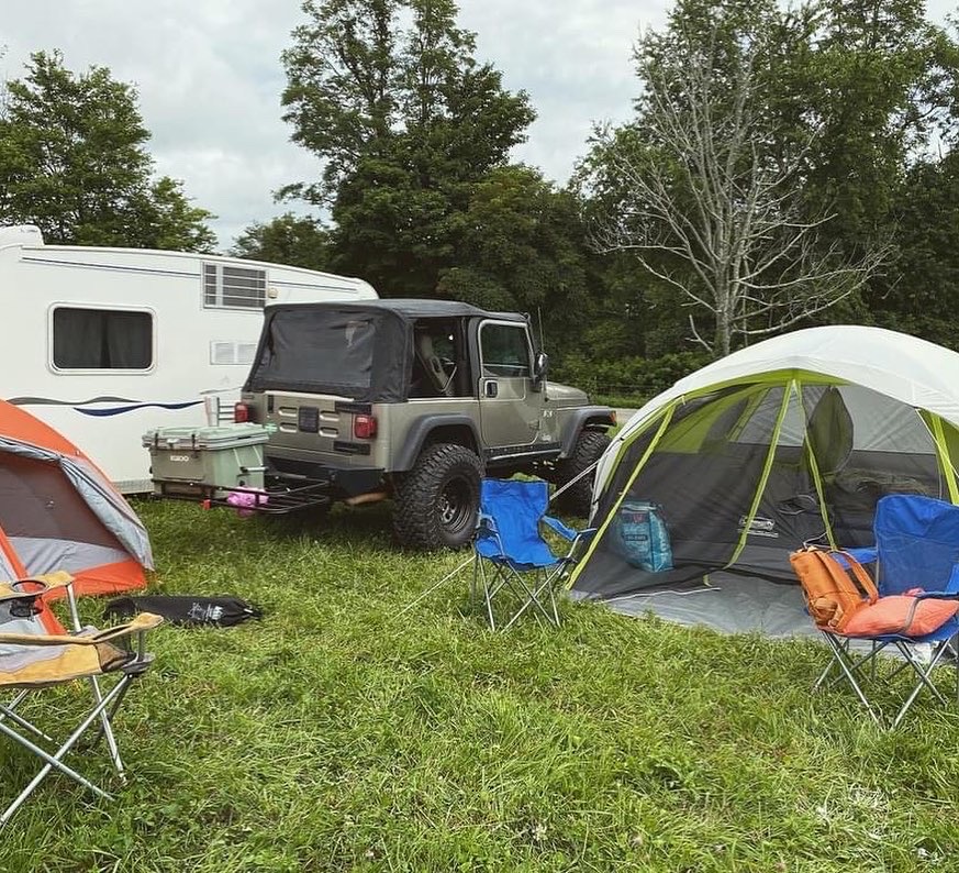

With things running properly now, focus was on the fun stuff we bought it for. Wheelin and weekend cruising. We loaded it up with our camping gear and went overlanding to FloydFest for 3 days to see some awesome music including Turnpike Troubadours

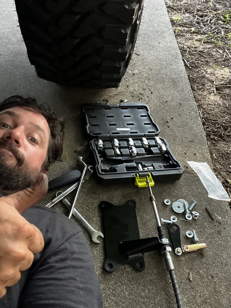

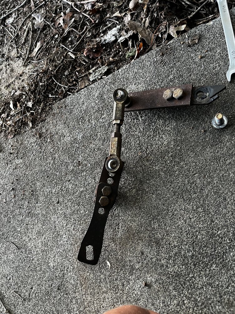

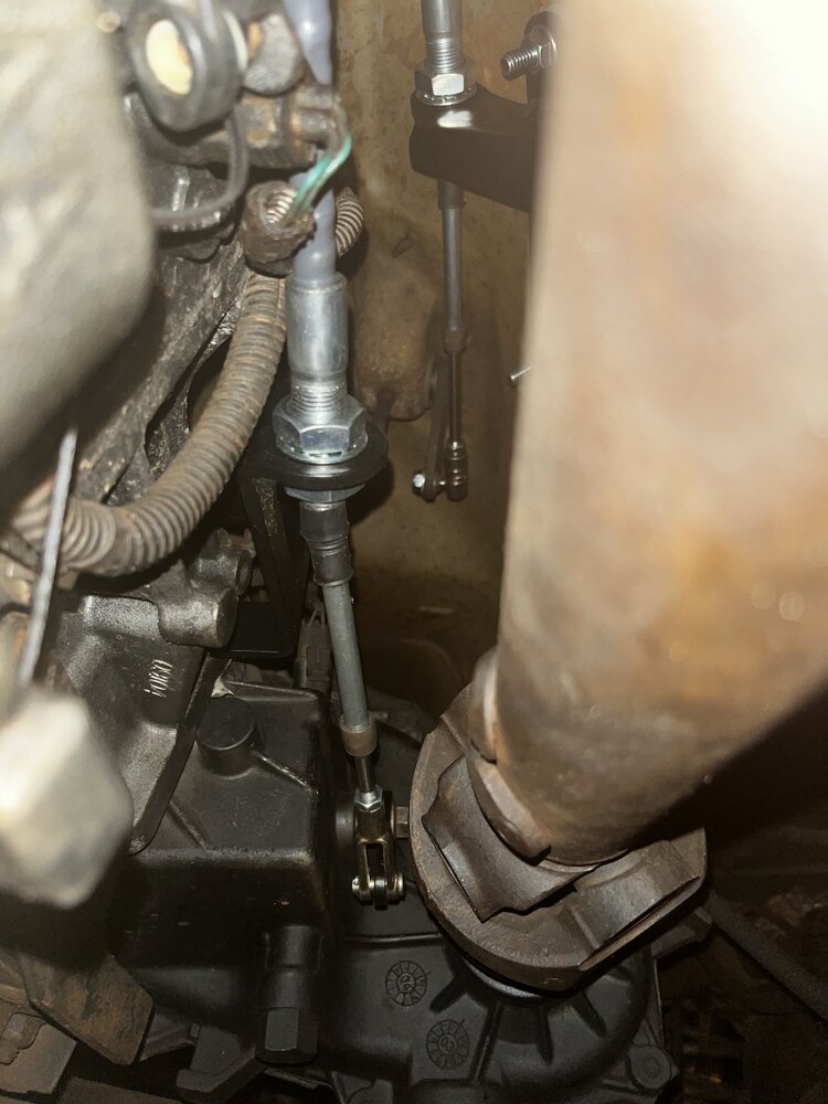

Leaving FloydFest in the inevitable downpour of a music festival, 4wd was used and low range wouldn’t engage. Not shocking given the tcase drop and the wonderful homemade linkage it was sporting.
That crap got thrown in the trash and a Savvy cable shifter went in.

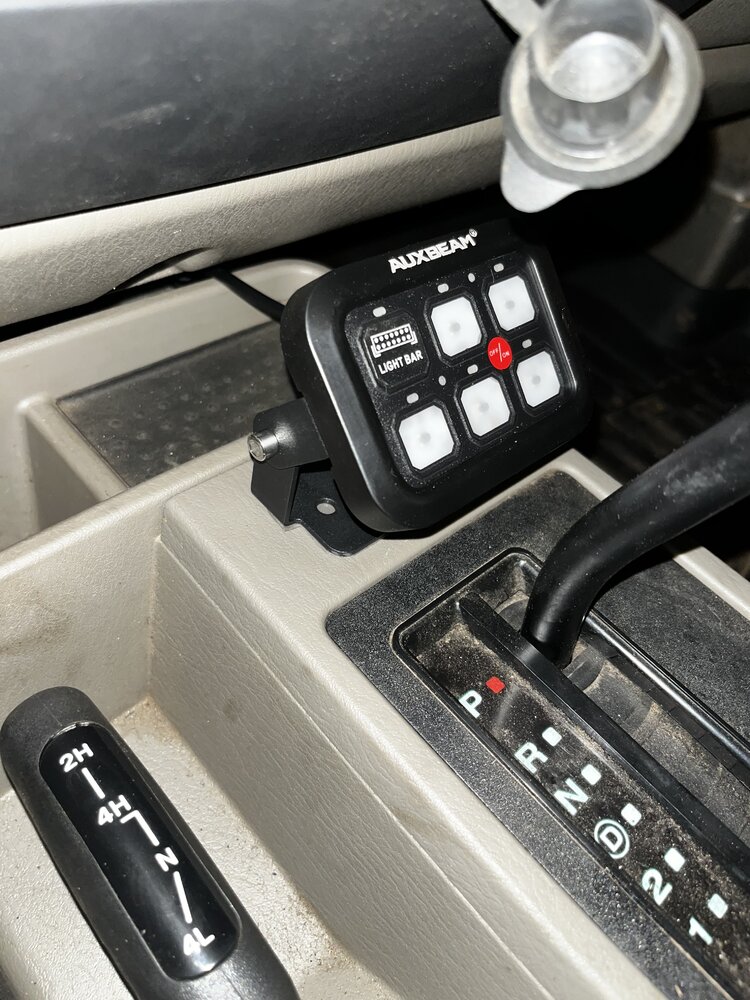

Next was addressing the miles of wire and switches that didn’t work for the Amazon LED’s. I ripped the pods and small bar off the bumper and left the big windshield bar simply because it’s there and the brackets had kind rubbed the windshield frame a good bit underneath. That got wired back into a relay pod and mounted on the console with room for more stuff should I add it later on.

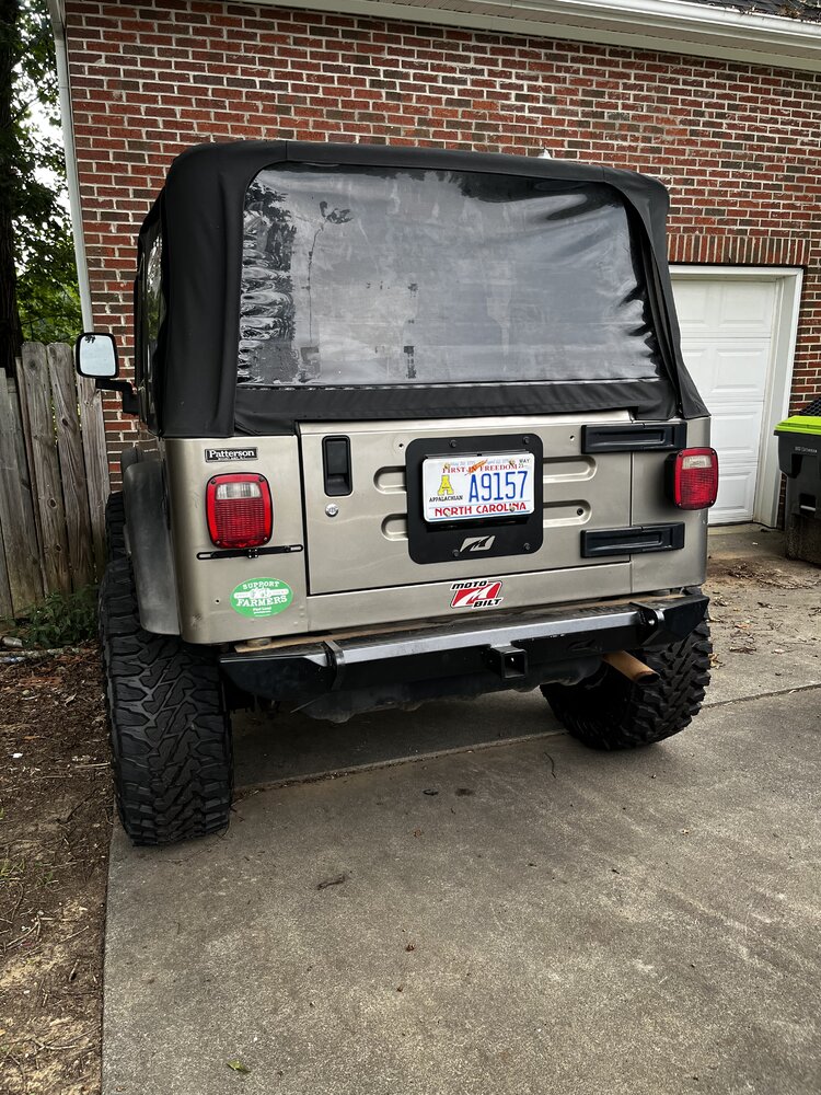

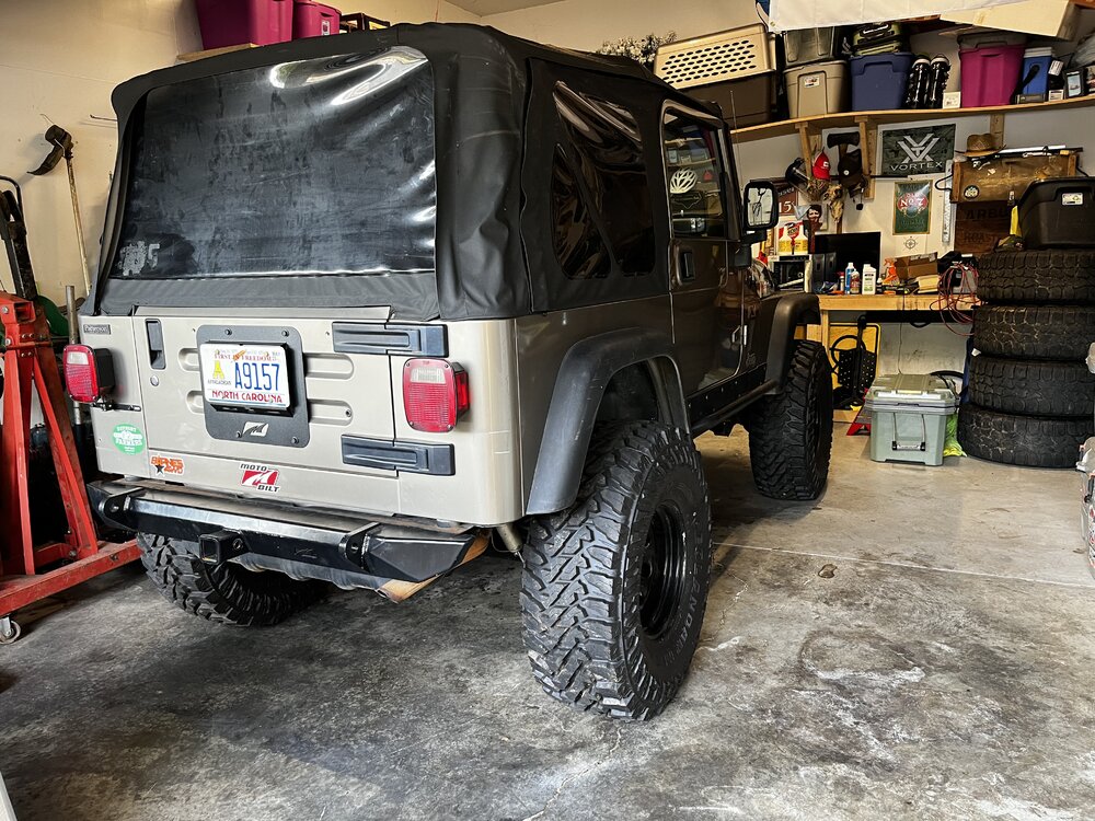

Removed the Chinese rear bumper in favor of the Motobilt unit that was originally on the CJ5 and cleaned up where the tire carrier was.
That’s how it sits now heading into this weekend’s wrench fest.

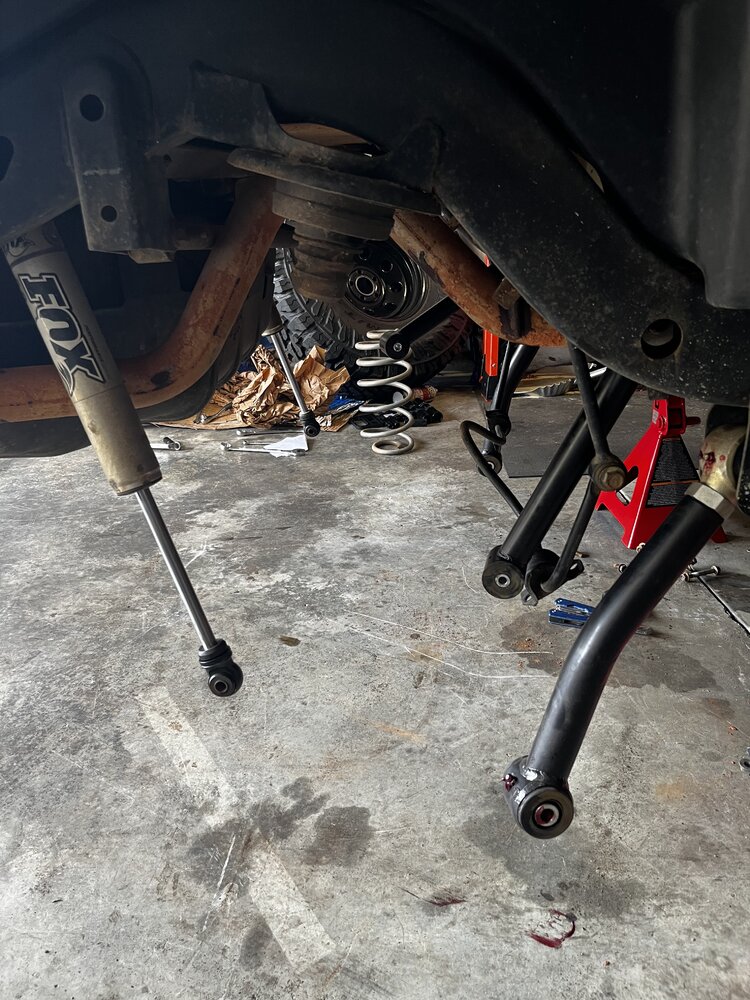

Spartan locker and chromos for the Dana 30 and some Core control arms since the bushings in the stock arms are pretty worked.

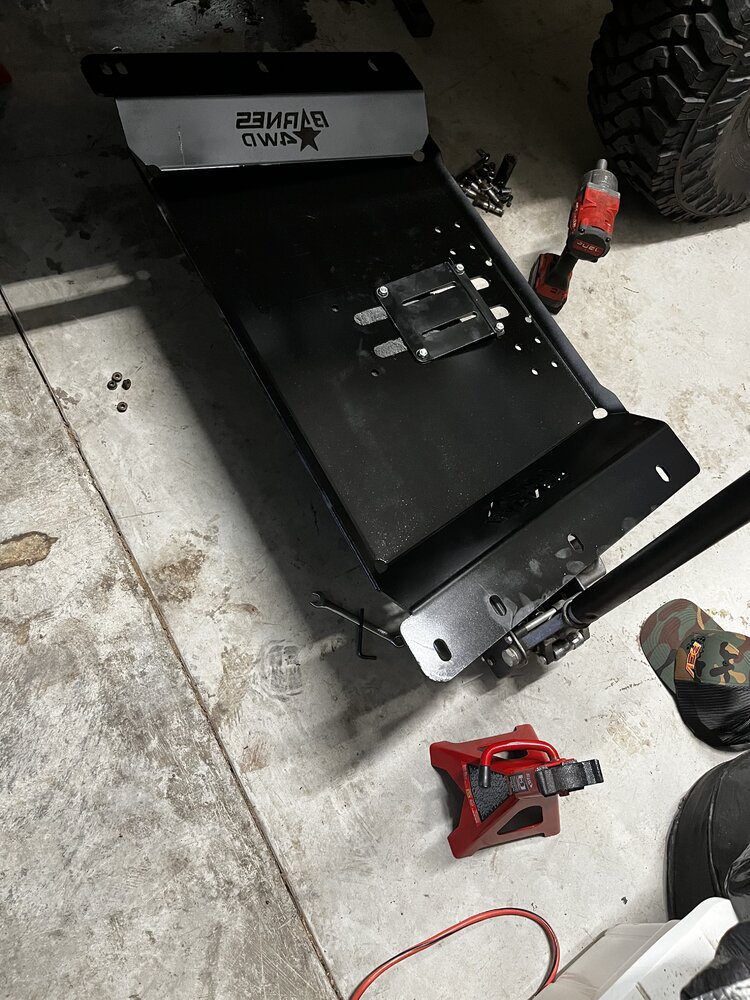

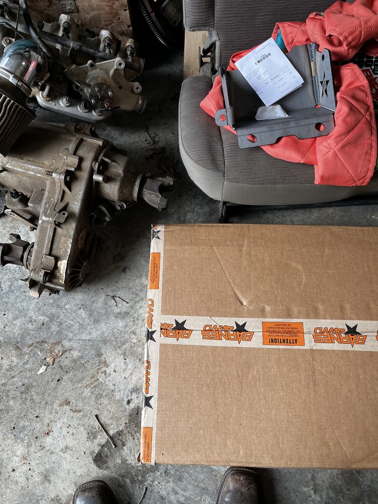

When I bought AdamK’s driveline for the CJ5 it had the 231 with an SYE. Currently there is a Tcase drop in place. That will come out and be replaced with a Barnes belly pan and the case swapped out at the same time. The intention is to get the belly pan over to the local powdercoater if he has a batch of black parts running next week. If not it will just get Kryloncoated.

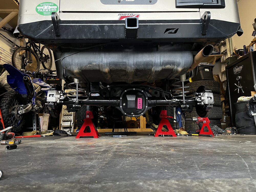

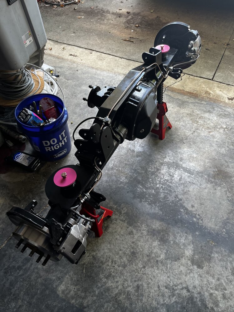

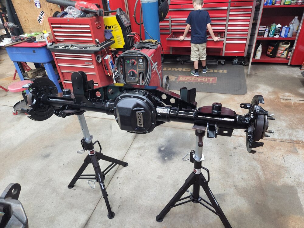

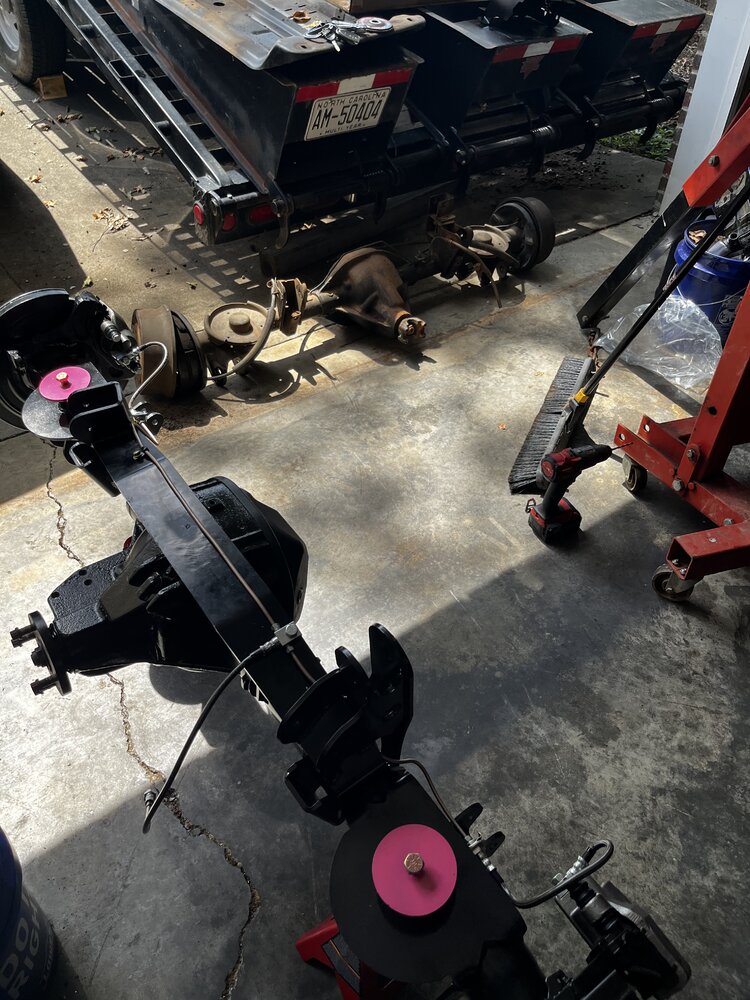

The 8.8 is currently at RevLimitFab getting fresh gears, a grizzly locker and artec truss. I’ll get it back, refresh the brakes and hopefully swap everything in over Labor Day weekend.
My .02 is to get a quart of black tractor paint and paint it nice and thick. Doesn’t hurt the wallet so much fixing the inevitable scratches with a .99 cent paint brush and the leftovers of paint.
X2 on the tractor paint. Make sure you apply it this thick
Brakes rebuilt and plumbed last night/this morning. I ordered the ECGS kit for the artec truss which was pretty spot on. I tucked the hard lines as close to the tube as possible and routed it through the trac bar bracket. Some 1/4-20 holes drilled and tapped into the truss and housing for all the clamps worked good.
The 35 came out fairly easy.
Did the short arm shuffle with some ratchet straps to get everything lined up and bolted back in.
I still have to finish running the new e brake cables and bleed everything but the heavy lifting is done.

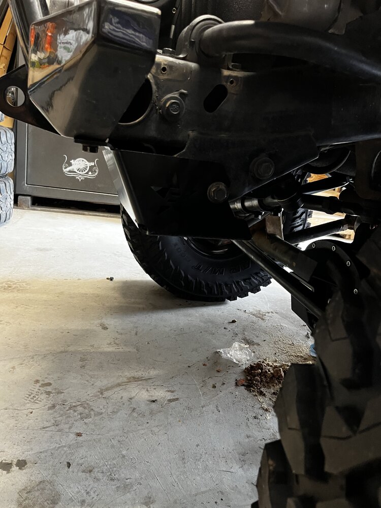

Everything is in, bled and torqued. Just need to send a flange to Oliver’s to be balanced with the driveshaft this week. Wrapped it all up yesterday with a Barnes steering box skid.

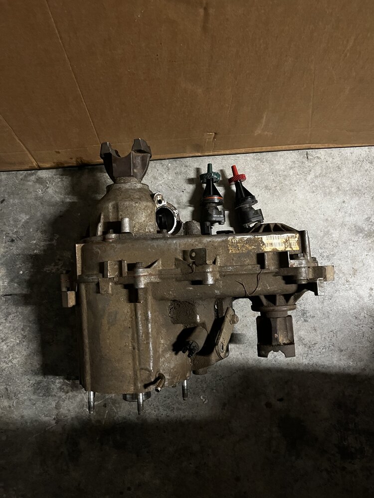

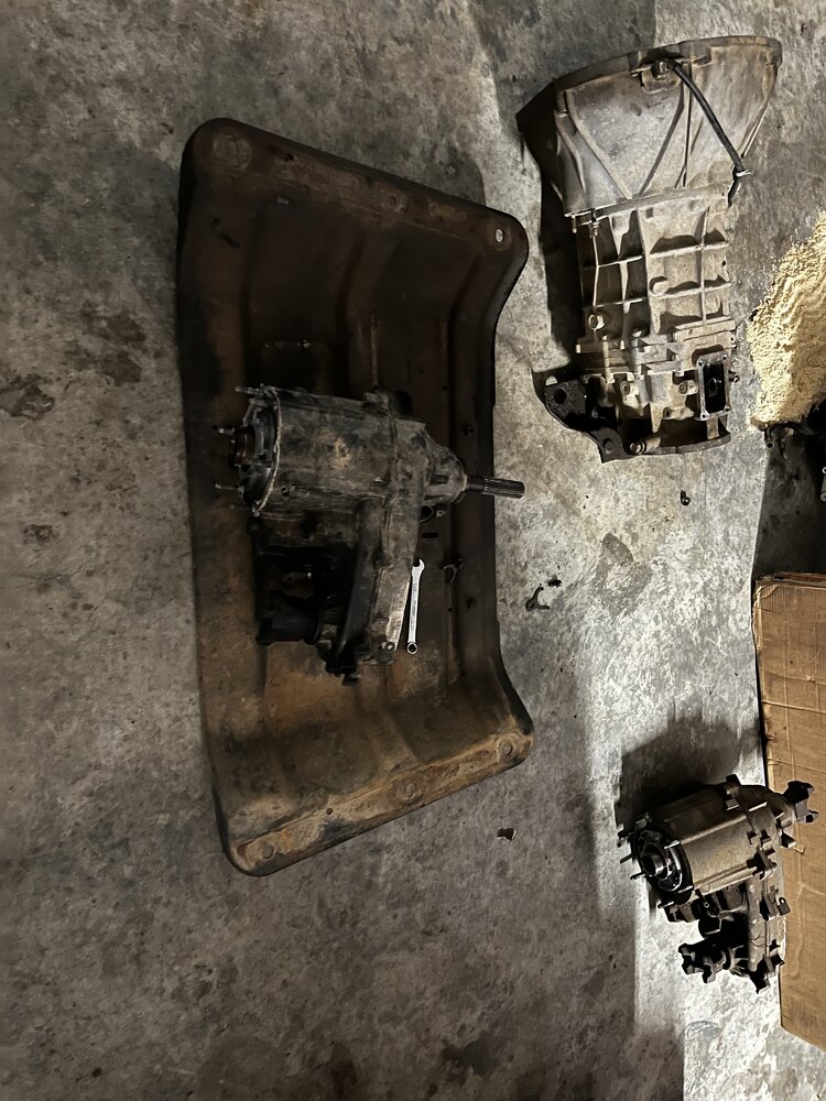

The 231 will be coming back out this winter. It’s a bit drippy so I’ll throw some new bearings and seals in it while it’s apart.
Jeep Liberty 231 fits yj tj Xj and most have never been shifted into 4lo they’re cheaper to get at a jy than a seal and bearing kit. The range selector and yokes are the only parts you reuse from the jeep
I actually have a Liberty 231 in my shop as well as the 231 that came out of this one. By the time I swap the SYE over I’ll have it apart enough to reseal and put bearings in any of them. I’ll rebuild one and save the others for parts.
