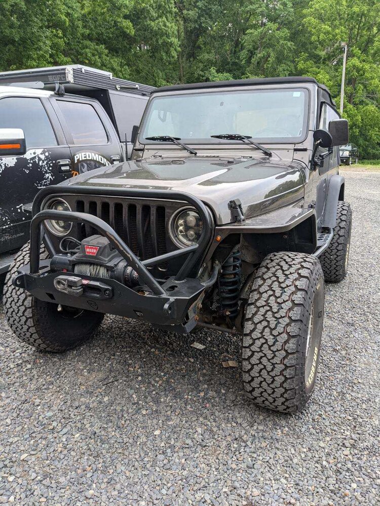

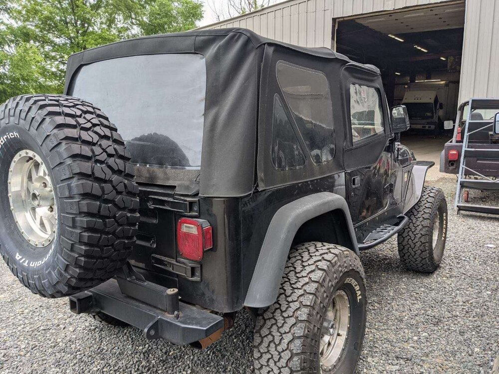

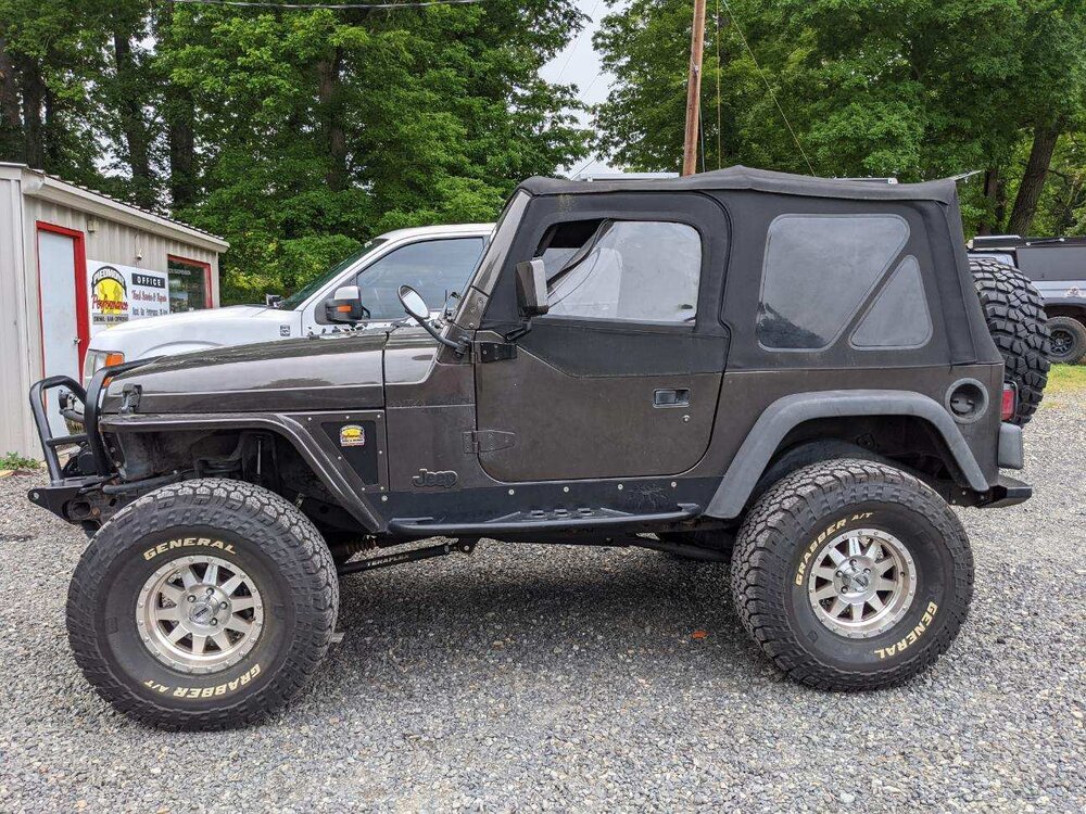

Middle of May I receive a phone call from my friend that I went to Moab with saying he had found me a Jeep. I asked about it and he told me that his shop had built it at the end of 2018. He said it was rust free and had a lot of quality parts he said the guy was selling it for a 1/4 of what he built it for.I said “send me pictures and info on it.” I asked why he was selling it so cheap and was told it’s had low oil pressure for years. They were just running 20w50 in the engine and it ran fine, but it would need a new engine sooner then later. I received these pictures….

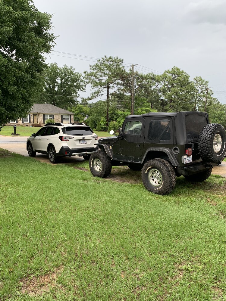

The pictures peaked my interest. I showed the pictures to my wife and she said “if you want it buy it.” As a guy that been married for more then a day, I thought this was a trick. After a few days she asked when the Jeep was coming home? I immediately called my buddy and said I wanted the Jeep. He called the owner and was told that the owner needed to keep it a few weeks to find a new vehicle. I agreed since I was leaving the next week to take my daughter to Universal Studios. When I returned home I drove to Greensboro with the check. I still hadn’t seen it in person yet. The guy couldn’t meet me that day so I left the check and drive home but not without receiving it’s invoice from 2018. I now knew everything that had been done to it. A few days later I got a call to come pick up my Jeep. I went up and it truly was in great condition. We put it on the lift and saw a rear axle shaft was leaking. When we pull the shaft it was bent so we put a new shaft that was laying around the shop in. It was time to do the drive back to Fayetteville. Leaving the shop it had a hesitation for a second and then snapped out of it. After that it drove extremely smooth. I drove it around Fayetteville and would occasionally get the hesitation again. So I replaced the upstream O2 sensor and it fixed the hesitation. Now it drives great. I named it Under Pressure due to the low oil pressure.

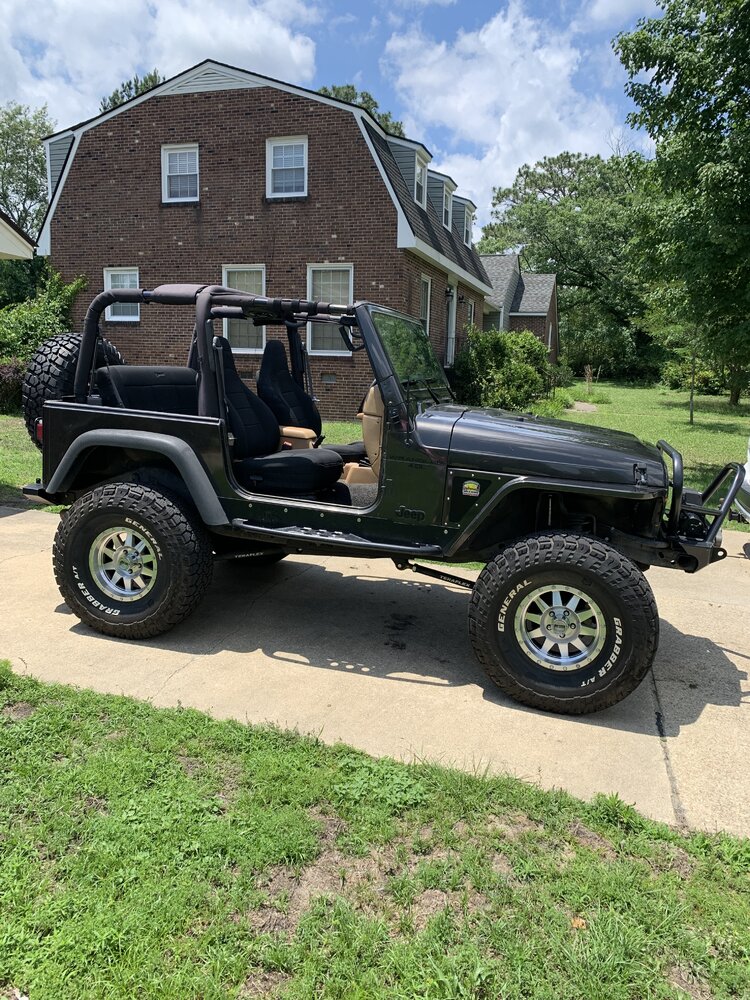

That brings us to today. Here is the list of what all has been done to it so far:
New top, method wheel, 35’s, Hyline read bumper carrier with swing out tire carrier, 4 in teraflex long arm kit, JCR front bumper, warn winch, poison spyder fenders, 4.56 gears, true trac in rear, pro comp led headlights, SYE with a Tom woods driveshaft, full bed rug kit, seat covers, black magic brake kit, painted mustang grey (was purple), poison spyder rockers, banks monster exhaust, banks header, and a lot of misc maintenance items.
plan going forward is rebuild the engine, 1 ton stearing upgrade, new rear axle to get rid of the 35, true trac in the 30. Rock hard roll cage, and seats with harnesses. This is all stage 1 of build just to get me back into the hang of everything.

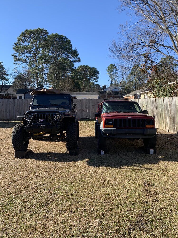

A couple of weeks ago I placed a order with golen to get a stroker motor. I was informed that they are 9-12 months out at the current moment. I said that’s fine and placed my order. Two weeks ago my FIL and I went to Uwharrie to ride 4wheelers. While there we met up with a guy that owns a shop here in Fayetteville. We started talking about engines and he informed me that he had a Tboned 98 xj. That got the wheels turning. Today I went to this guys shop and gave him a check to buy and deliver the XJ to my house.
Here is the game plan for what’s to come…. I have cancelled my order for the stroker for the time being. I am going to pull the engine and AW4 and drop into my TJ. I also found a Dana 300 that’s been converted to 4.?:1 with twin sticks already. That transfer will go behind this setup.

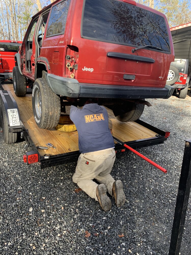

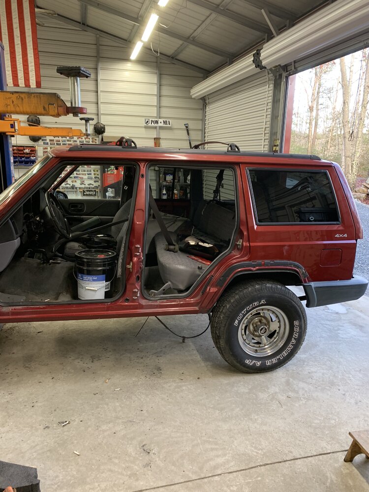

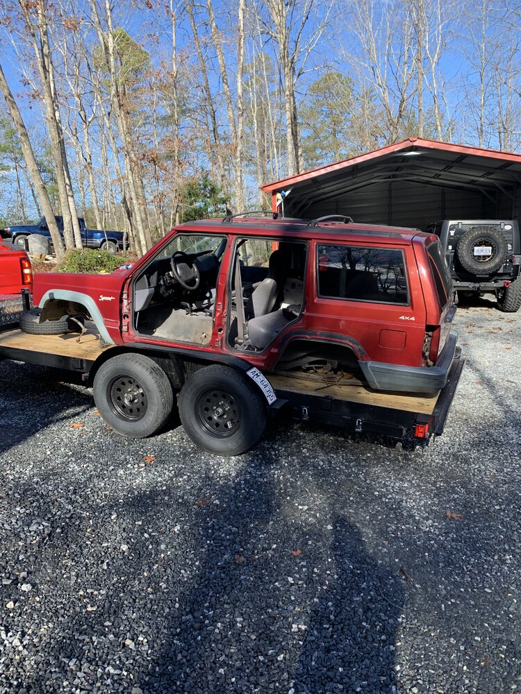

Time to do a update. Back in November I purchased a 98 Cherokee that had been t-boned. The Cherokee was delivered to my house where it sat until Christmas Eve. On Christmas Eve, @Mulishajoe and @jeepin' jen came and picked it up and took it to their house. The XJ was supposed to go to broken skull in January but they had a few setbacks and well weather was not permitting. I eventually got the call to have my Jeep at broken skull on the 16th of February. @Mulishajoe was nice enough to deliver after he got off work and the fun has begun.

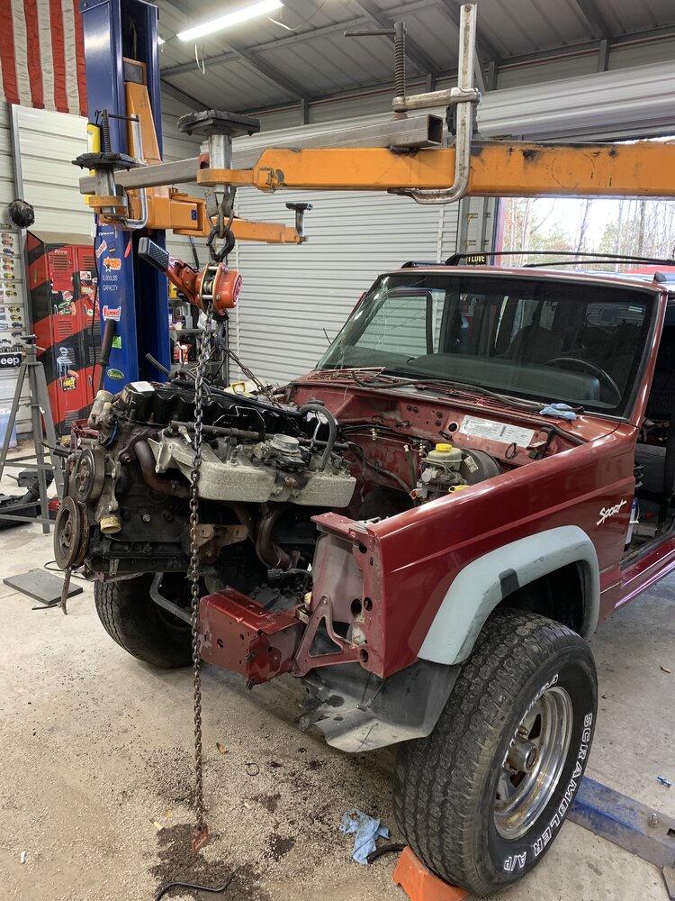

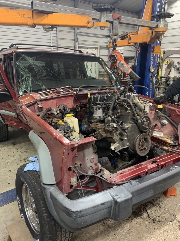

We pulled the XJ into the shop to begin removing anything and everything that was worth anything. We planned on a week for tear down but @Jason W. @josh$$ @k5-1402 and myself made short work of this thing. I believe I can speak for them that tear down on a vehicle that nobody cares about may be the most fun way to tear down a vehicle. “Oh that wire harness is in the way? Do we need it? Where is the sawzall?” May have been said. As my other post says if you need anything for a XJ speak now.
Tomorrow @Keith1138 will be helping me get my TJ to broken skull so we can start on tear down of it. Then it’s time to put it all together and finally after 4-5 years have a working happy Jeep again. HUGE HUGE THANK YOU TO EVERYONE THAT HAS HELPED SO FAR!!! I can’t wait to get on the trails this year
