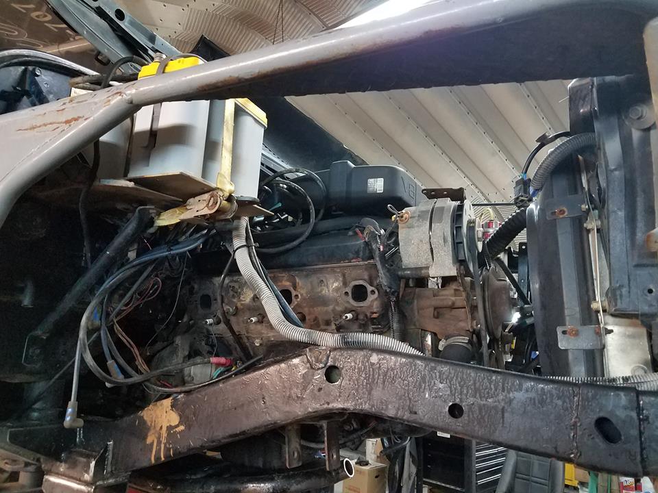

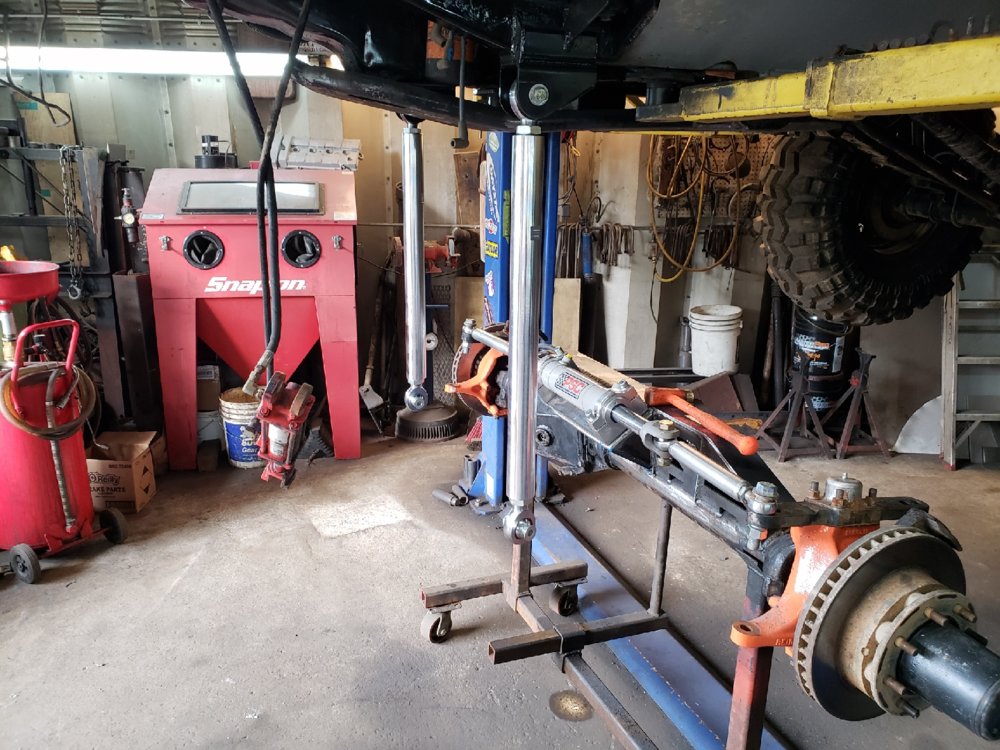

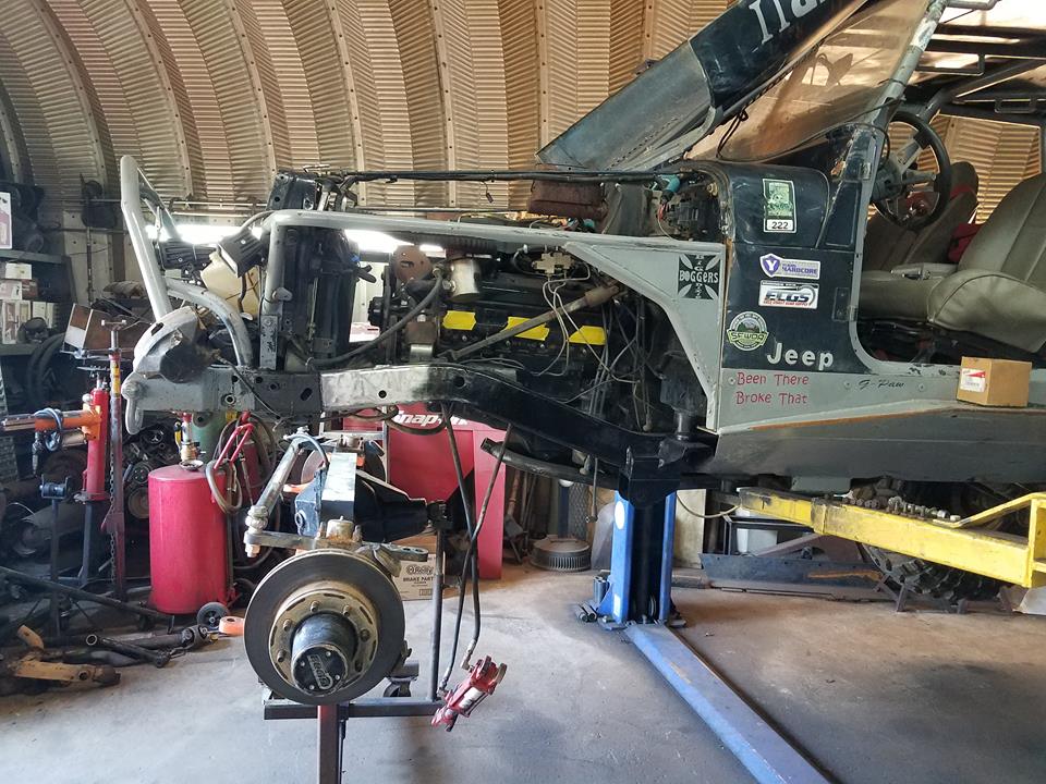

My Jeep UPNOVER II, will be going under the knife soon. Just after our July 4th ride. Chris Ellis @BUCKEYE PERFORMANCE INC. will be doing the build. The plan?
Full width trusses, on both axles, Double ended ram, Fox Coil overs on all 4 corners, Dually 14 bolt in the rear(swapping out my guts into this one), Aluminum Lower links, Heavy wall steel upper links, Not sure yet if it will be 4 or 3 linked in front, depends on clearances. Goal is to get it lower, stretch wheel base so tires are the first on the rocks, and last to go over a ledge.
I have already upgraded to Reid Knuckles, 43 stickies, Hydro steering and so on.

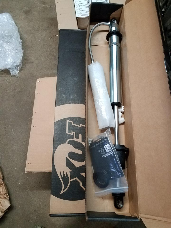

2nd to arrive is my Fox coil-overs, with reservoir.

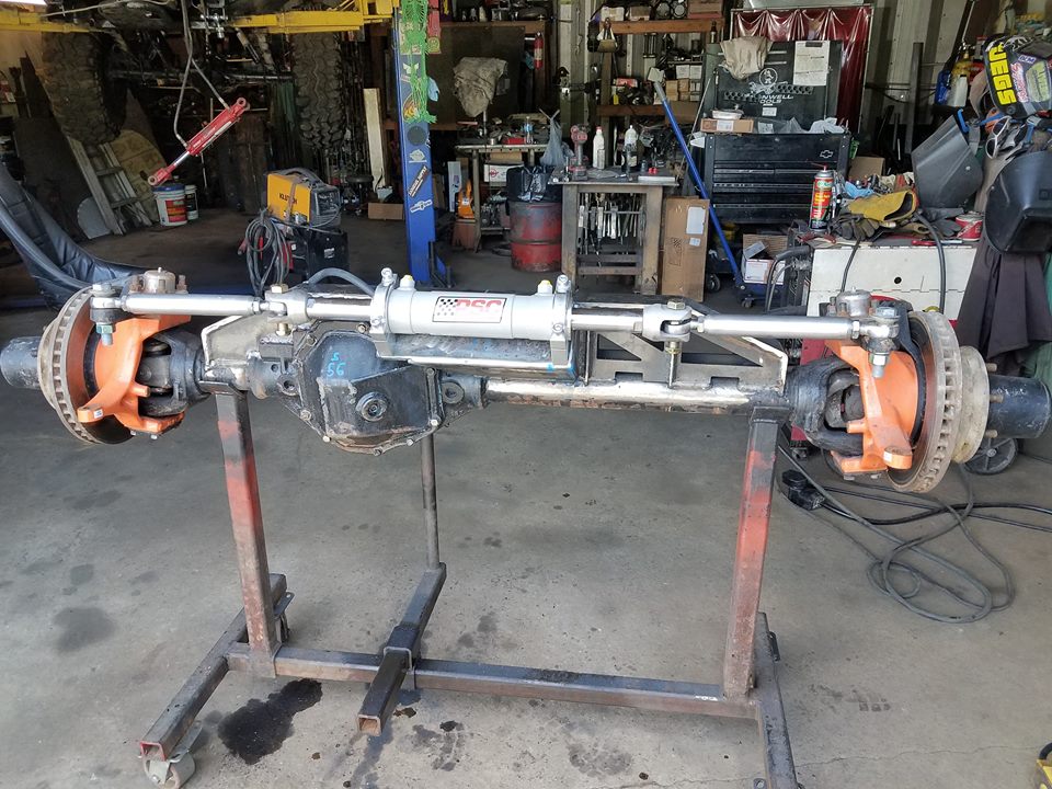

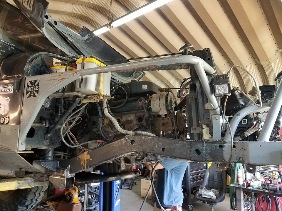

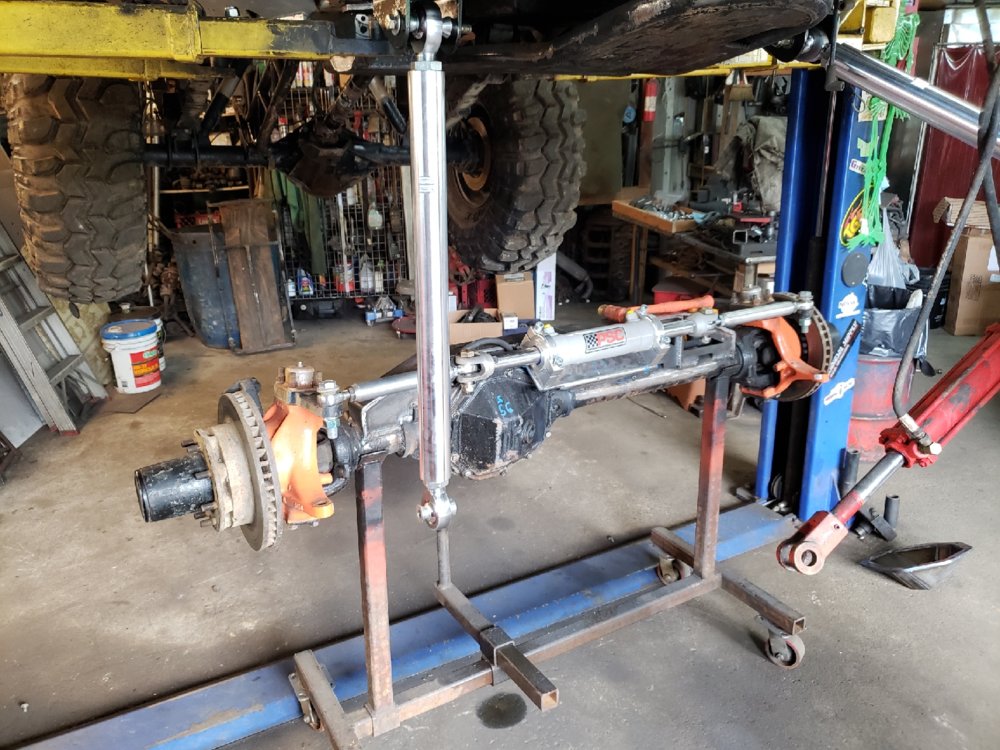

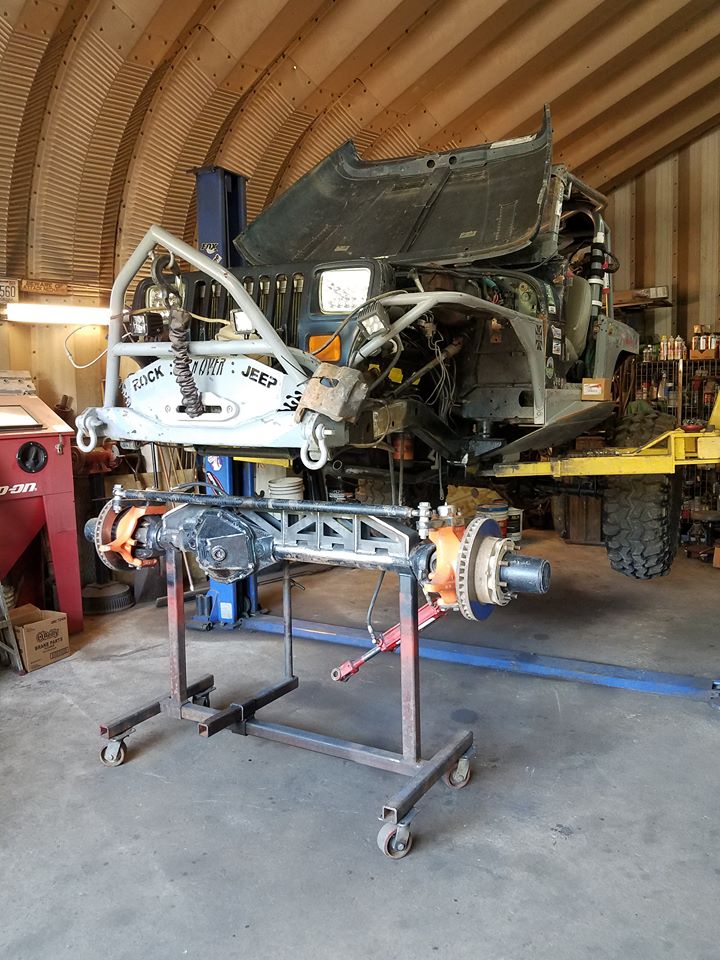

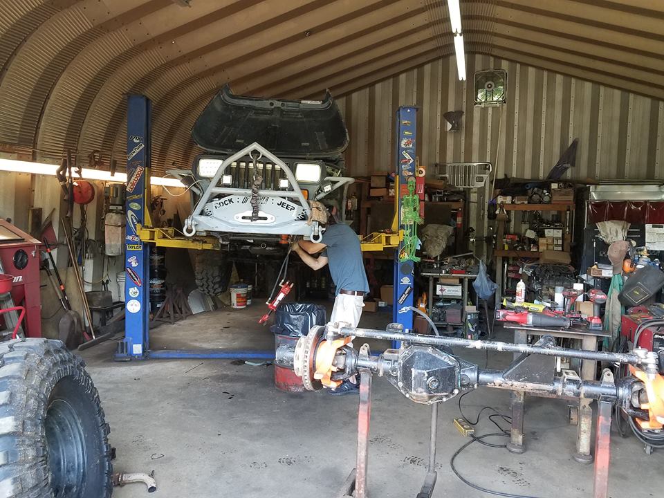

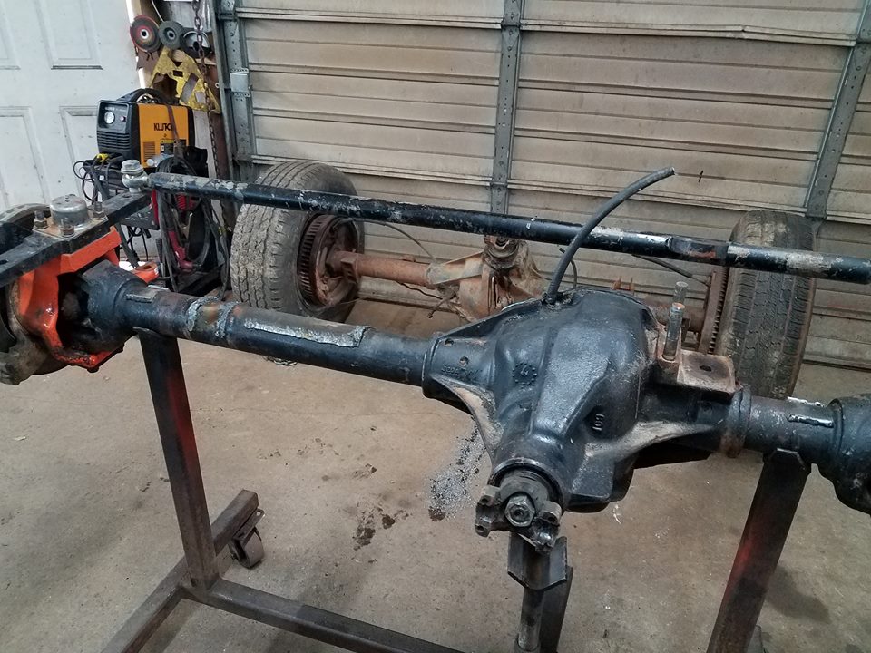

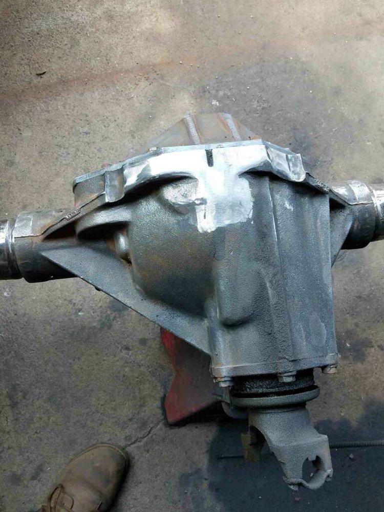

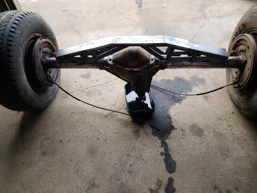

I took a trip up to @Barnes 4wd to pick up heims, tabs, trusses, and a 13 bolt cover for the rear diff. Links should be ready by Saturday. Getting some Custom aluminum lower links from Jason Sapp. Work started on it yesterday, from Lunch time to quitting time, Chris made some good progress.
