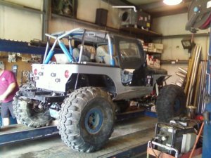

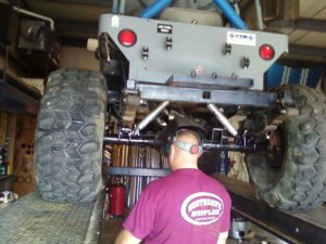

Took to Larry's Muffler Shop and it now has a nice low tone compliments of a totally new exhaust except for the re-used flow master.

Larry's Muffler shop up in Taylorsville. I called up there on Monday and made an appointment for 9 Wednesday. Woke up late because of a late night early morning at Chris's finishing up. I called and he said no problem. Bring it. Larry made a custom exhaust that works for the wheeling side of things. Nothing hanging below the frame, and it looks and sounds great! All this at a VERY reasonable price. Hard to beat those Bogger boys! And can't forget Larry's Mom, she is an awesome lady who will keep you on your toes with her wit and humor!

Here's a few pics of what it looked like when I got back from Windrock. Notice the grass hasn't been mowed, LOL not enough hours for mowing, working on Jeep working, and sleeping at a friends garage
