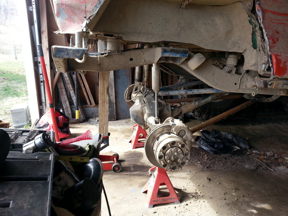

Here's a before pic.
When you say swap sides wouldn't that put the brake line going over the rotor? Maybe I'm confused.

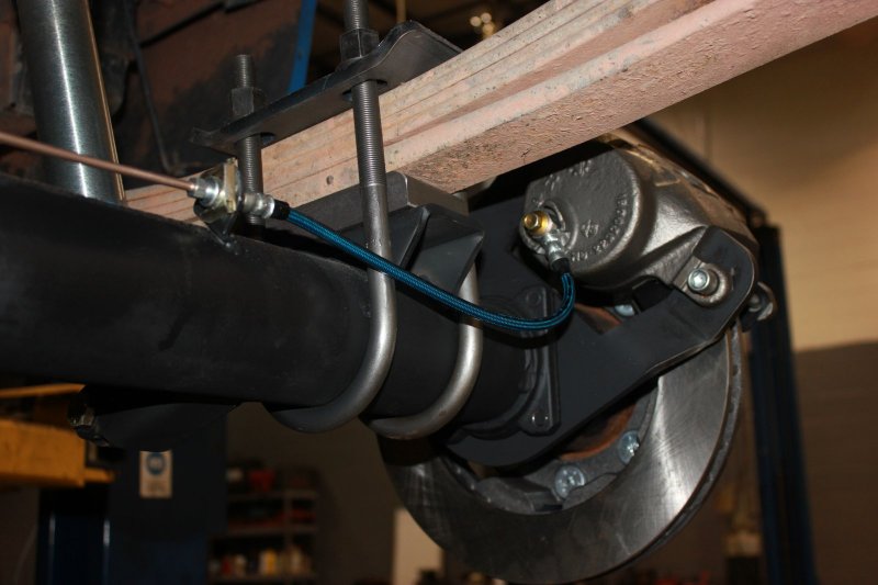

my calipers are on the back side of the axle with the bleeder facing up, looks as if you can do the same. You will just have to switch the calipers side to side to get the bleeder screw to face up
