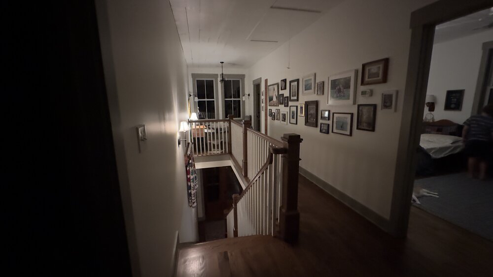

Upstairs AC in our new house cant keep up on hot days. I assume I'm fighting physics and all the cool air is just going down the stairs, because downstairs is always comfy even when the thermostats say the temps are the same or at least pretty close. Anybody else have/had the same struggle? Would a door at the top of the stairs help? Only have thin curtains so nothing that really blocks any heat gain from those so I've been thinking of getting some blackout shades to see if they help. I think its 680 sq. ft with a 1.5 ton unit.

With an open stairwell some air will migrate to lower levels, but it is often met/combatted by rising higher temp air from the first floor. I would put air migration as suggested in original question lowest on the list.
