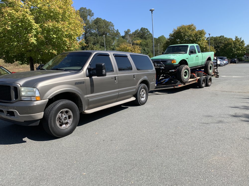

Seems like a reasonable price if its in good shape. I love my V10 excursion. 275k on the clock. 12 mpgs around town and 9 pulling the Ranger around. Check for rust in the rockers behind the rear doors and worn out suspension bushings.
