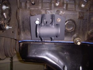

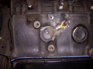

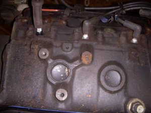

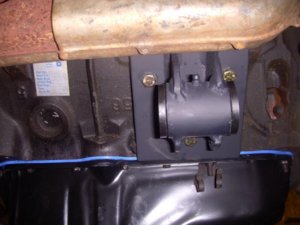

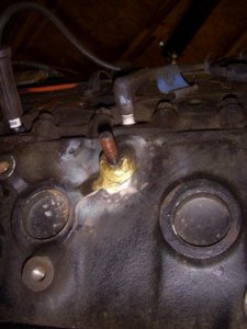

Motor Mount fixed
Well today I took my motor over and got a stud welded on the block where my motor mount goes. I am r eal pleased with the job and ready to start install. Here are some pics. of the job. I should get some good progress done this weekend.

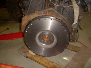

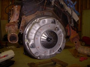

More progress

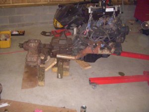

Here are the latest updates on where i am. We got alot done this weekend but still have a ways to go.
Installed the flywheel...
Installed the clutch.... (first cluctch I have ever done.. Not to hard, hope it works!)
Installed / modified the manifolds..(may have to go with headers)
Got both motor mounts on and bolted up.
Installed Bellhousing....
And last but not least all together motor/bellhousing/tranny/t-case.....
The motor is currently in the land crusier but not in the exact location it needs to be. Found that the rear cross member needs to be cut out the t-case output is hitting.
Once I get this cut out just need to get position in the correct spot and get the motor mounts bolted down!
I will be posting pics of all this as I get time.
More to come!!!

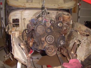

Motor in!!!
Motor in but not in exact spot but getting close!
I will post pic of the cross memeber that is hitting the t-case.

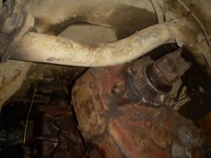

Cross menber issue
Here is the LC cross member that is in the way.
You can see the output of the t-case is hitting the bar.
Plan is to cut off this week.

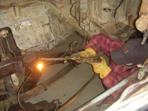

Little more progress
Well I got the motor back out and took the motor loose from the bell housing so I could change the shift fork. Found that I had the shift fork that would not work with my slave clyinder. Fork was ordered from advance adapters.
Also with the motor out I got the cross bar cut out in the LC.
I will have the new exaust mainfolds on Tuesday that I got from Ebay. Had to get new manifolds so the exaust would not dump out on top of my slave clyinder.
