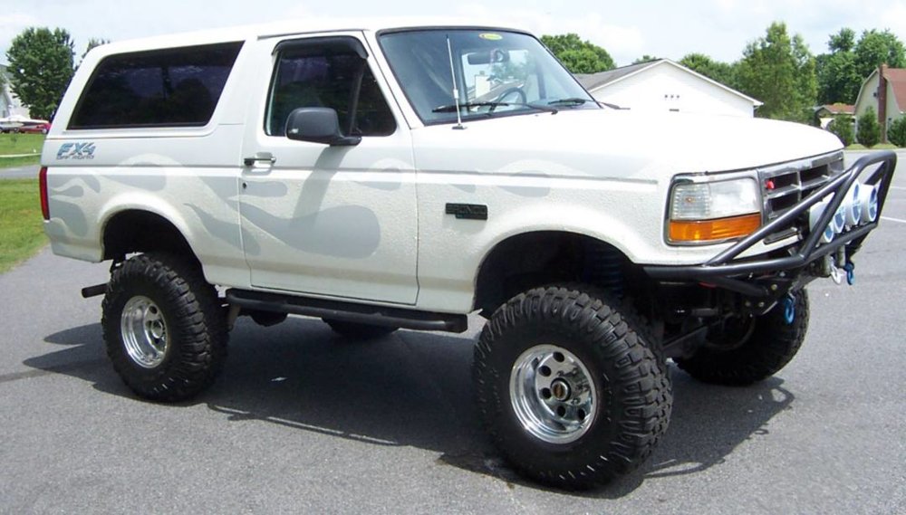

Just confirmed with dad, it is a 1992, I was mistaken. The front end looks just like @CasterTroy pic above.
If it looks like the bronco above it is a whole different truck. Never was a fan of 88-91.
Castertroy I remember you had one and he had one. Maybe his was blue.

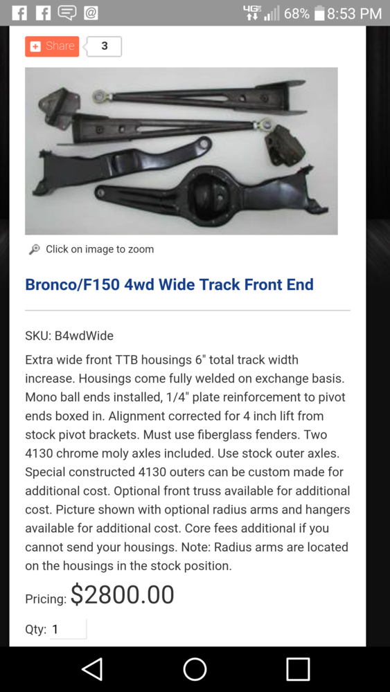

Spend some coin and get the scissors replaced with a long travel set up. Trailing arm the rear and that long bed would be tight.

Camburg and some others have serious long travel kits. Ditch the bench seat. Add some fiberglass and rip it!
