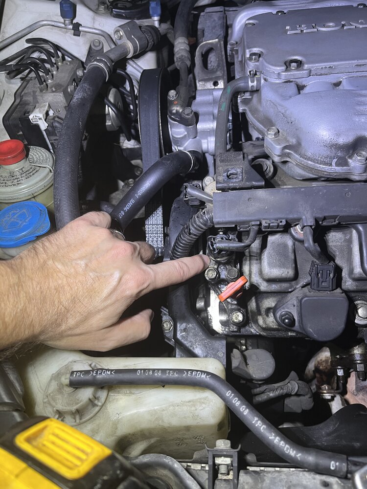

Pretty common for them to leak. They also have a VCM valve by the dipstick that leaks on to the alternator.
That’s this guy over here right? That aluminum housing.
Yep. There are two gaskets in there. Always a good idea to change them before they start pouring oil on the alternator.
Heat cycles turns that rubber into plastic basically. As with the grommets on the bolts which then loose the hood down force.

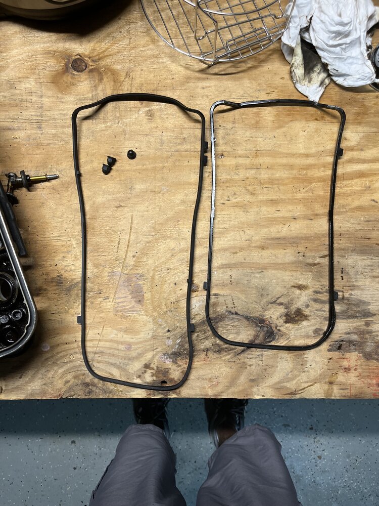

One thing is not like the other…

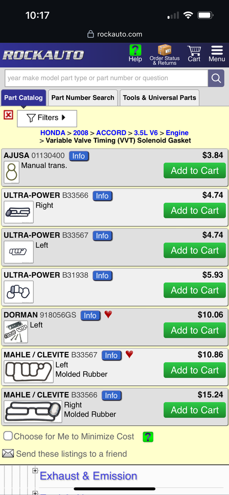

UPDATE: SOB! Front and rear are different and I picked the wrong one from RockAuto thinking I could save by buying just one side instead of a kit with both sides.
One on the left looks like the cam carrier cover gasket for a K24, not a J35. Probably a wrong pull at the parts house. I ran a couple of Honda/ Acura shops in in central NC for a friend of mine for a while. Parts manager and techs always insisted on Honda genuine parts for gaskets, and even more so for ignition parts. I use mostly Fel-Pro stuff on any older American V8, Victor-Reinz/Mahle/Clevite on late model GM. My 335k 03 Accord 2.4 still only gets Honda parts. For the VTEC solenoid screen/gasket I used the Honda stuff but in a pinch might go with another brand, just can't say how they would hold up over time after install.

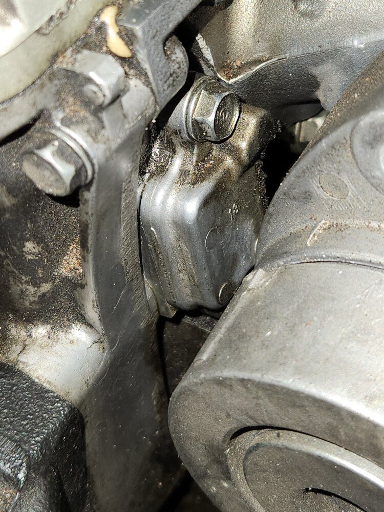

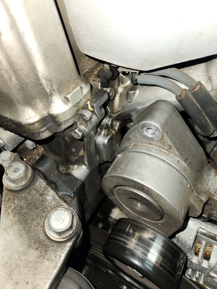

Speaking of leaking Acura's, my 07 TSX 275k miles has developed a leak here at this little cover plate. Any thing special I need to know? Looks to me just RTV.
Gimmie a few and I'll get a part # there is a screen there
15845-RAA-A01 spool valve filter
More like my dump ass ordered the rear valve cover gasket instead of the front valve cover gasket. RockAuto had them were you could order separately for $16. Ended having to run to Oriellys and get the full FelPro kit for $60.
Oh well, done now anyway.
Thanks man. Glad I asked. Anything else I should change while I do it?
From looking at the pic it looks like the water pump is new. Your valve cover gasket looks kind of grimey to me. If it was mine, and you haven't already, I would change the spool valve filter on front, vtec gasket on back, and the valve cover gaskets at the same time just to clean everything up. But you can absolutely just change the spool valve filter and be fine.

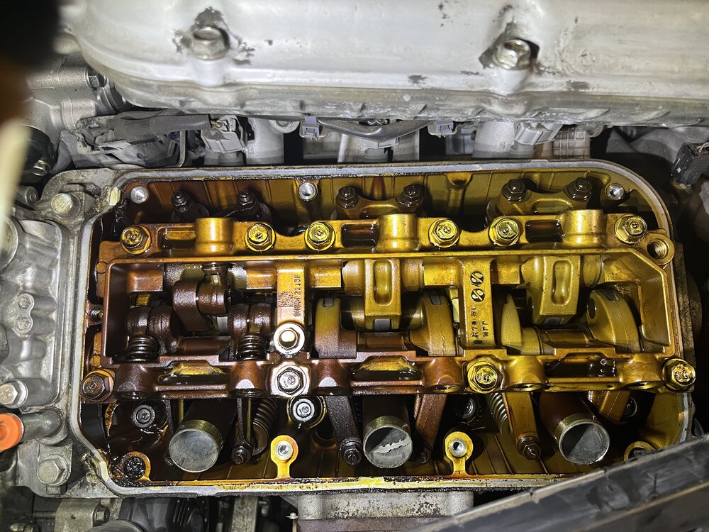

Got all three of these changed. Man that vtec gasket is a pain in the dick to get to. The valve cover was definitely leaking more than i thought it was. Thanks for the information.

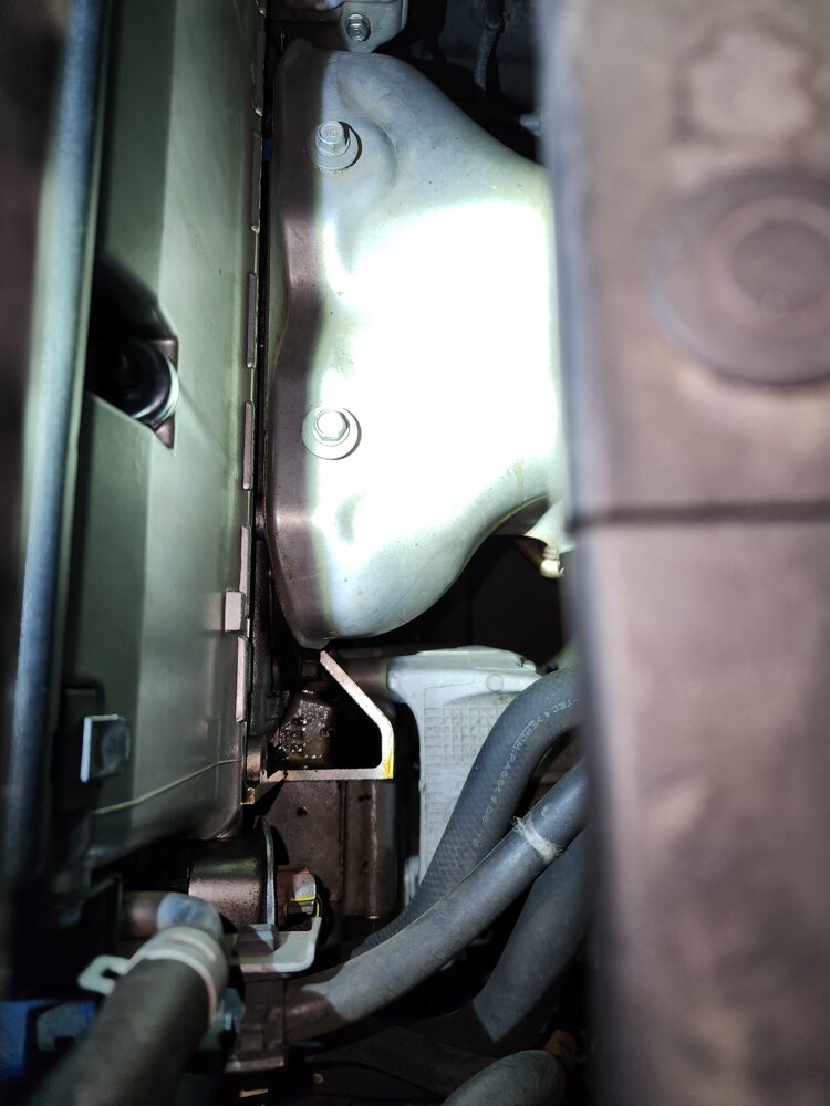

Well fuck me running, valve cover is leaking from the drivers side back corner now. Luckily Acura built this catch basin. Guess it's going to have to come back off. Tried snugging the bolts down a little more but afraid I'm going to strip it if I go any more.
