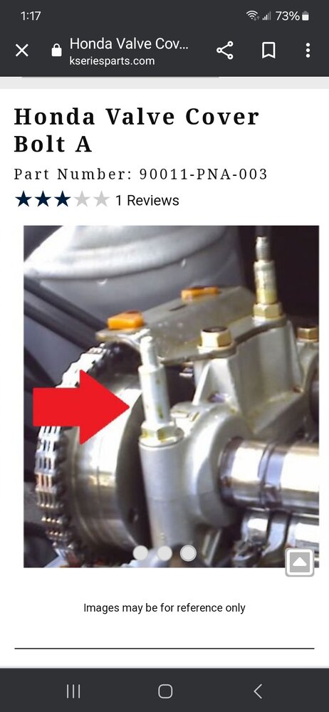

ncsutj Well-Known Member Joined Mar 20, 2005 Location Concord Jan 20, 2024 #26 @RHSCTJ do you know what the torque spec is for this bolt? Attachments Screenshot_20240120_131729_Chrome.jpg 60.3 KB · Views: 125
RHSCTJ Well-Known Member Joined Jul 1, 2008 Location ROCK HILL, SC Jan 20, 2024 #27 ncsutj said: @RHSCTJ do you know what the torque spec is for this bolt? Click to expand... Off the top of my head I would say 16# I don't have a way to look it up other than Google right now
RHSCTJ Well-Known Member Joined Jul 1, 2008 Location ROCK HILL, SC Jan 20, 2024 #28 And use grey rtv on the gasket where it angles up opposite the timing chain.
