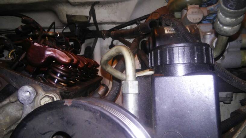

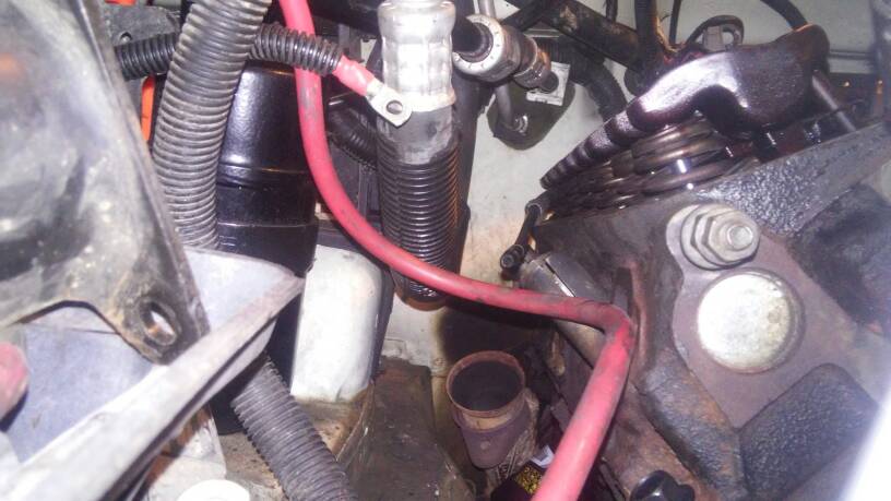

So I put my push rods and rocker arms back on, however I noticed that the passenger side ones are all in the same position. The driver side ones are not, except for 1 & 7 (which is the way the passenger side ones should be). Do I need new valve springs or did I goof something up? I torqued the bolts down to 21 ft/lbs per the fsm.
Sort of, yeah. Like on cylinder one, since its at tdc, both valves are closed. Other cylinders are at the various stages of one valve being open, following the cam lobes. Those springs would be compressed with the back of the rocker where the push rod is being higher up.
Something isn't right. Did you pull the lifters out?
What motor is it? I'd check to see that the lifters are right. There isn't a spot on the cam that every valve is closed. Either you have a lifter issue or your pushrods are to short or some other weird crap is going on. Maybe lifters need to be primed or pumped up.

5.2 magnum in a 95 grand Cherokee. I ordered the lifters/cam from rock auto, so hopefully they're right. The push rods are original. I didn't roll them on the flat concrete in the garage to test the straightness, but they looked good.
