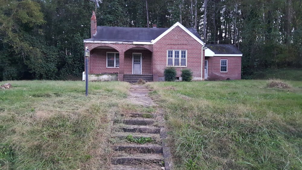

Back in Sept., we bought 2nd house for my step-son (need him out of our basement!).
Quick specs: 4BR, 1bath, kitchen, huge LR, DR, & full basement built in 1949, poured concrete foundation and brick, "finished" attic (in between the trusses), and a 17' x 13' addition (was her "beauty salon") added in the '60s on a slab. Plaster walls (decent shape) & Hardwood floors (rough) in all room(except addition, which is slab & clear pine paneling). Ancient oil furnace with an even older backup coal furnace, plumbed into the same plenum/ducting. Shallow bored well (39' deep).
Condition: It had set for vacant for 6-10 years, so lots of issues and aside from very mowing, grown up = jungle. There were several roof leaks, mainly due to little/no flashing on chimneys/vents/etc, but some tree damage on the addition. The wiring & copper plumbing had been roached by crackheads. HVAC & pump/tank trash. Due to water intrusion (no gutters, poor grading, etc.), there was about 25' of the band joist turned to dust. Several long time water leaks (under kitchen sink & wax ring under shitter) rotted all the way down thru the sub-floor (1"x4" on the bias). 100% of all the original doors, clear pine molding, etc. intact and unpainted.

This was Oct... prior to mowing (12"-18"), weedeating, a few truck loads of junk hauled off, the roof/gutters/grading...

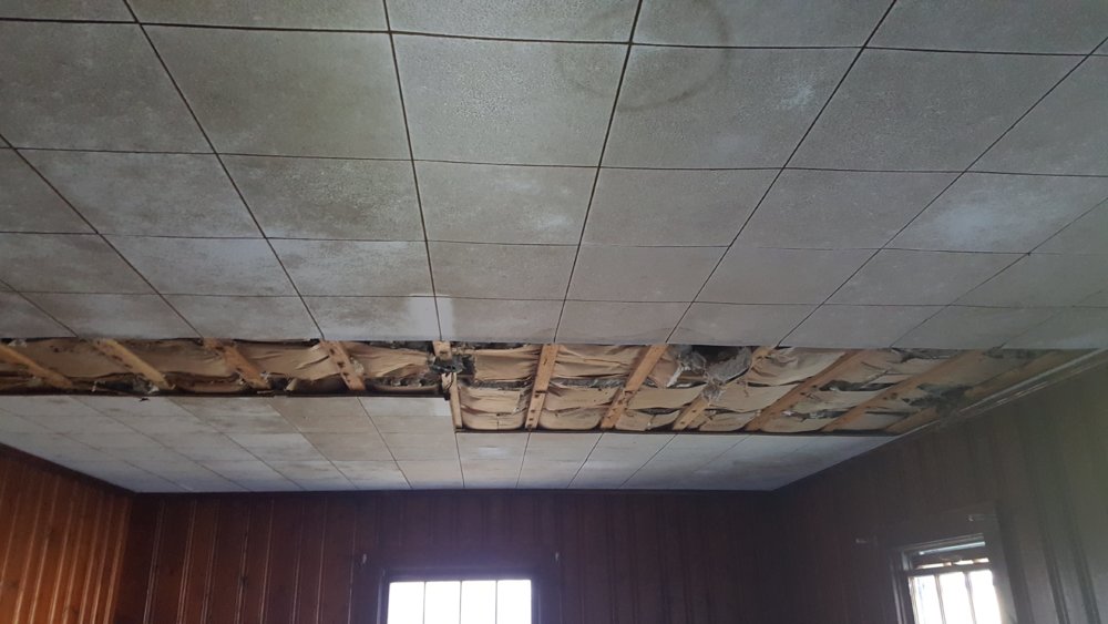

The addition... as you can see, pretty ugly, stained, & warped (likely contained the ugly "A", and why I wasn't sure painting it would help. We yanked it down (with proper PPE) and hauled it off
It's stripped with 1x3s on 12" centers and there's some very old batted insulation (says 3") and part of my most pressing questions:
#1 - We don't want drywall or suspended ceiling and we're not looking to spend a mint... so what are some inexpensive options for the ceiling?
#2 - The insulation is negligible... the bottom of the roof trusses are 2"x8"s. Thinking about dropping R-30 in-between the trusses, maybe pulling the paper off the existing 3" and laying it longways over the R-30? Or is is worth the effort for so little R gain?
All joking aside, very high likelihood that ceiling contains asbestos...respond accordingly.
Maybe? Hypothetically, Tyvec suits taped at the cuffs/seems, NIOSH P-100 particulate masks, goggles, and a LARGE fan blowing out the door when pulled, stuffed it into bags, and hauled off... would be a great idea. ;)

For the record... ALL the ceiling tiles are GONE.
We're considering drywall, but afraid there may be enough "swoop" in the joists & 1"x3" stripping/nailers that it will look like ass if left smooth (without popcorn/texturing << and that ain't happening).

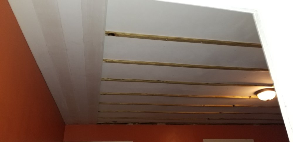

We opted to do a shiplap ceiling in our living room after the smooth one cracked down the middle. It's an older house & I'm not sure the builder owned a level so I didn't want to mess with trying to repair or replace the drywall. We just left the cracked ceiling & added furring strips. It wasn't the cheapest option but it went up really quick & looks great!

For the ceiling, throw up some drywall and be done. If you are worried about it looking warped from sagging ceiling joists, fir in some new 1x3 and use that. Like @braxton357 said, blow in some insulation when done and roll on.
We're beginning to lean that way... but still exploring other options.

re: unlevel ceilings looking like ass - we had this problem in a former house basement. Rolled on the ceiling texture paint that gives it the "popcorn" look, THEN gave my wife a small broom, which she used to make swirls in the texture while it was wet. End effect was that it looked kinda neat AND hid the uneven ceiling very well, you couldn't see it at all. Key was SHE had to do it, so the swirls were really random and uneven, not all same sizes, direction etc. I can't force myself to not try and make it look orderly lol.
Agreed on the wavy ceilings...
The old ceiling was fine (a few tiles sagged from damage), but overall the stripping may very well be fine.
If we go with drywall, there will NOT be any popcorn!
