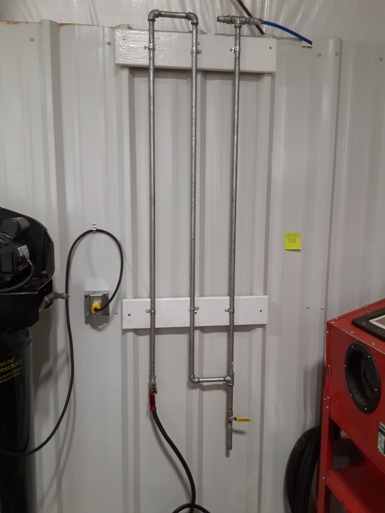

Real close! lol
Here is my set up in my new shop. It wont stop incoming moist air into the compressor but the hot air coming out hits the cool pipes and condenses the moisture before going into the lines.
