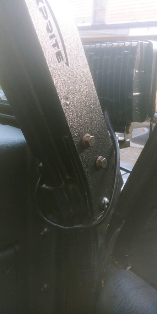

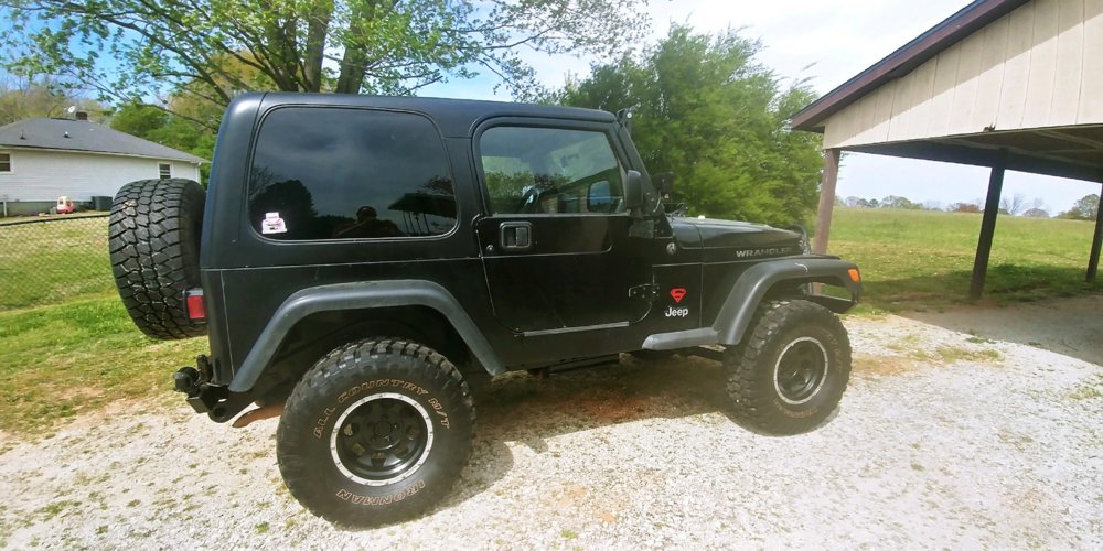

Hardtop with full doors. Anyone recognize this jeep? I don’t know where he bought it but it has 250k miles or so.
Hardtop with full doors. Anyone recognize this jeep? I don’t know where he bought it but it has 250k miles or so.View attachment 266107
Hmm... That throws a wrench in my ideas.

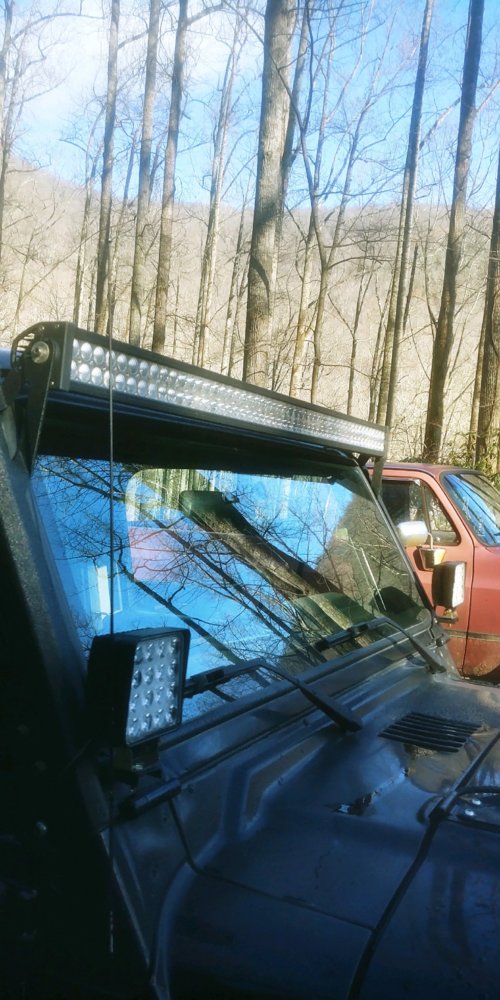

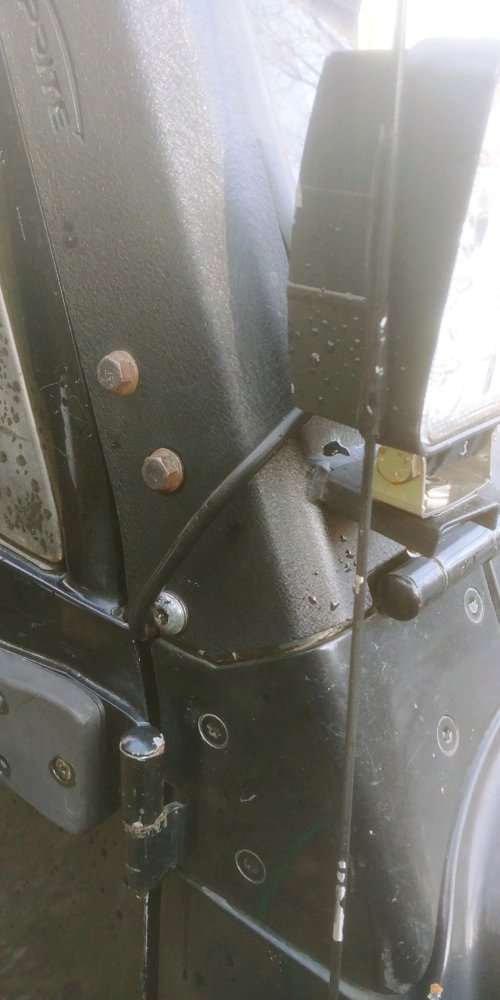

What about all that light bar bullshit? Did somebody drill a hole where they shouldn't, or run the wire in through the door seal?
