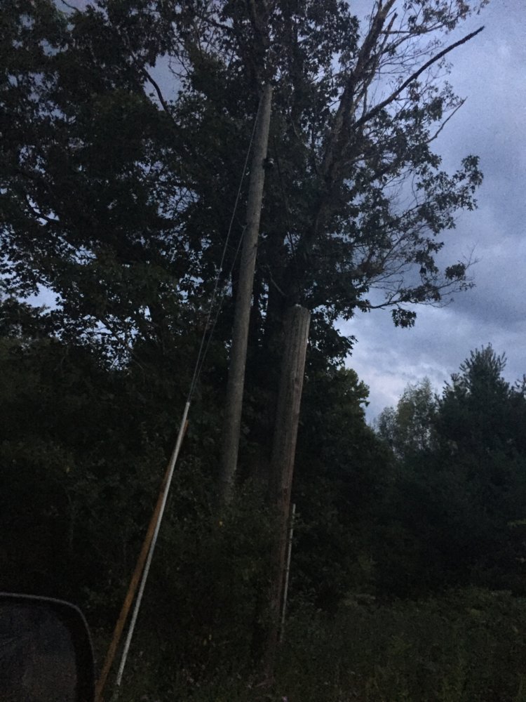

Define "electric pole"... If it's just a pole with high voltage strung to other poles? Or does it also have a transformer & meter base... because that shats gold plated and priced accordingly by AEP
Yeah has transformer pole but no meter there use to be a trailer up where my rig is but was tore down has well pump on lot also! I hope it’s not to pricey I plan to eventually have a garage up here on same lot when I get rich lol
This is what I’m working with!
No there isn’t, there is one about 100yrds On our rental property but I’m guessing that’ll do me no damn good lol
