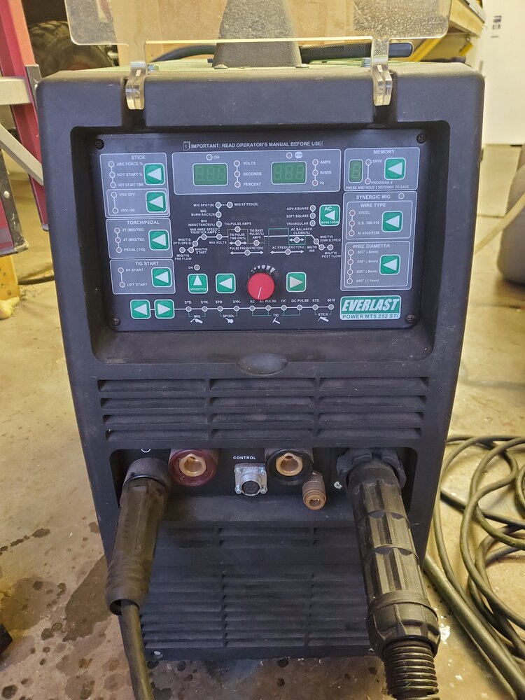

I picked this baby up off the book of faces about a month ago. Never really tig welded but have always wanted to learn. All I have to say is I really enjoy running this machine. I have watched alot of the fabricator series and weld dot com video and have been playing with aluminum coupons running their practice sets.
I’d get a good stick/tig rig and then a separate mig. A stick/tig works fantastic, but the mig part you will never be happy with. It’s easier and cheaper in the long run, in my opinion, to have 2 setups. Like said earlier, if one goes down, you still have another.
Edit: look into Kicking Horse. Cheap and pretty good.
