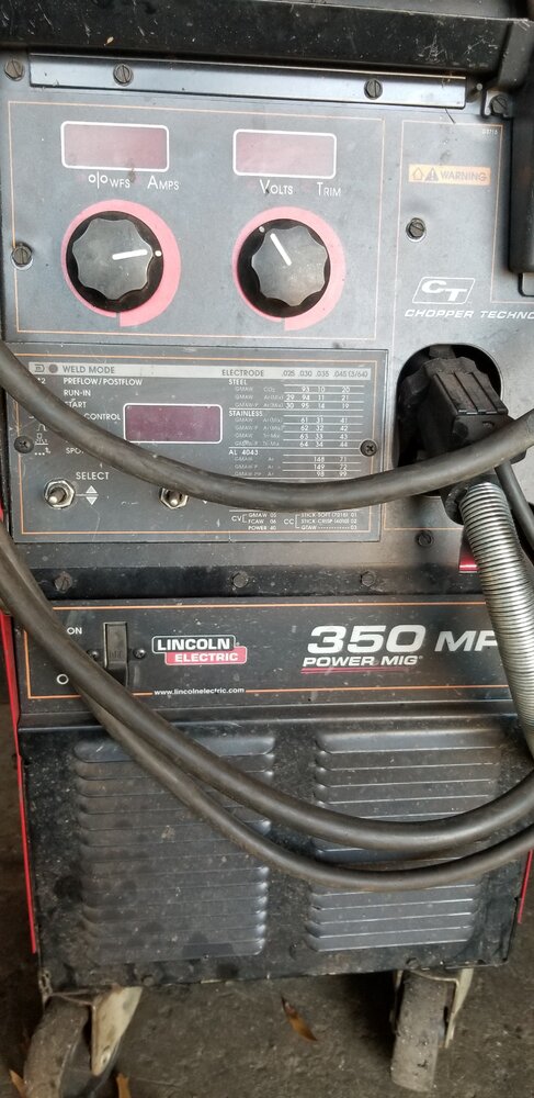

My welder is Lincoln 350MP

Having all this said, you wouldn't happen to know anything about my Llincoln 350MP specs as far as would it make a descent "starter" setup for Tig? Me looking at the "specifications for Tig" wouldn't help since I have no clue as to what I'm looking at. Thanks a bunch (never know, I might turn out to be descent at it and like it)
That machine if I’m understanding your model correctly is a power mig 350. I’ve used those for over 10 years now.
The are dc only. So you absolutely can use it for spool gun use to mig alum, and for tig welding steel and stainless. However it will not tig aluminum very well without ac output.
