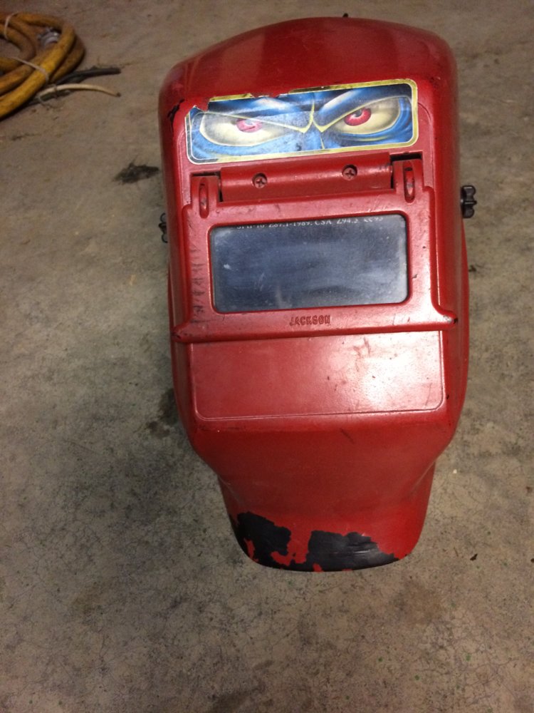

EBay, Jackson welding helmet. Around 30 bones.
I've had a couple of these. Still have one with broken headgear. Considering you can get a name brand autodark with better headgear and an adjustable lens for $30 more, the plain Jane Jackson is a hard sell.
I think you should spend the extra coin and get that one.
I have, in the 23 years of production welding on heavy equipment gone through several head gear and probably 5-6 of the welding helmets I referred too.
Tried the auto, it's awkward for me. Even in really tight spaces. Under motorgraders cutting off and welding a motor mount back in or inside a screed. The fixed lens helmet works for me.
With that said, it's all preference.. get what works for you. If your not sure, go to a buddies and try theirs. I am sure there are plenty of welders on here that will let you try one or the other.
With a $9 upgrade on the lens, it has wayyyyy better clarity and less distortion than a sub $200 auto. Glass lenses distort the weld image much less that the autos.
Batteries never die, and it always works. Cheap insurance that it’s always ready to go despite how long between welds, weeks months or years.

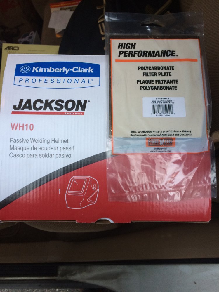

So I took the advice of the welding "regulars" and went to the welding shop and checked out the fixed shade gear. The salesman was disappointed I walked by all of the $300+ helmets :lol:
Anyways I found a jackson fixed shade with a 4"x5" viewing area. The headgear is wayyyyy better than my hobart and I plan to take care of this one and not drop it on the ground and shit like a jackass. The guy at the counter grabbed a #12 gold lense for it and an additional cover and I was out the door. I am going to do a comparison one electrode at a time with my old helmet vs new. I am anticipating improved results :popcorn:

The gold lense does good. Normal #12 lenses are too dark for mig but the gold seems to be ok. Maybe consider a #10 if it's difficult to see. I use a #10 for everything, TIG included. It's likely not the best but it's about the only way I can see.

Yeah I primarily want to stick weld with this #12 fixed gold lense. I have no complaints using my auto darken Hobart helmet for MIG welding besides the headgear being garbage.
Someone earlier mention tractor supply having gold lenses. I imagine those will be cheaper than what a welding shop carries. The 4x5 is going to kick ass.
