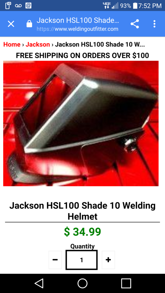

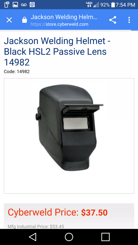

EBay, Jackson welding helmet. Around 30 bones.
I prefer the bottom one. Less glare. Good head gear. Light weight. Virtually nothing to fail. No interfering light on off. No bateries. Normally a good all around shade. Weld and grind one hood. Doesn't get scratched like a full face clear shield. Veiwing widow better protected. And best of all cheap. I got 15 plus years in one. Third head gear. Used 5 days a week. Sometimes 7:p.
