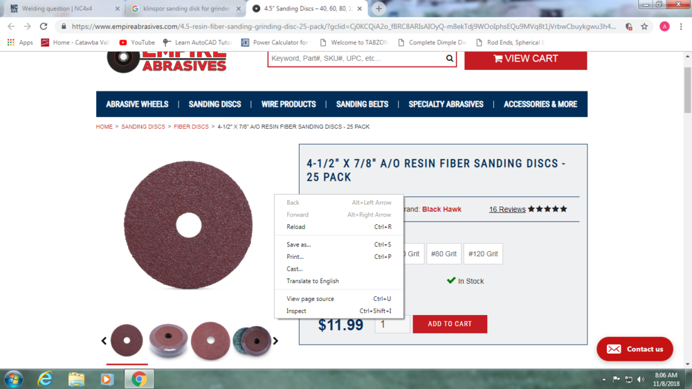

Klingspor makes this flat disk with nothing but grit on it. Sort of sand paper on a 30 something through whatever scale....I have a few intermediate grits. Doesn't load up, doesn't flex, doesn't shred like a flap wheel on hard edges. Best part doesn't gouge and leave irregular surfaces. Absolutely "tits" for mill scale and the place between grinding and mop disc finishing. Uses a hard rubber backing pad with a arbor adapter so no lame sticky pad mess either.I always surface prep with a grinding wheel. It doesn't look like you even got all of the mill scale off of that pipe.
Just like this brand.
