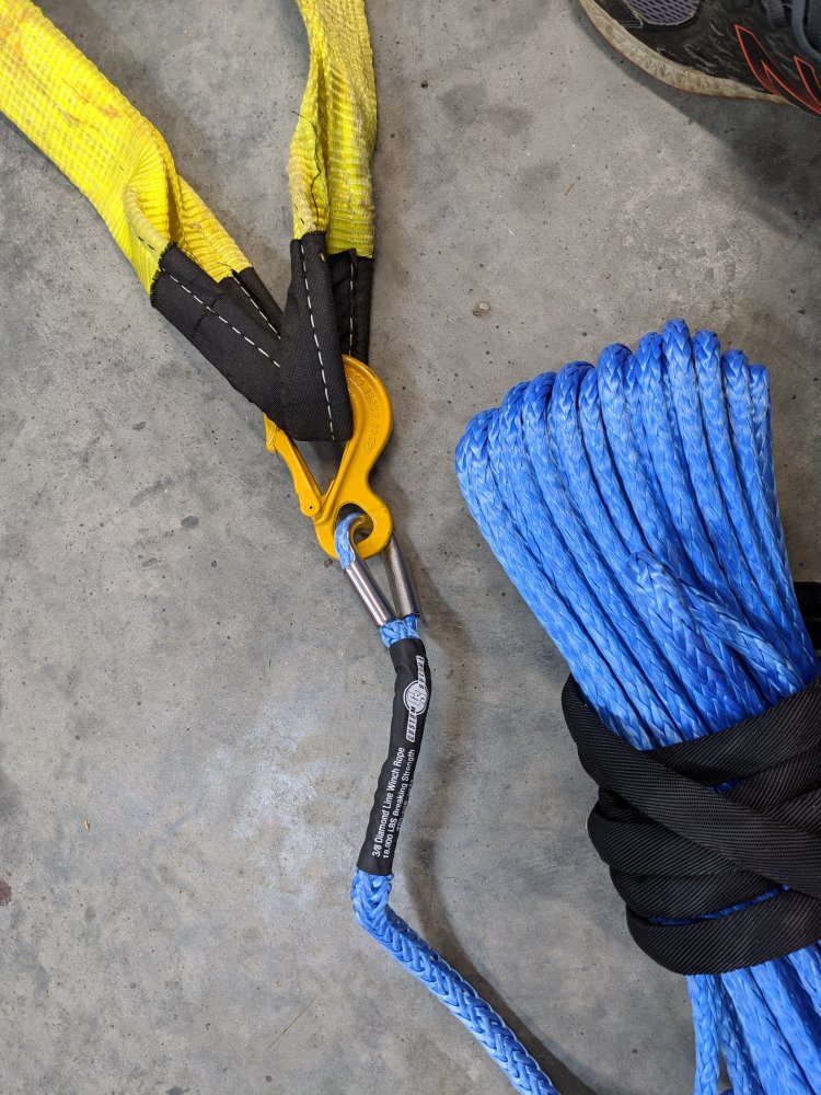

    I bought the 3/8" Diamond line stuff with hook from Custom Splice. The hook is big enough for both ends of a typical HD 3" strap.

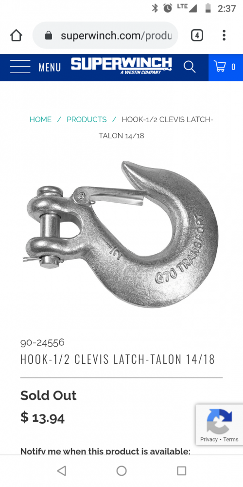

    Clay I have one of those big hooks I'm thinking of selling. It's a superwinch brand if that makes a difference. I'm going to just use a standard d-ring on the loop since I'll be using it for suck down and winching from now on.

    Get a good rigging hook and be happy.
    Shackles arent made to be used directly at the end of a thimble, unless its the Factor55 overpriced BS.
    I think mine is a Gunnebo brand, from Sweden.
    Edit : Very similar to @drkelly pictures except the hook is a safety unit.

    I think it's this one Clay.

    Thanks for the offer, that is actually the one I have right now (well except the dang cheap metal clip is broken). Just seeing if there is anything else out there I havent thought of or seen

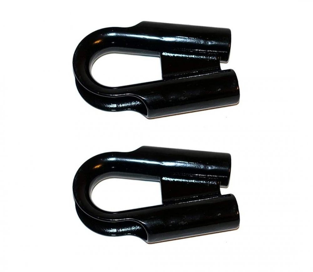

    Shackle through a hd thimble.
    I agree on most thimbles, the hd thimble's like this:
    I see no issues just running a shackle too since they have the anti-crush plate welded in the center.
    My rope has one and I just run a shackle on it, been pulled, yanked, and abused with no issues. Saves time imo so your not lookong for a shackle and takes the hool out of the recovery.

    I think I have a wrecked HD thimble like that in my "winching stuff" box. I agree, they are wayyyyy better than the non plated ones and a million times better than the non tubular ones, but you can still tweak them.
