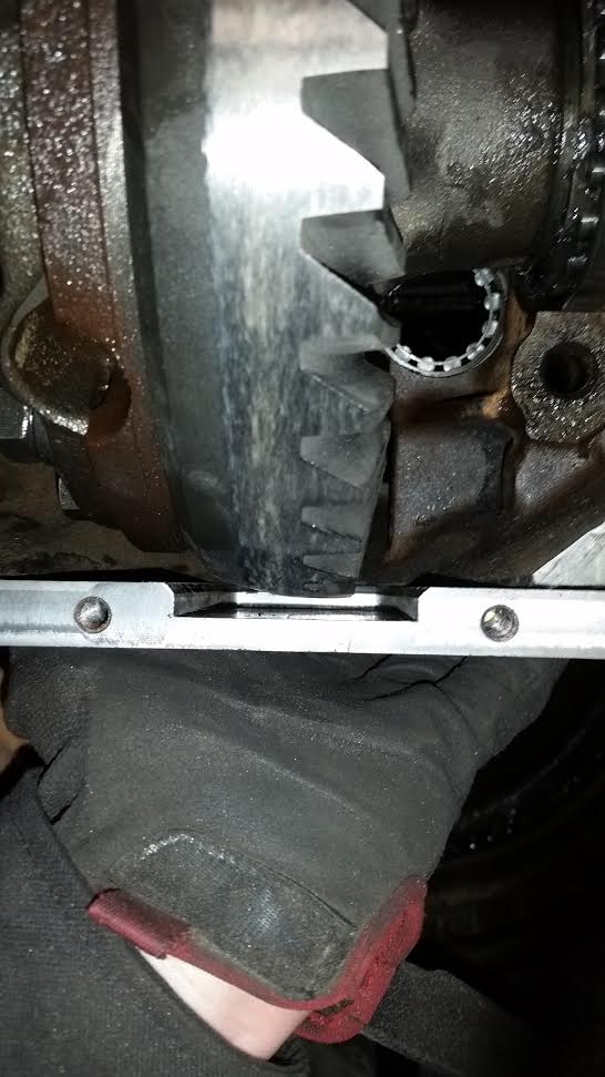

If they use the same bottom plate, what's the difference in the kits?
You can buy them with new diff covers already cut and welded. Those are cut to different heights depending on which one you want. If you already have a nice aftermarket cover, you just buy the bottom plate.
Food for thought- I used the Barnes 14 bolt cover on mine. It requires a shave of about 1.25" but no cutting into the housing cavity or welding to it. I had a time welding my axle tubes to the center section. I didn't want to mess with cutting into it.

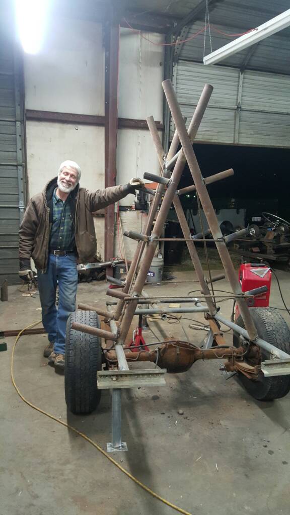

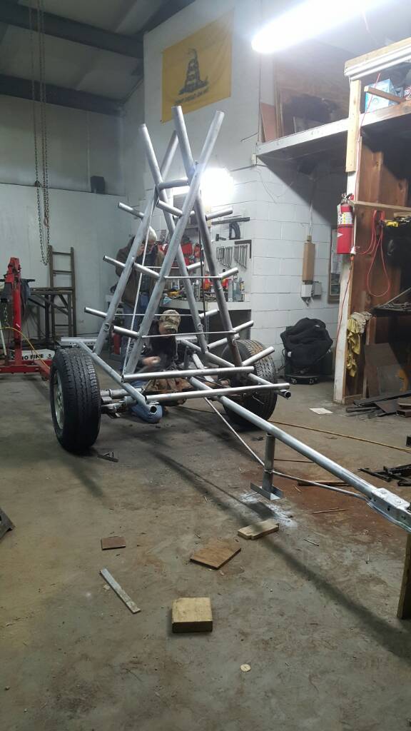

We cleaned out our spare steel rack and used all old galvanized and poop pipe to make a mobile axle storage rack/trailer.
We were tired of axles taking up shop room so decided to make something we could stored outside and roll inside to use the engine hoist to lift axles on and off.
All old pipe and rebar, all stick welded with 6011 with no cleanup, with a $75 Lincoln ac225 buzz box.
@moldman05 pictured above lol
Him and my fiance Sam painting it up using half empty leftover spray cans.
We used the axle from the s10 donor for the start and built off the leaf spring hangers I cut from the s10.

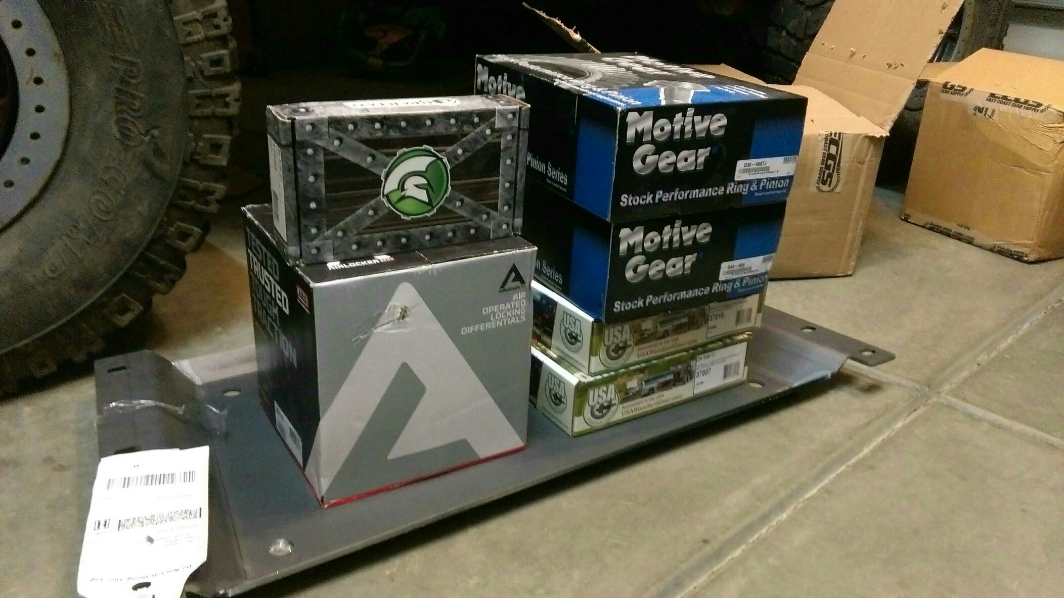

Ordered some goodies. 4.88 gears, ARB, Spartan and a Barnes skid. Headed to @MarsFab on Monday to have gears and lockers installed.
Almost finished with installing the ARB compressor
First skid plate I received looked like it had been dropped and was bent. Called @Barnes4wd Friday morning and told him it was bent on receiving. Brad said he would sent me another one and at 830am Saturday morning I had a new one on my doorstep.

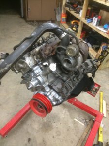

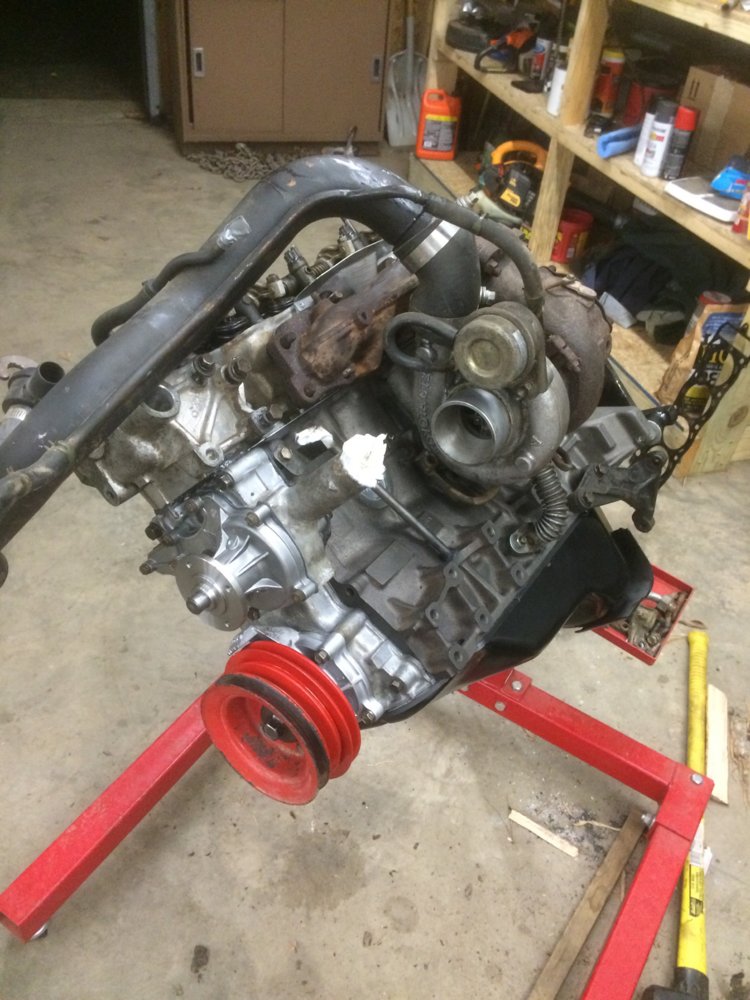

Got the engine mostly dressed out today. Looking forward to seeing how the bigger turbo works.
Good thing you had @Jody Treadway set those ring gears up. Looking forward to that first 4K rpm boosted Hartzell side step.
