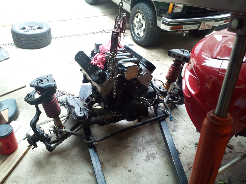

Dropping on the k-member

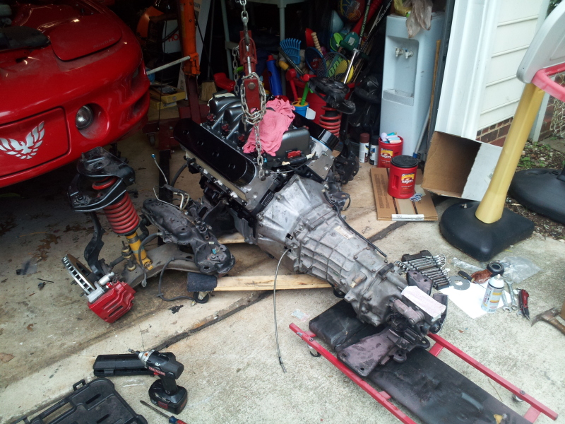

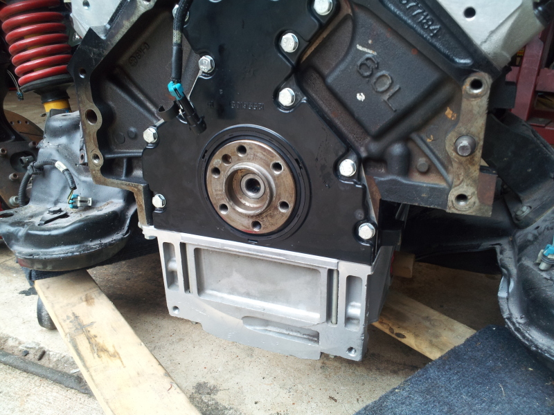

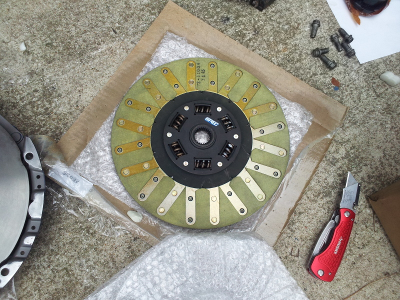

Can't forget the pilot bearing. And proof it is a 6.0L!
SPEC Stage 2 clutch

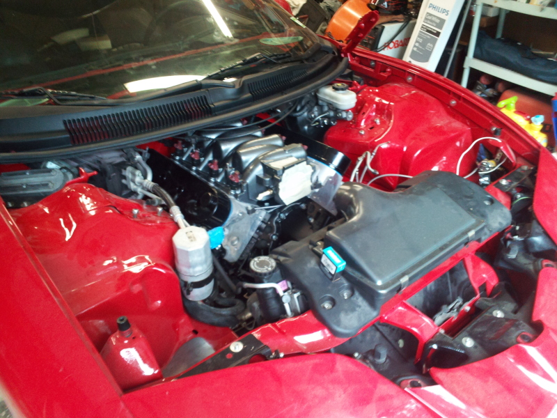

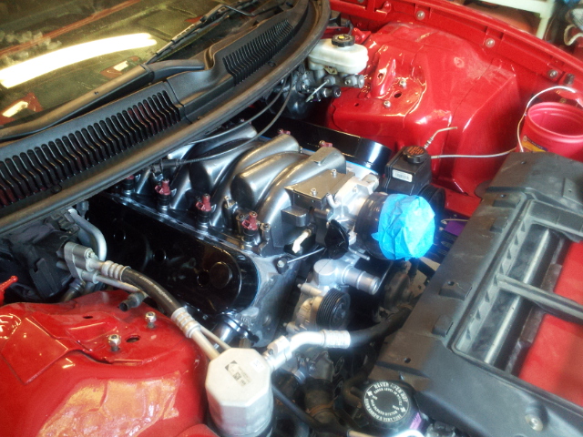

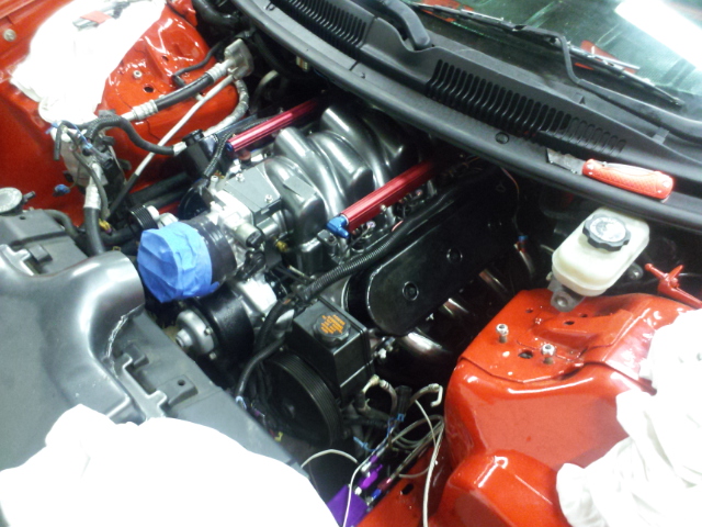

Got all the accessories mounted and the AC hooked back up. I'm having my alternator rebuilt this week and I'll get that on before the weekend. I'm going to try and get the brakes mounted and the fuel system run this week, then just need to finish my brake lines and I can think about firing this puppy up. :)
Got all the accessories and stuff mounted. Still need to get my alternator rebuilt and installed, but the rest is in.

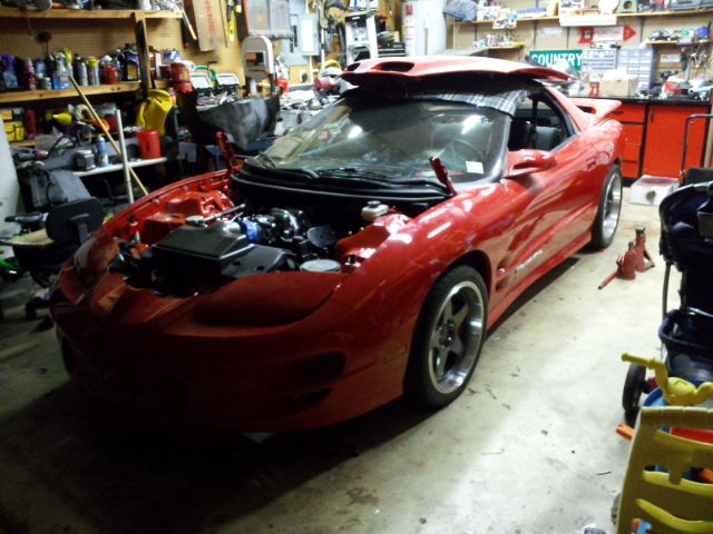

Then I dropped it down to see how it looked with the full weight in the front. I'm happy with the stance. :)
Oh, and installing this in my garage was one of the most unsafe and terrifying things I have ever done on a car. My floor jack wouldn't lift the car high enough, so I had to take two jackstands and place them under my tubular SFCs for "safety" and then jack the car up as high as it would go in the air with two bottle jacks and a bunch of blocks of wood. I could have used the floor jack for one side but I needed it to jack the drivetrain off of the dolly.
I had wheels/tires/etc stacked under the car in case it came down. :lol:
Not trying to be unsafe, but sometimes you gotta do what you gotta do.
Wheels layin down for backupwill never kick out like a jackstand. Just be sure to lay very flat if your under the thing!:eek:......I seem to remember more about the loud, red TA that I saw, summer time, window down, it pulled up beside me in the left lane and got cockblocked by a slow driver, I was in the center lane and I slowed to listen to the motor beside me approaching US1 from the west, the car went around and moved on down the road soundin sweeeeet!
I had both, but I had to put the wheels kind of far back because I had to maneuver the floor jack under there to get the transmission in. I was worried that even with them the front would plop down.
