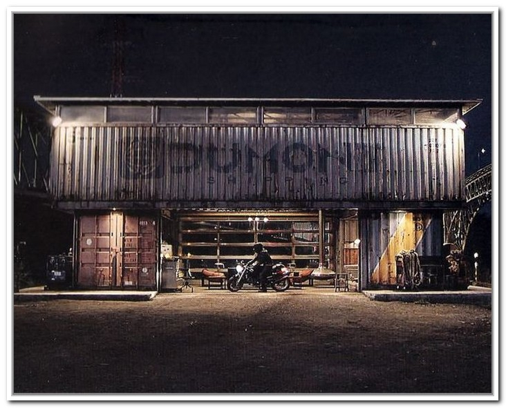

Found this picture, thought it was pretty cool. Seems like they would be best suited for exterior walls storage/work areas. What kind of size are you shooting for?
2 forty footers, with walls on the outside edges doing what those top 2 accomplish. Use the tall versions too. Regular roof like a ranch house design. Clear span between the boxes min 20 feet. So I estimate 40 by 36/40 foot print plus the back deck area.

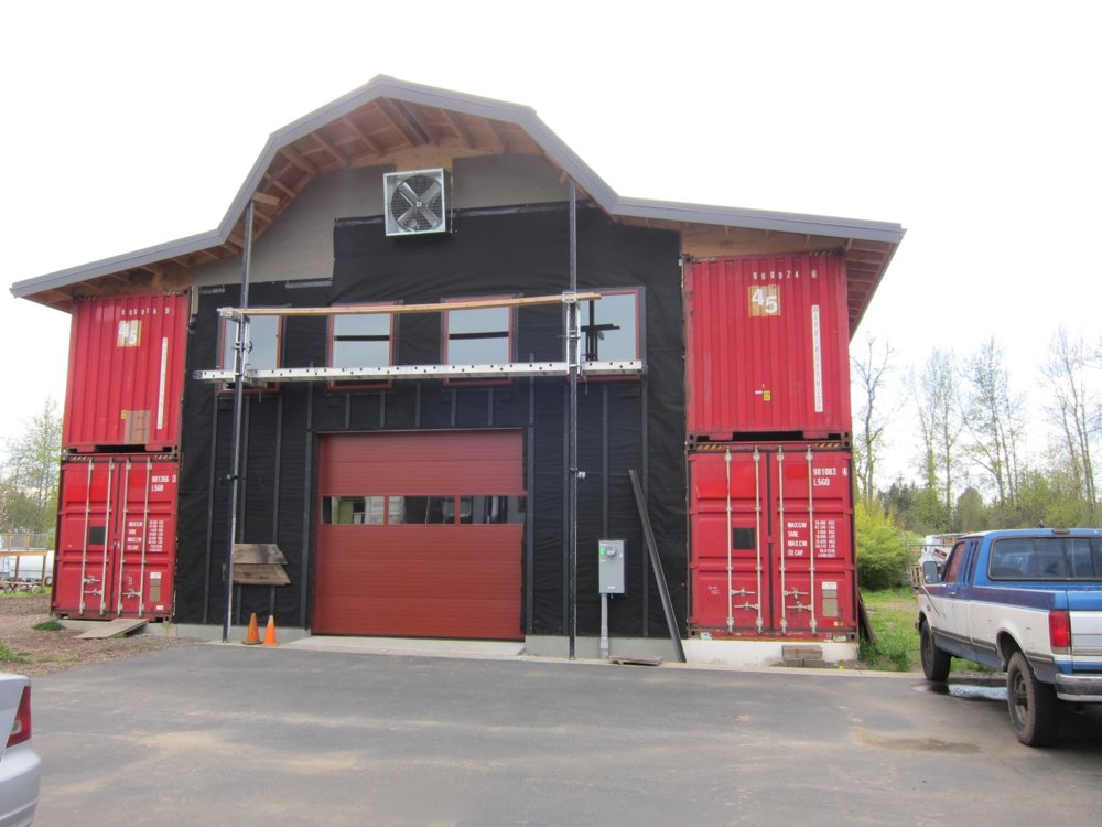

Podroof
Just saw that on the book of faces. Made me think of this thread.
Damn skippy! I like it. Now since I'm no carpenter how's this compare price wise to traditional trusses or engineered metal for the same spans??
If I read the description right (20x56), you would need 2 of their sections to get the coverage you want.....so there's $14k plus. I just bought 8 trusses ( covered 15') that span 30' with 4:12 pitch for about $1200. I think prices increased after pitch got steeper than a 6:12. Not sure how price increases with length, but I would say less than $5000 for just the trusses would cover you. You will have about 2700 square feet of roofing if you do 6:12, probably about $3500 worth of materials if you used shingles (I don't know metal prices). Maybe somebody else can help confirm my numbers....
