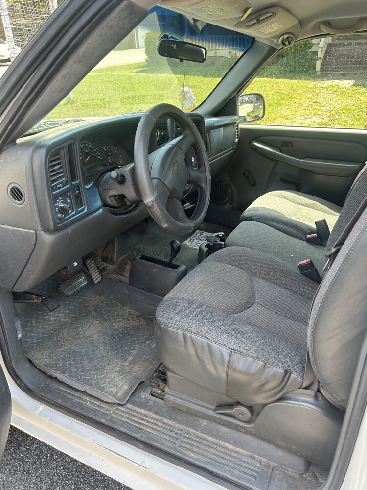

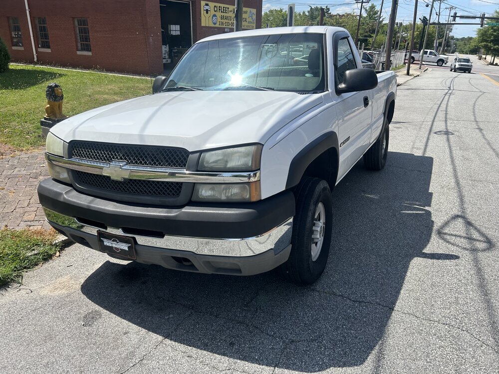

I’m about to find out myself with the pawpaw special. Definitely won’t replace my diesel. But figure nice get around and pull my single car trailer places.
