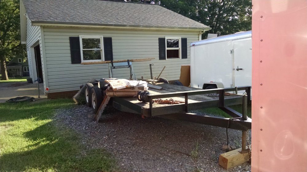

ummm...your back yard looks like the bathroom some random hot girl took her selfy in one night.
And she moved in with me to my new house.
I'm a junk man trapped in a nice neighborhood with middle class status.
And she moved in with me to my new house. View attachment 225982

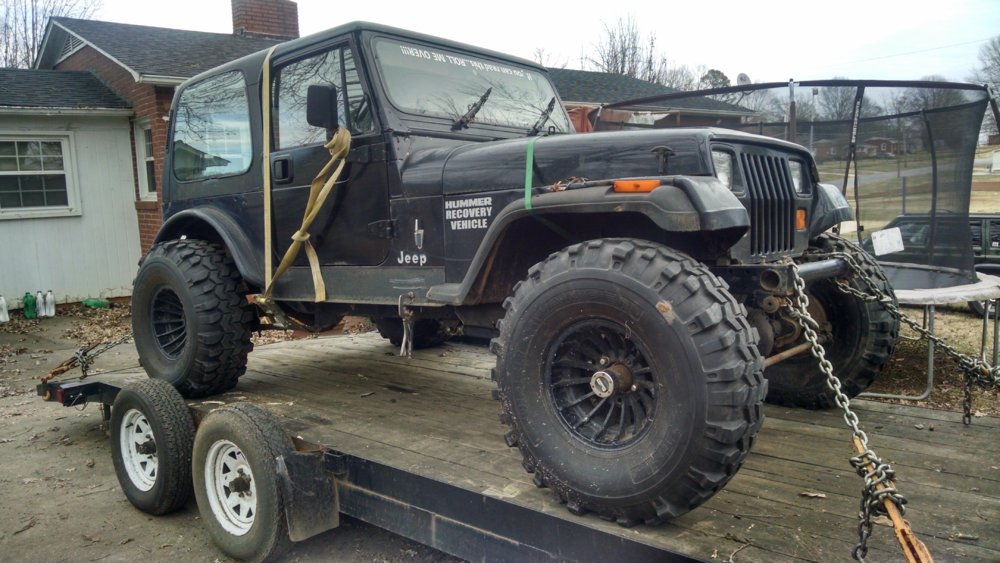

Best thing I have ever done to my yj.
I have 4.2 crank and rods and reused 4.0 Pistons.
My dad Ported the head significantly.
It cost me $125 for the crank and rods.
We had already swapped the 4.0 into my jeep and didn't keep the OG 4.2.
$350 for turning the crank, new cam bearings, put Pistons on the rods, and to do a 3 angle cleanup on the valves.
We were able to use my newish 4.0 bearings.
I used a crane cam and lifters, stock springs with a .100 shim under them.
Unplugged the FPR, and used grant Cherokee 5.2 injectors IIRC.
Way more bottom end power than a 5.3, and way cheaper.
I've broken ax-15s, Dana 300s, ford 8.8, Dana 60, np 231, well I've broken everything that's been behind it at some point or another, except for the 14 bolt.
Never complained about not having enough power.
I will hold it on the rev limiter for minutes, dump the clutch in 4low, 3rd gear, at 4500 rpms, to "bounce" it up ledges.
Only issue I had was blowing out a few free plugs early on.
The fun to investment ratio is great, plus easy as crap to do, and only as expensive as you want to make it.

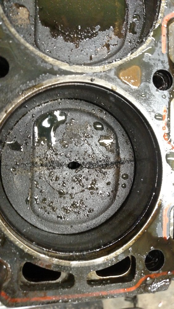

Why NOT supercharge a stock 4.0?
Here's why
