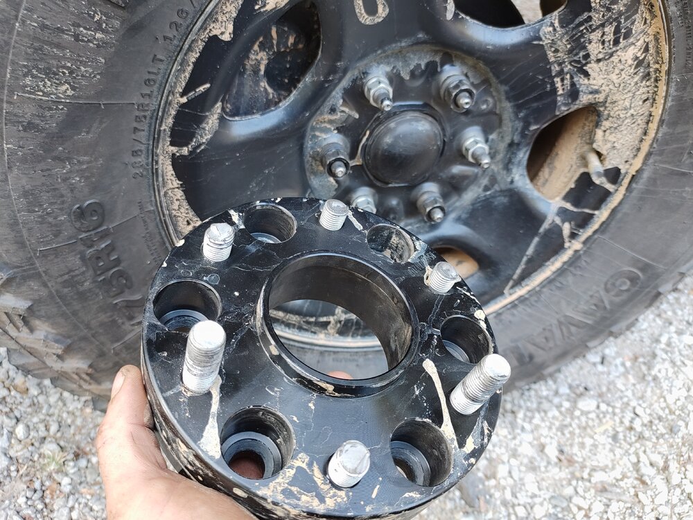

I'm gonna try to pop these out and use a factory OEM replacement in these. They're cheap Amazon hub centric.
