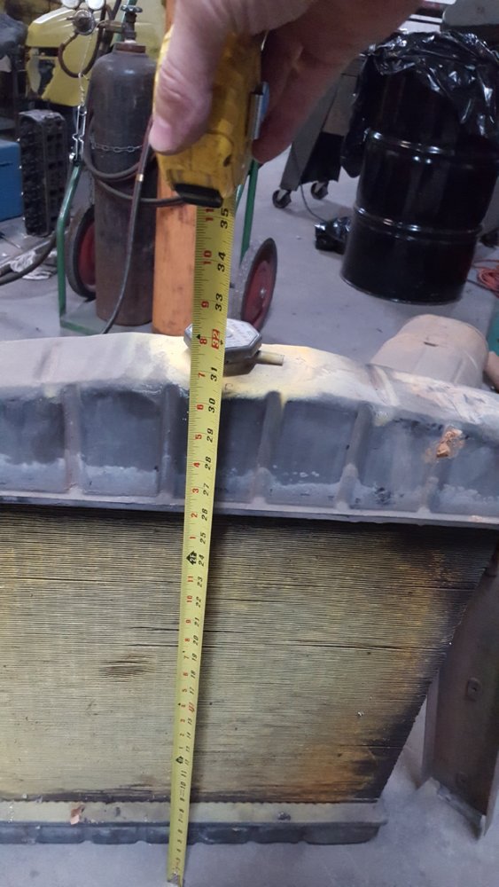

I need a radiator for my chipper, but don't want to spend hundreds of dollars. Mounting is very flexible, so I just need something similar to this:

Possibly. What are the rough dimensions and how does it mount?
I don't know for sure but Ive changed a couple and they looked similar.
Core Size: 18.00" Wide Dim B (2) 16.00" High Dim C (3) 3 Rows of Tubes Dim D (4) 7 Fins per Inch

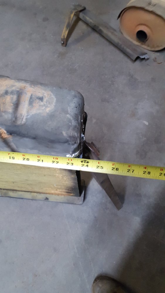

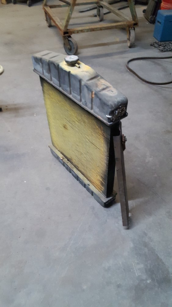

Thanks, I'll check them out. The tanks and cores are actually good, but the solder/brazed mounts have broken away. It appears to be some kind of frankenradiator. The top tank is aluminum, the bottom tank is brass, the mounting points appear to be aluminum or some type of solder, and the mounts are steel. It's probably fixable, but given the oddness of everything else, it seems more prudent to just replace the whole thing.
