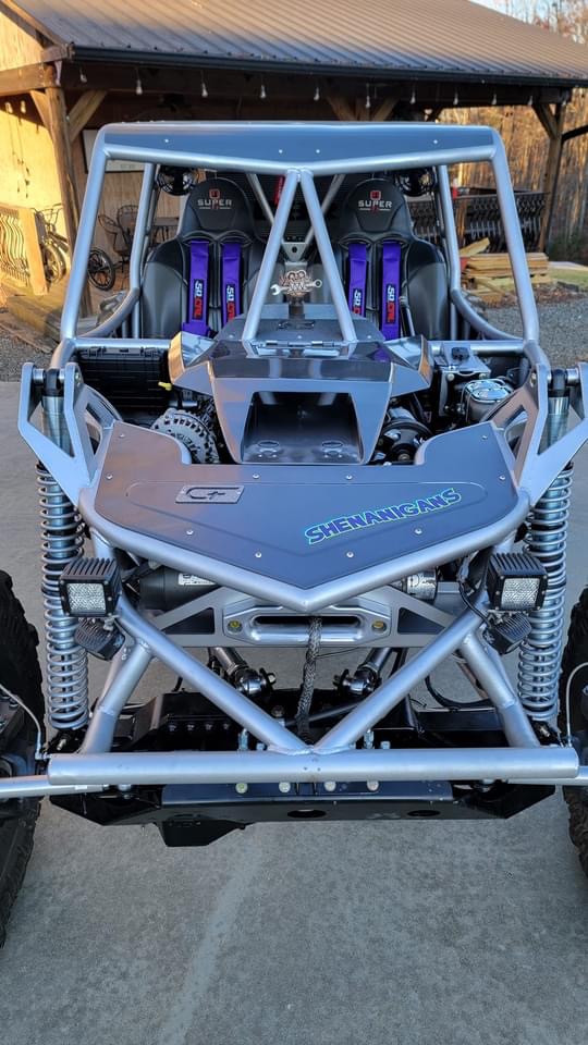

I'm starting to look at some new beadlocks for my 40" stickies I just got. I am not used to buying shiny new things so clue me in on the better choices for a classic rig that gets used. Need 17"s in 8 lug
Here's what they'll be going on

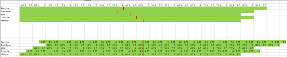

I went full Nerd a while back when investigating beadlock wheels and the different widths and mounting face offsets. I created this. The red line is the mounting surface. Top section is the wheels standing up all with their inboard surfaces lined up. The bottom section is with their mounting surfaces lined up.
