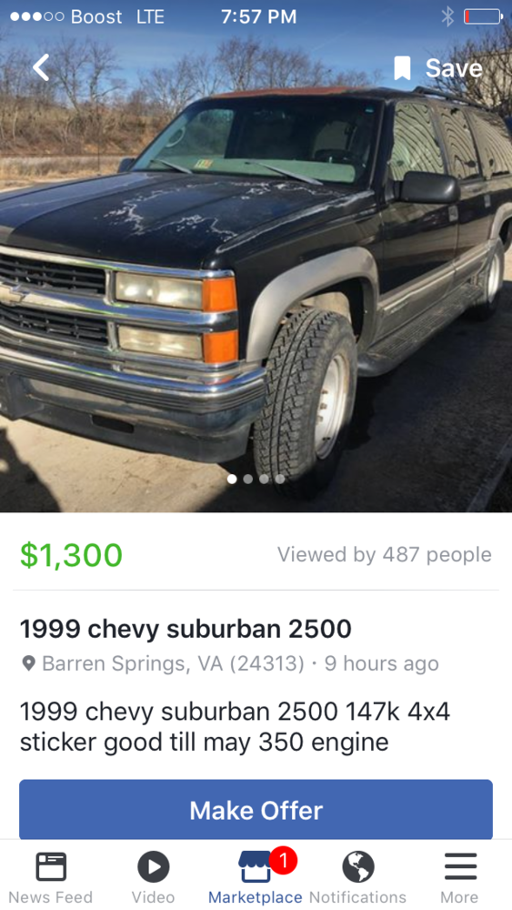

Well I bought it it ran great no leaks underneath only rust in body is the roof you can see in pic! I thought these had ff14 but it's actually a sf14!? Got it for a 1000$ I feel like I got a deal first thing to address will be intake gasket, then brakes felt a little soft but still stopped good! Anything else that is a must do on this setup to keep it going? Was gonna do trans and engine flush this week and flush both differentials tcase need flushed out or just checked? Heard the 241 is somewhat decent tcase

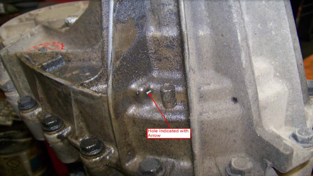

Be careful of the transfer case. The oil slinger/pun thingy can come loose after many miles and start rubbing on the inside of the case and eventually wear a small hole in it. If not careful, it can drain your oil and lock up the case. This is a fairly common issue.
It happened to me years ago while traveling out of town 5+ hours and I know of several others it has happened to. It's an easy fix if you catch it early but it requires pulling of the case and disassembly.
Only real way to check it is by pulling the case so unless you see an oil leak coming from the case housing, it's a guessing game as to whether or not it's in good shape internally.
With that many miles, I'd bed $ that it is rubbing the case but maybe hasn't worn a hole in the case yet.

Is the replacement part for tcase issue a upgrade or will it happen again after so long? This is my first push button 4x4 btw very strange not having a lever on the floor I feel like I'm cheating almost lol
There is a fix for the transfer case but depending on how involved you want to get it could be a one time thing or it may happen again. The upgrade is generally supposed to be a one time thing. If there is a home in the case, you may need to replace the back half. I used JB weld as my hole was small and the case wasn't cracked. It held for another 50k miles before I sold it.
Sweet my plan is to pull a 241 and do the upgrade then have it in the shop ready to go in if I see any issues arising! Thanks
