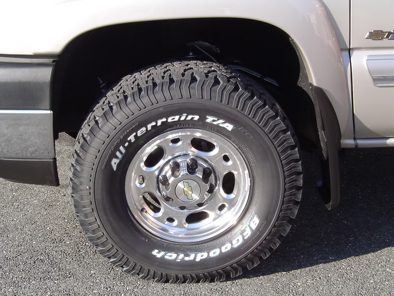

Stock wheels for 99-20xx? (2010 maybe?) Chevy 1500HD, suburban HD, 2500/HD, 3500 SRW trucks. 16" size gives lots of cheap tire options, they are super light (for a truck wheel), can be had for cheap, and look good on the older trucks.:
Those 33" bfg on that wheel?
No idea. Just a pic I grabbed off the internet. They look about the same as the 285/75r16's I had on mine, which equates to a 32.8x11.2.

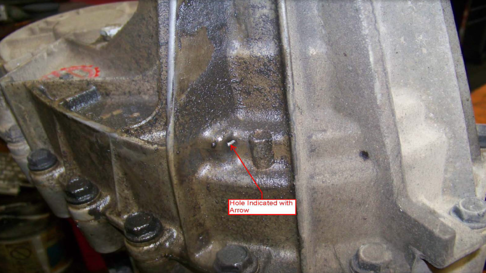

Be careful of the transfer case. The oil slinger/pun thingy can come loose after many miles and start rubbing on the inside of the case and eventually wear a small hole in it. If not careful, it can drain your oil and lock up the case. This is a fairly common issue.
It happened to me years ago while traveling out of town 5+ hours and I know of several others it has happened to. It's an easy fix if you catch it early but it requires pulling of the case and disassembly.
Only real way to check it is by pulling the case so unless you see an oil leak coming from the case housing, it's a guessing game as to whether or not it's in good shape internally.
With that many miles, I'd bed $ that it is rubbing the case but maybe hasn't worn a hole in the case yet.
