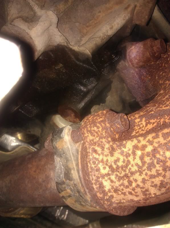

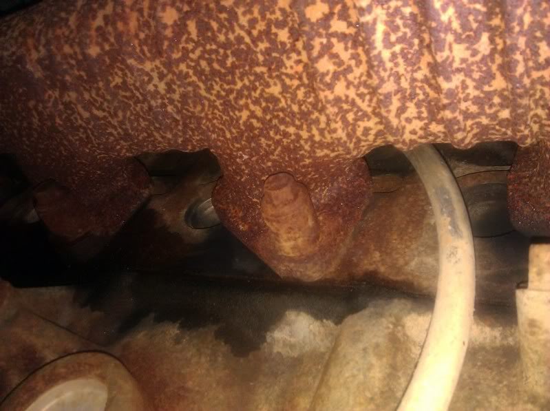

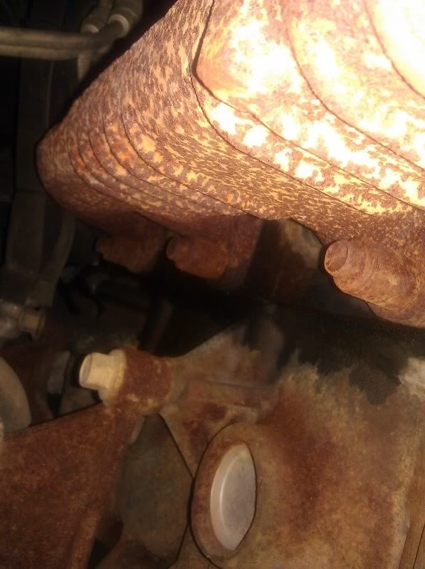

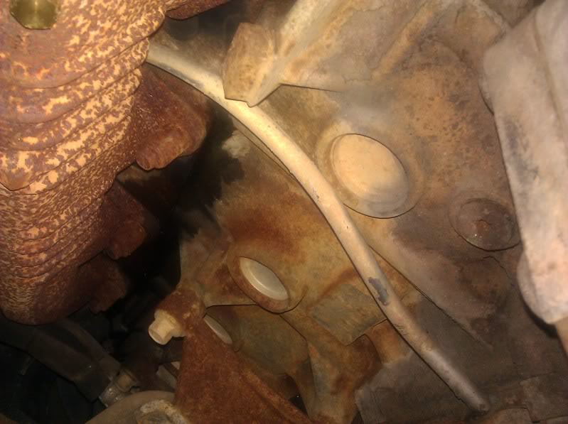

I bought a spotless 06 last year with 107k. Had all service records and seemed to be one of the good ones. Well, here's a copy/paste from last weekend:
So I'm selling the Edge tuner to help finance the EGR delete and new SCT tuner for the Ford. I crawled under there to remove the EGT probe from the driver's manifold and found bad news:
Option A:
Pull the cab, spend ~$2000 and fix it myself in half the time.
Option B:
Leave the cab on and spend ~$2000 and fix it myself while cussing the whole time because there's no room to work. Oh yeah, in 3x the time.
Option C:
Pay someone ~$3500-$4000 to fix it however they see fit. Who cares about their time.
Option D:
Save yourself some misery and buy something else unless it's been ARP'd and bulletproofed.
I went with D. It feels good to have nothing but Toyotas in my driveway again.
