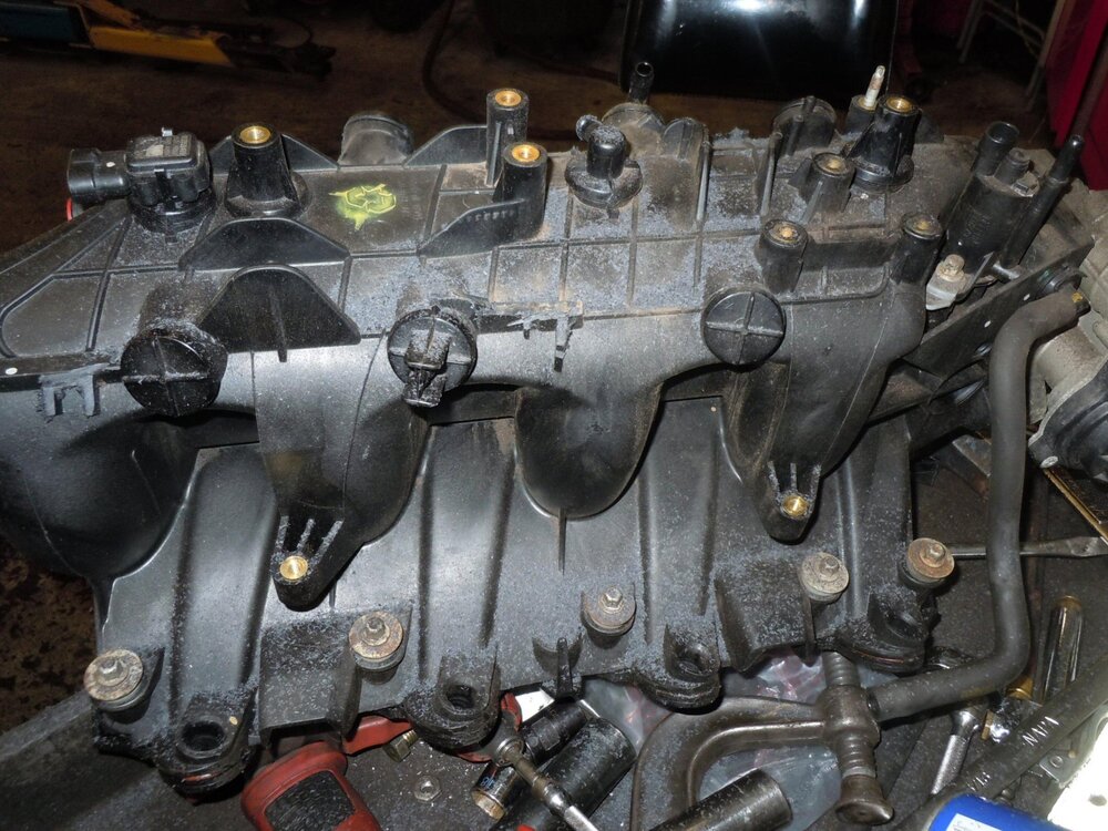

If its a truck intake, you can drill and tap it to ¼npt. These are the only intakes I've ran on 5swaps so can't help if its a car intake hope that helps

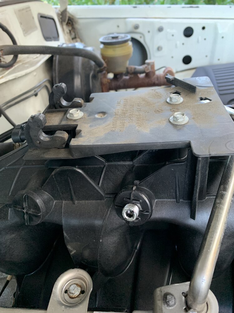

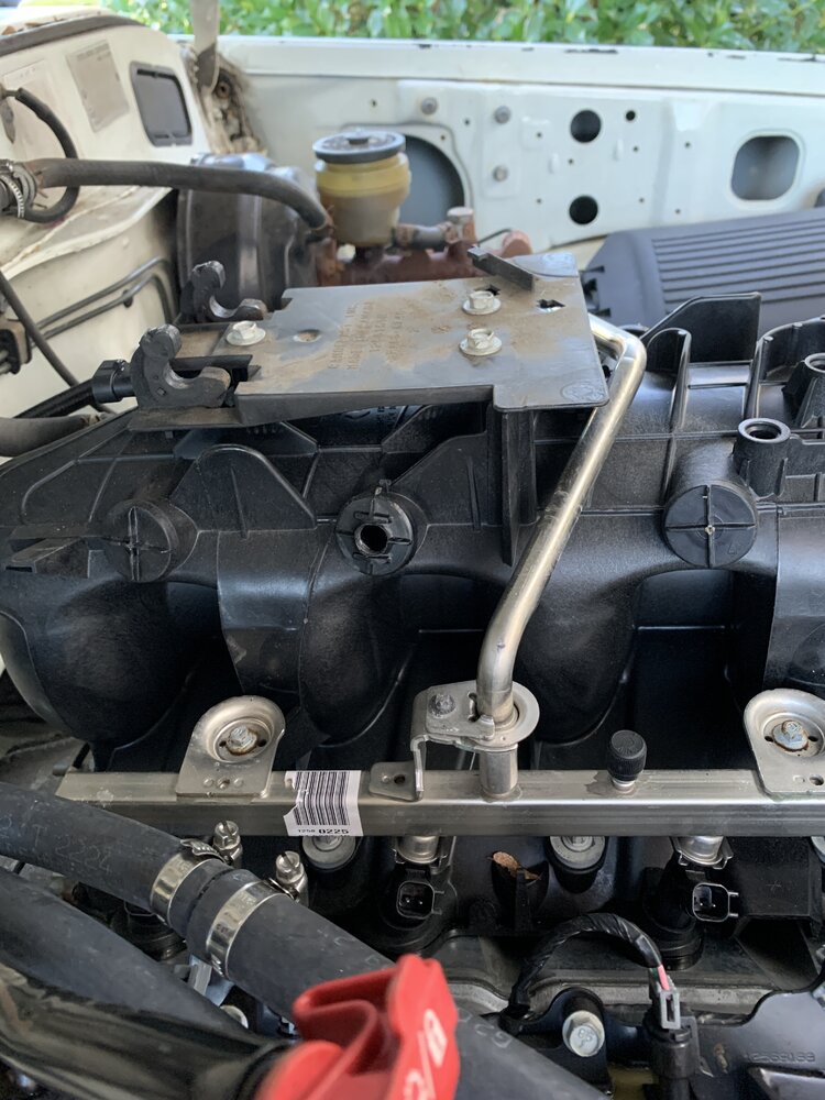

You talking about that one?

For the best results, I'd post a picture of what you're dealing with.
I'd be willing to bet it's not factory. The cheap asses at GM would have put a plastic plug in it. Steel costs too much 🤣

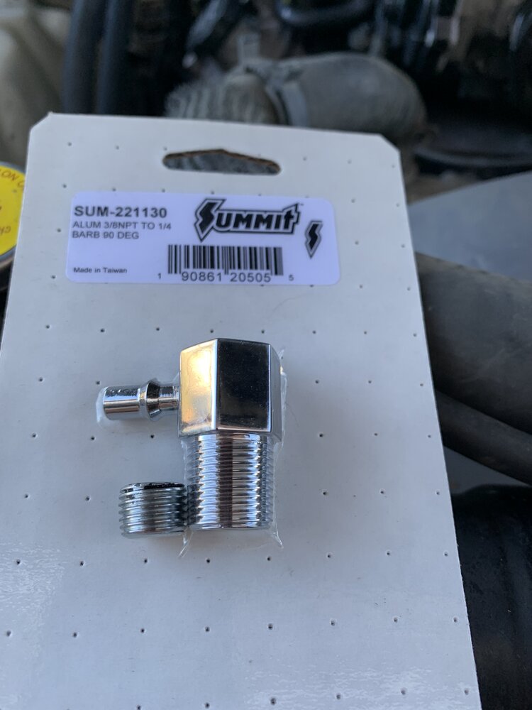

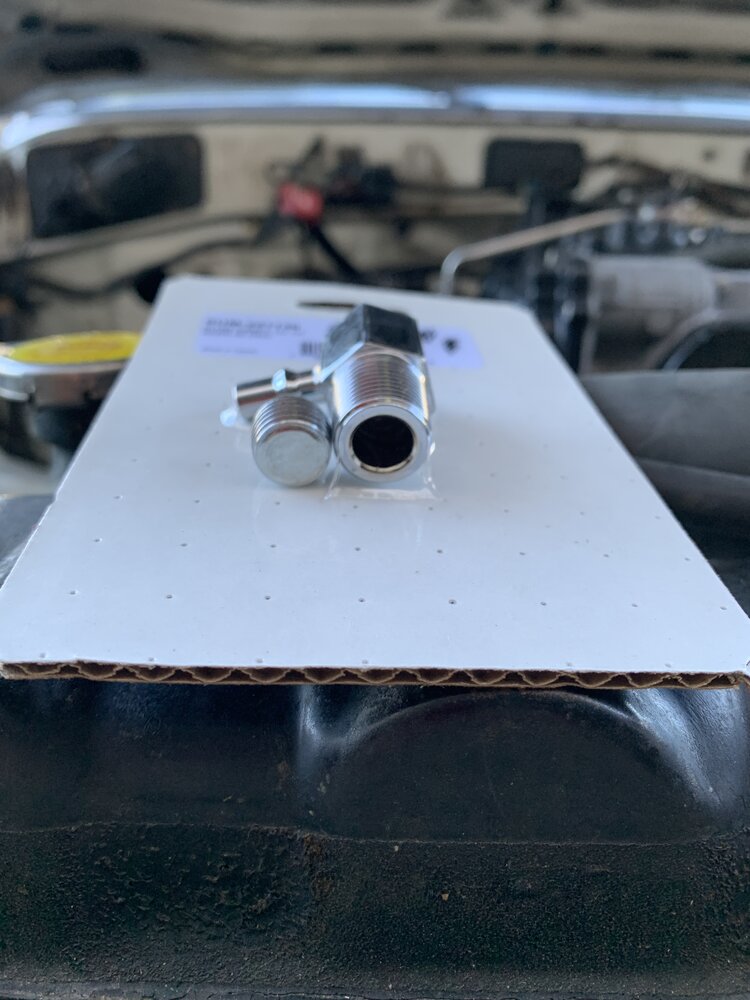

However, just pull the plug out and match the threads. It's very likely an NPT thread, which is tapered. If ¼ is too small and ⅜ is too big, assuming you checked with straight threads, it's probably ⅛-27 NPT. That uses a 21/64 tap drill, which is .328".
Damn, I'm good :D
